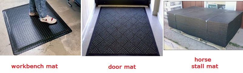

  • Not exactly sure what you mean by "rubber" flooring = 1) industrial mats for standing at a workbench, 2) stall mats for horses, or 3) commercial-type rubber/carpet combo entrance mats?
    common rubber mats.jpg (79.13 KiB) Viewed 3128 times
    types of rubber matting I considered for use in my TTT
  • 1) industrial mats are very comfortable to stand on, but usually have sloping edges, so many put together for a "seamless" surface will have valleys between them, and are expensive
  • 2) stall mats are very heavy, but washable, plus they usually have a persistent rubber smell for a long time
  • 3) entrance mats are light, don't smell, and are easily removable for cleaning, plus some have a top carpet-like surface

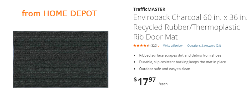

  • I chose a charcoal-colored mat from Home Depot to use as my floor covering in my 4'x 8' TTT. I wanted the uninsulated 3/4" thick plywood to be covered, though fully waterproofed with polyurethane, to deter wear, to give some insulation, to be removable/cleanable, and to simulate normal carpetings' "feel". Plus, it was made for indoors more so than the other two mat types I looked at. The one I bought was 3'x 5', so I pieced two together, to fully cover my 46.5"x 75.25" cabin interior floor, with the piece between the doors secured by aluminum thresholds under the doors.
  • 105587 easy to load cargo on carpet/rubber mat;E-track & tie-downs secure loads
  • I've removed them for cleaning (and once to dry out, after a door was left cracked open during a monsoon), and they fit back in , nicely. Since my mattresses (2) cover most (75"x 39") of the floor, only a little of the mats show when in camp, but I fold back the mattresses to create a cargo bay between the doors to transport extra gear to camp, so the durable carpet top on the mat makes sliding-in the heavy gear much easier. Home Depot now offers mats in 4'x 8' size, though I haven't seen them, but that would've fit my trailer better, without mods.
    my mat.PNG (148.44 KiB) Viewed 3128 times
    I like this very durable mat (I use others in/around my house, also)

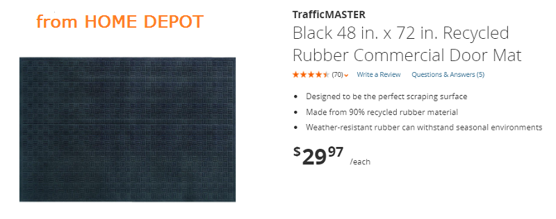

    recycled 4x8 rubber mat.PNG (166.67 KiB) Viewed 3128 times
    a new mat offering; might be perfect for a 4x8 trailer?

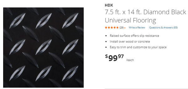

Alot are also using a vinyl treadplate looking material like this http://www.homedepot.com/p/HDX-7-5-ft-x ... /205442047.

m.colley wrote:Alot are also using a vinyl treadplate looking material like this http://www.homedepot.com/p/HDX-7-5-ft-x ... /205442047.
Martin
Thanks, this is what I was looking for. Should work perfect.

I used the diamond plate flooring from Home Depot as well. http://www.homedepot.com/p/HDX-7-5-ft-x ... /205442047 It works great and you cant beat the price. 2 yrs and it still looks great. Thumbs up. Just remember that defects in the plywood will transmit to the flooring, so fix those with bondo etc., or you will see them.

...but you said "rubber flooring"...vinyl is a whole 'nother animal...concerning which, I only have experience with stick-on squares (which is why I switched over to the rubber-backed matting, and re-poly'd the cabin floor where I peeled them up (another test marked "fail"). These look more durable, though, and definitely more expensive (why I didn't consider them during my initial, low $$ build phase). But, the diamond tread would've added an "industrial" look, which I like. A good choice!
diamond tread vinyl flooring.PNG (123.93 KiB) Viewed 2939 times
industrial look, black, washable, durable...sounds good to go

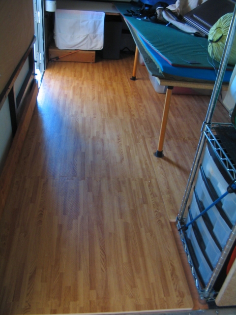

I used 5/8" thick interlocking foam tiles. Looks great and easy clean-up.

That does look great.
