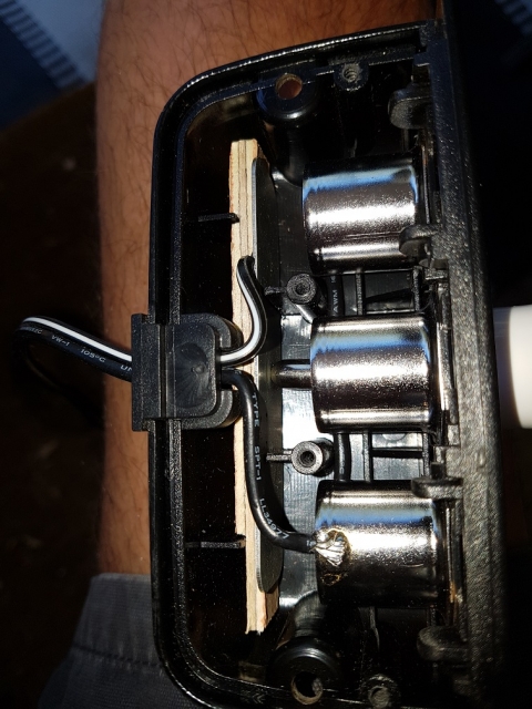

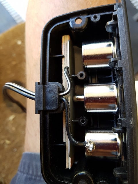

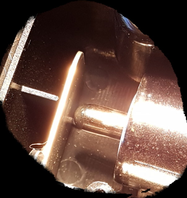

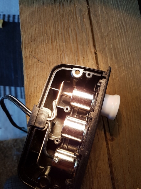

Postby CoventryKid » Sun Sep 03, 2017 3:24 pm
It is amazing what you think about as you fall asleep!
All of a sudden, I wondered if......the phone charger was NOT making GROUND contact?
So this morning I confirmed that indeed, GROUND was not being made.
A little bit of work and a small piece of 1/4" ply...
and now it works, and so does the fridge plug!
Thanks again McCubberley and McDave!

Postby McDave » Sun Sep 03, 2017 8:00 pm
I love everything about that. 'cept fer one thing. I can't shake this feeling that the "Center post" is usually the hot or + and the outer socket is ground or - neg. I could be wrong, but my gut says I'm right. It may not matter most of the time, but some electronics don't like reversed polarity. Might want to look into that.
Just a little something to keep you awake tonight. There's no rest for the wicked, you know. ... ;) ...
