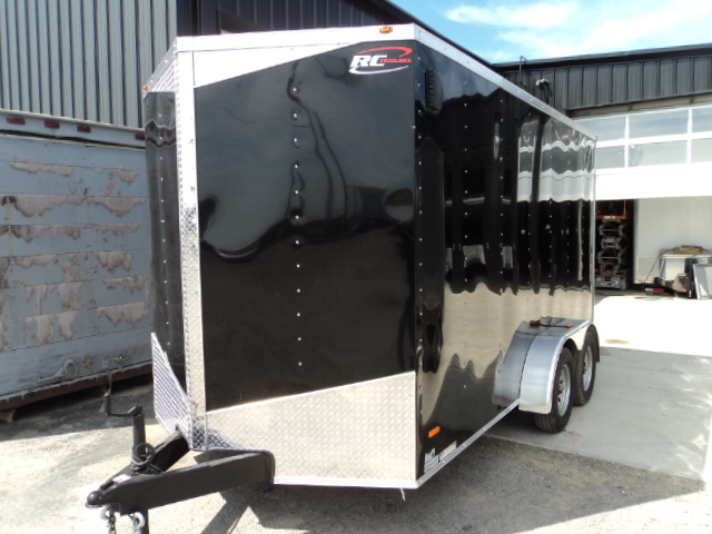

In my search and ideas for a trailer one of the things is extra height. Despite being 5'9' I like the idea of a 7'ht so for instance I was looking at this 7x14 or either 16' with 1' of extra height for a total of 7'.
Being that many insulate the walls and ceiling I would like to do the floor as well. Many take up the floor boards and insulate between the floor rails then recover and then have to cover the insulation from the under side. I was thinking with a 7' ht you could keep the existing floor intact and build on top of that using 2x4's on their side so 3.5" height, insulate between those and also have a place to run pvc draining and water supply along the edge of the trailer. In the area of the side door I would more than likely leave the area the width of the door and about 15" inward the normal height, cover that area with a rubber flooring then wood flooring inside the rest.
Thoughts?
pic of a trailer I have in mind

The extra 1' height is a great idea. That is something you cannot do later. It does make a huge difference on the interior feel when you there. Insulation is another must do and cannot be done well after the build.
That is a nice looking trailer!! I like it. I don't know much about the brand, but do your homework to make sure the build quality is what you expect.

If your tow vehicle can handle it and if the added wind deflection will not be a concern to you, I say go for it. You and I are about the same height. My six foot finished interior is very adequate for me. And I have lots of (6 inches in spots) ceiling insulation. But I have a flat front and I can certainly tell it while doing 60 mph or more. My truck power is plenty, but my gas mileage goes into the tank.
