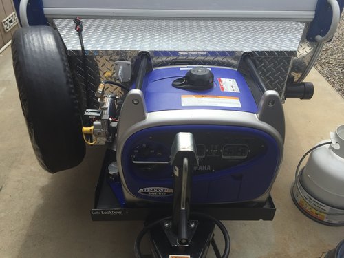

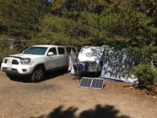

Dual batteries, portable solar, 2400w Yamaha converted to run on propane.
Can't always count on sunshine in the woods. Sometimes too hot in desert. Sometimes generator hours are limited in campgrounds. I camp to enjoy myself and relax, not to suffer but I don't like to interfere with other's enjoyment either. Mine is same dB as Honda, no fumes because of propane , mounted securely on the tongue for antitheft and can not hear it inside.
My 80w panel is not enough, but I got such a deal that I live with it's limitations. I installed a battery switch so I can charge one with the solar while the other is on the generator so I don't have to run more than an hour a day - unless we need the Air Conditioner.

[quote="Bill n Robi"]Dual batteries, portable solar, 2400w Yamaha converted to run on propane.
May I ask where you got your conversion kit? Thanks

Rainier70 wrote:
Bill n Robi wrote:Dual batteries, portable solar, 2400w Yamaha converted to run on propane.
https://www.motorsnorkel.com/
I actually looked into them to buy a kit, found out it was cheaper to buy the generator from them, already converted, than to buy just the generator local. The best part is the mixture control. All generators sold in the US are preset jets to sealevel by order of the EPA. When you get up in altitude, gas is not efficient and doesn't burn clean. The output from propane is water and CO2 and no smell. Also maintenance is almost eliminated. No cleaning out old gas or getting sour fuel... You can still run it on gas if you need to. Propane is not as efficient as gas, approx. 4.5 propane to 5 of gas but so far we have had no issues.
Get on their mailing list and you will get discounts...
