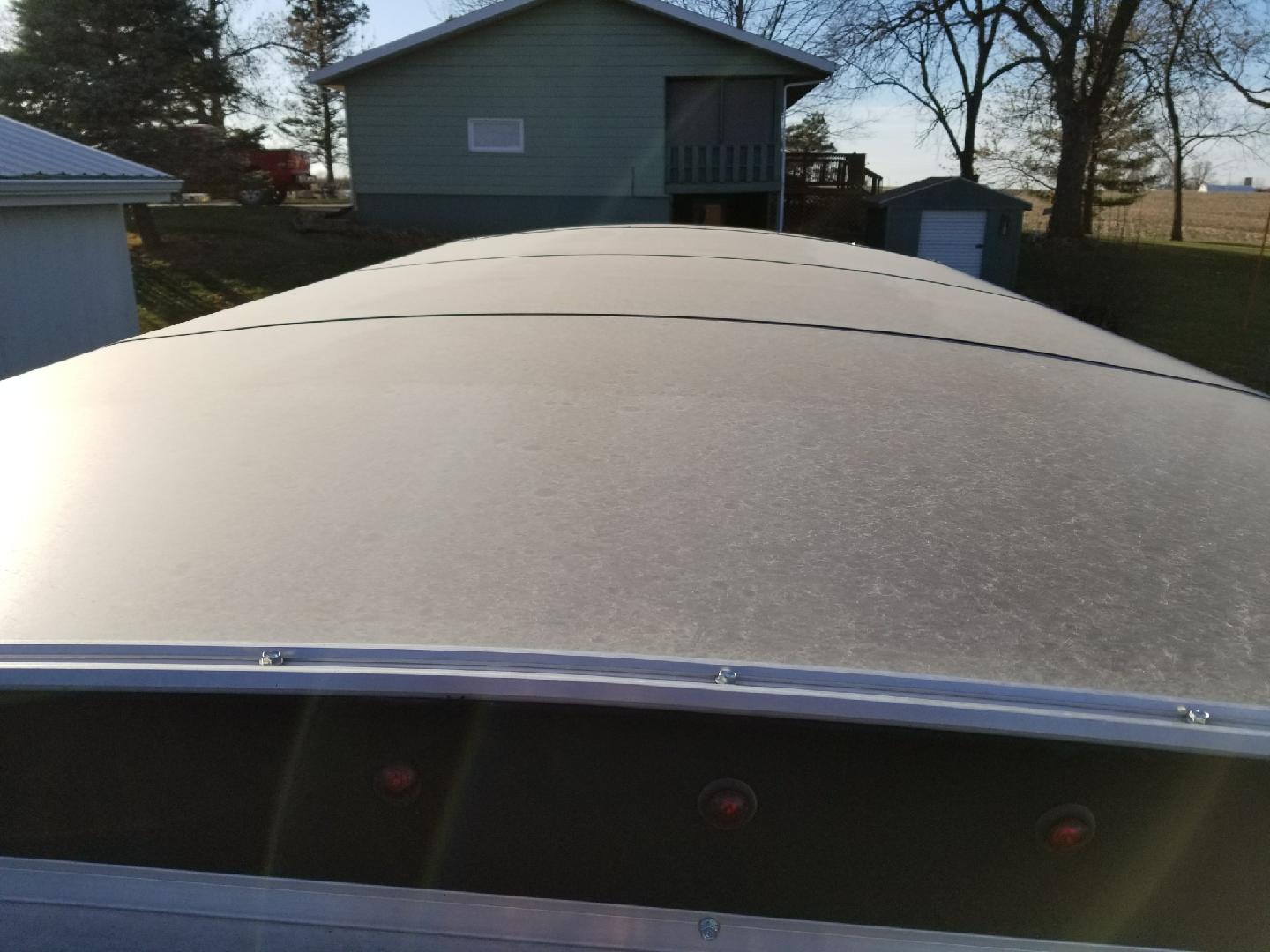

I found a H&H trailer with the rounded curved one piece roof I like.. They are asking $3200.
I think its worth closer to $2000 ?
I don't like how the industry isnt using this type of roof any more..

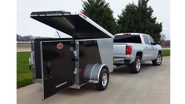

Take a look at Sundowner's Mini-go Trailer: http://www.sundownertrailer.com/tlr-MiniGO.html
Sounds like I'm promoting these guys. I'm not but they do make quality trailers. Two possible negatives - 1) they are make in Oklahoma and have limited distribution, and 2) you pay for the quality.

Yes they do.. But the roof's Not radius'ed.. Only the extruded corner. The roofs a flat piece of aluminum which doesn't wrap over the side walls. No advantage over flat top's other than the round look. Their design is like my 24' featherlite was, where the caulked seam was a little lower than the roof creating a gutter low spot where standing puddles had the chance of leaking more than the curved roof in my first post. I chased leaks in that featherlite until I sold it.
Just to clarify. Even the round roof I posted has seams every 4'.. Difficult to get away from that. But the seams are located in places that have pitch and drain well. Second, the lapped seams lay flat and tight to each other with a truss under each, reducing the need for gobs of sealant similar to side walls.
Sundowners are top of the line trailers. As well as featherlite. I just disagree with their approach because water runs down hill.

The roof pic in my first post could be done with 4' rolling machine I believe. https://www.youtube.com/watch?v=oB0F_9KvC24
It would take a few test pieces, but after that it wouldn't be to bad.
