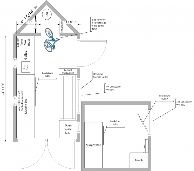

Postby sodatrain » Fri Dec 29, 2017 4:20 pm
I've made a few drawings and think I'm dialing in my design so I started making a digital version - sticking with Visio! It's pretty precice but not exact. Need to validate the bed measurements more. It's a 2' thick by 5' high by 7' long box so far (Queen bed)
I'd love your feedback!
Key design considerations:
1) I want a place to store my mountain bike (Inbetween bed and bench when I'm on the road, hanging near the front, perhaps, when I'm using the bed or bench.
2) It will mostly be me but I want to accommodate my kids for periods of time - thus the fold-down bunk. One queen murphy bed (on its side) and one bunk. Details on bunk TBD.
3) Potential for lots of light - thus the 3x4 concessions window. Figure it's a bit stealthier than lots of windows
4) Want to be comfortable - standing and sitting. I'm 6'6". 7' interior trailer. Bench with a fold-down table on the underside of the murphy bed.
5) keep it simple where possible. Planning on a water jug over a bowl for a sink. maybe a little fancier with a sink with a pump.
THANK YOU IN ADVANCE!! :thumbsup: :beer:
