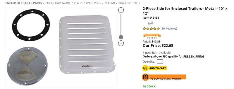

  • I also didn't want to put a fan on my roof, even though it already had a dozen 1/4" holes in it. I used stainless carriage bolts with acorn nuts/fender washers, for metal brackets securing the roof to the walls, in lieu of spars, sealed with PL adhesive, and painted-over with clear acrylic for further protection. But, I had no desire to cut a 14"x 14" hole for a rooftop fan/vent, inviting eventual leaks, so I decided on sidewall vents (with attached fans) for flow-thru venting, and a large under-shelf fan for maximum air circulation.
  • Having run a shipping/receiving department for many years, I was familiar with vents used on the enclosed trailers of the trucks I loaded/unloaded at work, and that never leaked, as far as I could tell. I liked the look of a particular vent, designed for trailer roofs, but usually mounted on the leading wall of most trailers I saw. I found it at E-trailer, for under $20. It was galvanized (grey-ish color), which was ideal to match my grey color scheme, and the overall rough/industrial theme.
    9139 vent.JPG (58.46 KiB) Viewed 3059 times
    my vent(s) were galvanized; now they come painted white

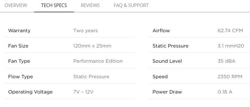

  • It was an easy install, and I put plastic screening between the butterfly closure and the wall, to keep out insects. But, I was not finished with them, yet. I added a swing-away bracket (piano hinge) to mount 120 mm hi-flow computer case fans for added circulation (if I wasn't using the 10-inch 120vac main fan). They are 12vdc, and use .18 amp-hour each, so I can use them for many hours, without much impact on the battery life, if off-grid.
    Corsair SP-120 fan specs.jpg (50.59 KiB) Viewed 3059 times

working on it wrote: They are 12vdc, and use .18 amp-hour each
Do you mean they use .18 of an amp while running? .18AH per hour, 4.3AH per 24 hours would mean the same thing, just want to clarify.
John61CT
Posts: 1958
Re: Sidewall Fan???
Postby working on it » Thu Dec 28, 2017 10:06 pm
Yep; they're very efficient. I've left them (2) running continuously for a weekend without noticeably sapping my battery., but I usually just leave them off, swung-away from the vents, and using my ac-powered fan, or the air conditioner (closing one vent, and the other just barely open, to allow some outside air in). They just aren't powerful enough for the Texas heat in spring and summer, usually, but are there mainly for cool night usage, if I close my awning windows.
