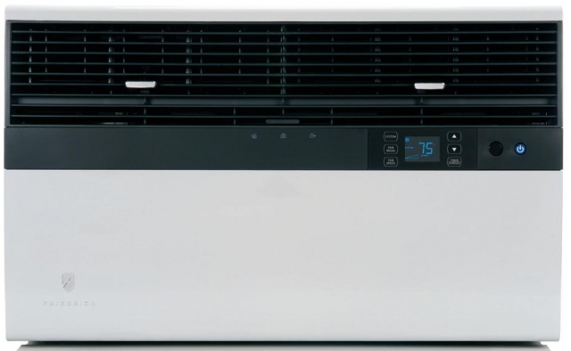

Postby onlyridepark » Wed Jan 17, 2018 3:21 pm
decided to go with a window unit with heat. 8000btu with 4000btu heat. went with the 8000btu since i found it on sale cheaper than the comparable 5000btu without heat.
Friedrich Kuhl 8000BTU. 6.1 amps using the AC, and i think around 10 amp on heat so I'll more than likely be getting a portable propane heater.
