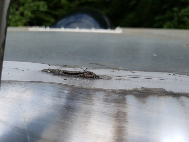

Last summer, when I was cleaning my skylights I noticed quite a few of these in the caulking on my Neo NAVR's roof:

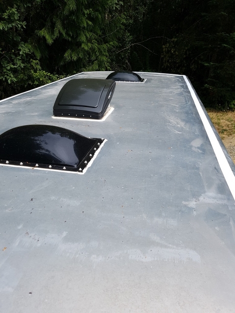

I ordered some Eternabond tape from Amazon, scraped and cleaned all the "eruptions" and stuck down the Eternabond tape:
Rainy season is upon us now, but no leaks.
Hope this helps.
Doug
