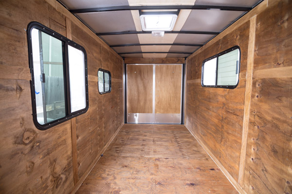

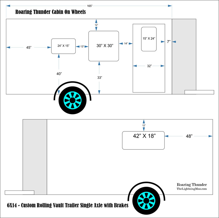

A very BIG THANK YOU to Iconfabul8 for helping me with the sketch for window placement.

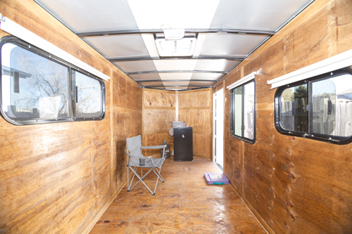

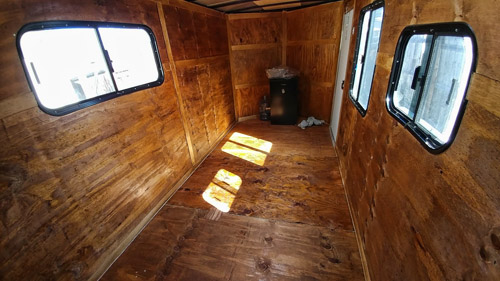

Next, to keep weight down I am going to sand, stain and poly the plywood on the walls and floor.
After staining with Golden Oak.
Light Cabinets will be covering most of the walls so I may only skin in exposed places with barnwood paneling or leave as is.. Thinking about making cabinets with this as well hoping it is thick enough if not then the birch for cabinets and the paneling for accent. I guess I am going to have to take some cabinet making classes. :?

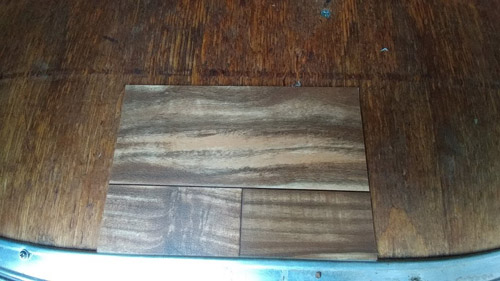

One piece vinyl flooring inside to keep things light . TrafficMASTER Redwood Acacia 12 ft. Wide x Your Choice Length Residential Vinyl Sheet Covers 12.0 sq. ft. $10.24 /linear foot - https://www.homedepot.com/p/TrafficMAST ... /300866841 Throw rugs on top of that. Need to know if I should glue or just float?

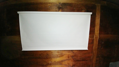

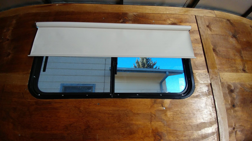

Window Coverings - pull down blinds. Levolor Cream Room Darkening Cordless Vinyl Roller Shade (Common: 37-in; Actual: 36.5-in x 78-in) https://www.lowes.com/en_us/mylowes/pur ... =345200411 these can be cut to exact size at the Lowes store. $10.97 – $21.97 Price is right. Do not have the skills to make custom drapes so this is a great option.

Nice! Aside from the door window I think they gave you just what you designed. It's fun to watch things come off the drawing board and into reality.
Congratulations on a speedy trailer acquisition. :thumbsup: Looking forward to your build.

Put a coat of polyurethane on the stained plywood walls and floor. Should put one more coat on the walls.
To keep things light, the floor will have a 12 foot one piece vinyl sheet cut to fit side to side. Will be two feet shy of the back. That will have a wall unit for back grill gallery so I will put something different on there. (Or can take part out under the bed.) Not sure whether to glue down or float as I will be putting bed and couch on top of it.

Nice day... had to get something done. In the meantime I decided to put up the window shades. Easy cheap solution. The small ones are like $10, large $20.00 levolor pull down blinds at lowes. They cut them to size. That was one of the problems I was having finding the correct widths. Mounted nice. Simple and easy. Thinking about covering the blind roll and hardware with a cover up shelf / box. The lap seal finally came today, so now next stretch of warm days I will try and get the fantastic fan mounted and start wiring this up.
Mr Bo
