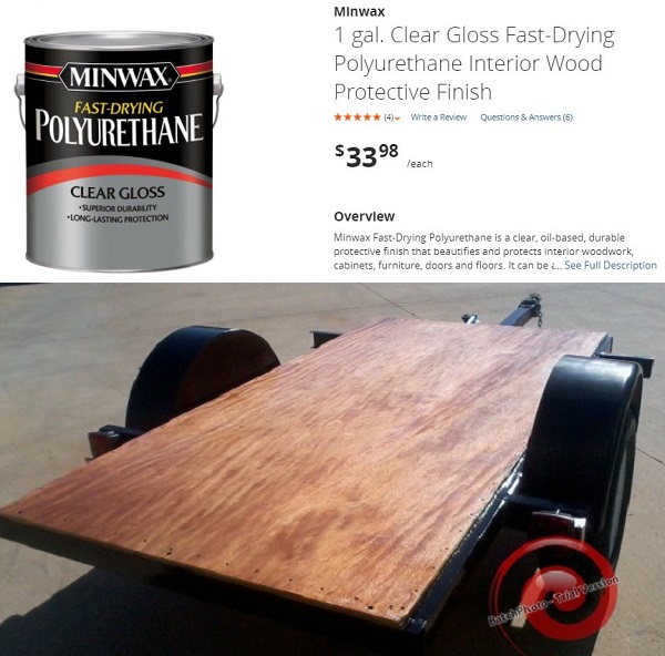

  • I don't know what are inarguably the best floor coatings are, but here's my experience with coatings, at least in the TD or TTT world: I like oil-based polyurethanes or oil-based acrylic enamels...period. They penetrate better, and stay in the wood longer, making for lasting durability, IMHO. I've only built one trailer, my 4x8 TTT, but I researched for years to find a moderately priced "wonder" coating. One that would withstand the small trailer camping experience (i.e. >> doors open as much as they are closed, with possible interior exposure to sun & rain, and the exterior usually exposed year-round to the elements), and found several ways to accomplish that goal, but resorted back to using oil-based coatings, with high V.O.C. content (volatile organic chemical suspension media - the part you can smell aways off) that dry quickly, but leave a consistent smooth finish (latex is a problem for me). I used to love lacquers, also with a high V.OC., and also oil-based, before I discovered polyurethane coatings, and their acrylic enamel cousins.
  • My trailer build started as a low/no budget affair, one which I wasn't sure I would complete, so I didn't buy the $100+ a gallon "wonder" coatings I found, or didn't want to try epoxy or fiberglass work again (after several mediocre results, in automotive dabbling). I was willing to use products that I had tried with some success, at least with their past formulations, on other projects, so I ended up using Min-wax and Valspar coatings.
  • I had used Min-wax polyurethane coating on a "nude furniture" make-over, back in the late '80's (at least I think it was poly...I know it was Min-wax), that turned out terrific. And my Grandfather always used Valspar, even though he could get a cheaper Sears brand paint for cost, from my Uncle. He (and I painted his house in the mid-'60's, and it lasted nearly twenty years. I know it wasn't poly or acrylic enamel. but it made me trust those brands.

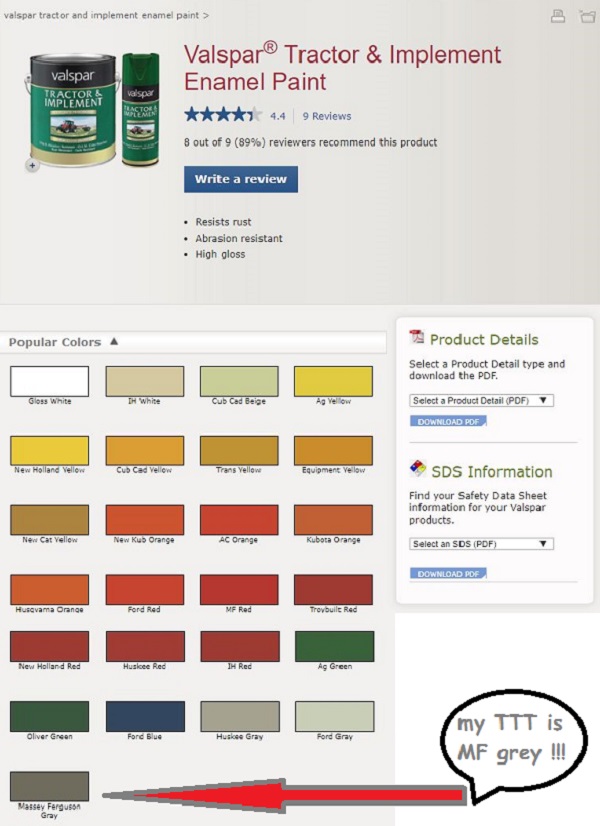

  • Time passed...time for my TTT build. I did my floor first, using 1/2" birch plywood, covered with softer 1/4" Luan (in order to cover carriage bolt-heads, securing floor to frame). I wanted a tough finish, so I sought out polyurethane, and found Minwax poly at Home Depot. Several coats later, the floor looked great, and has withstood many gallons of water exposure (long story), over the 6.5 years since I coated it. Then, after the sides and top were built, I knew what I wanted to use already...Tractor Supply Company-branded (Valspar) Farm and Implement Paint (Massey Ferguson Grey).
  • I really liked "battleship grey" paint, having built dozens of ship models as a boy, and even painted my room with a special batch of battleship grey enamel, I had concocted at the local paint store (pre-big box store days). My Dad was furious, but it lasted 'til well after I left home (it took many coats of white primer to eventually cover it). I saw a tractor at a Swap Meet that was exactly the right match for my room color, and the guy that owned it said it was Massey Ferguson Grey (a new brand/color combo to me...my only tractor experience was an old 8N, co-owned with my accountant father...it was a lighter grey). If I had ever re-painted my Chevelle, that MF grey was to be the color choice; but instead, I painted my squareback trailer with it, found at TSC, after searching for the color in the Valspar line.

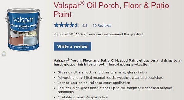

  • So, after much ado, I have three recommended coatings that I would recommend (though the TSC MF Grey is no longer Valspar-made, but now by Majic, it is another choice to consider).
    Minwax INTERIOR poly floor paint.JPG (109.83 KiB) Viewed 2592 times
    with an interior-grade coating, my floor is covered with rubber/carpet mats
    Valspar Tractor and Implement Enamel Paint.jpg (113.04 KiB) Viewed 2592 times
    my "battleship grey Massey Ferguson Grey" warship/TTT on wheels
    Valspar INTERIOR or EXTERIOR floor paint.JPG (70.15 KiB) Viewed 2592 times
    I would trust this coating as an alternative for both interior and exterior, on brand alone
