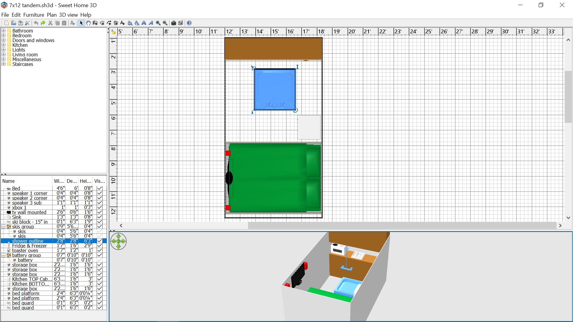

PS: I have a few sketchup models but do the files get uploaded or just screenshot of them?

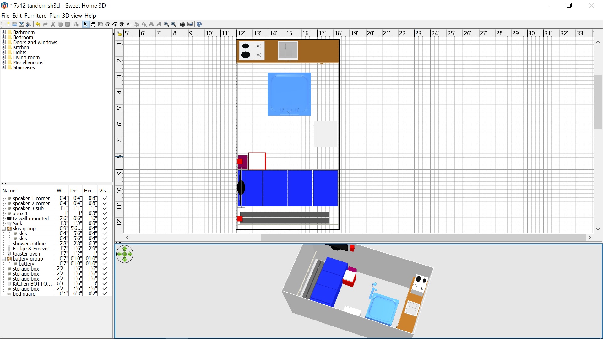

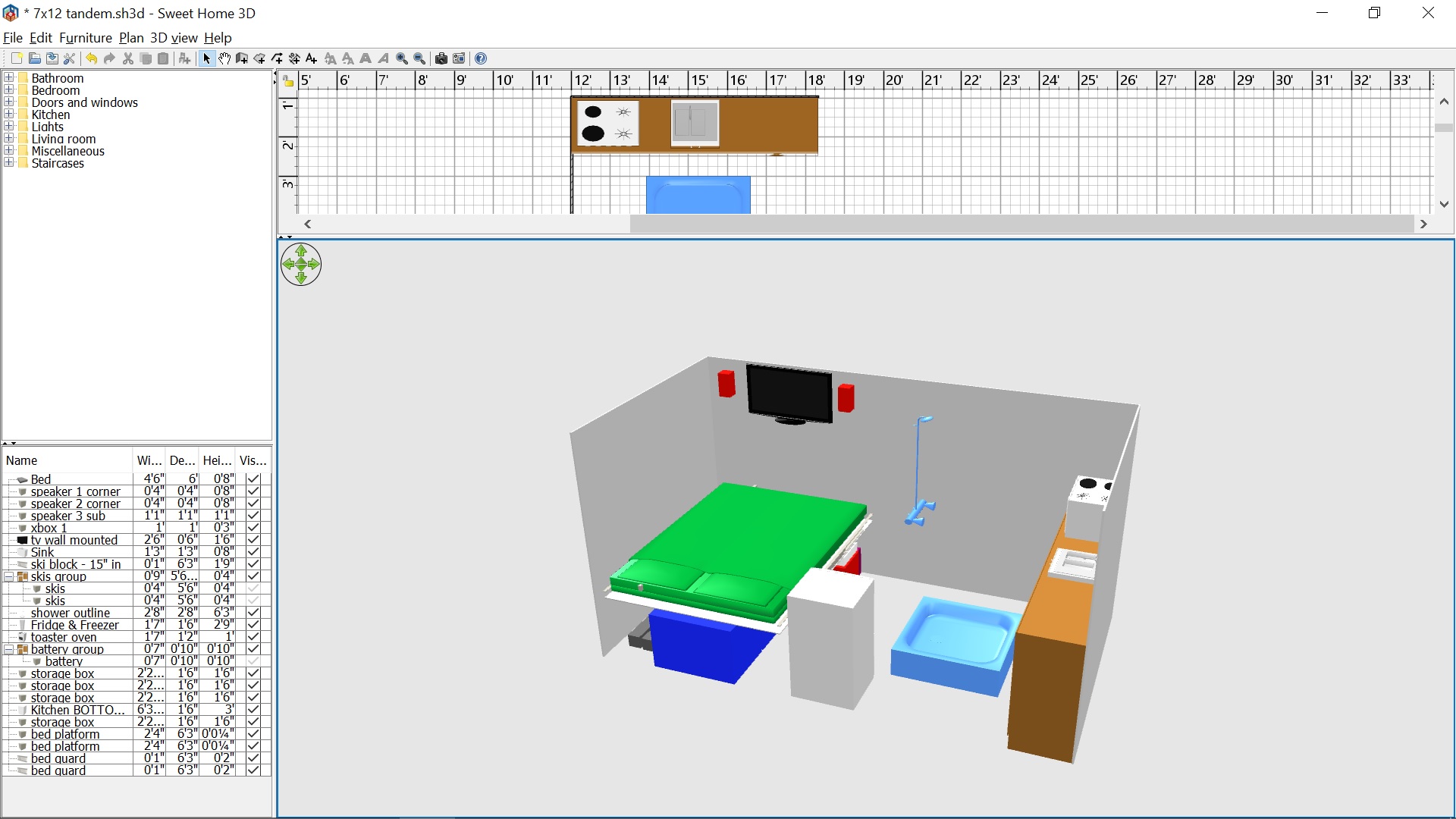

Postby Wampalampa » Thu Mar 08, 2018 4:07 pm
Attached screenshots
second
first
