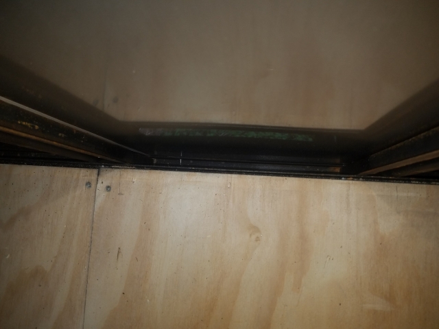

I have the same gap at the bottom of my exterior skin to frame juncture. Been pondering about
that for a few years now and am of the opinion that it was/is a design feature to help prevent
moisture from creating mold and rot on/in the wall panels. I've not yet insulated mine (been almost
4 years now), but when I do I going to gule some screen trim (1/8"X1"), to the outboard facing side
of the insulation to continue the breathability and hopefully keep on preventing rot and mold, if that's
why those gaps are there to begin with ...

What about mice? Where I live, they find their way into everything!

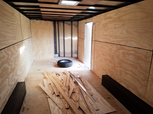

I feel that the gaps are there due to the simple design of the trailer.. it was just easier to leave the gaps then to not have them in the first place. I don't like them and plan to fill them. Our camper had insulation in some sort of bag/vapor barrier on the underside of the trailer with no visible gaps. If i can recreate that to some extent, I will be happy.

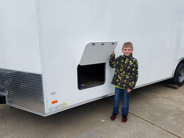

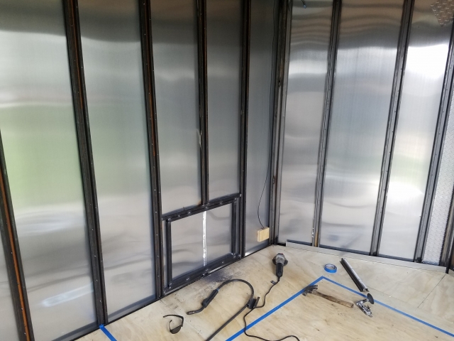

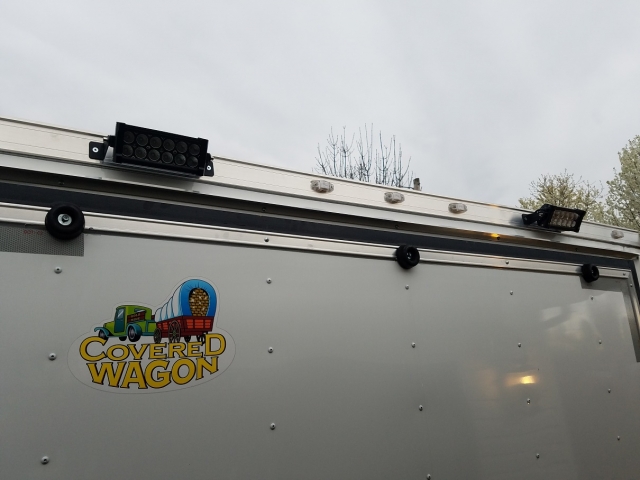

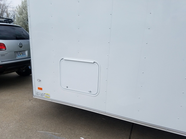

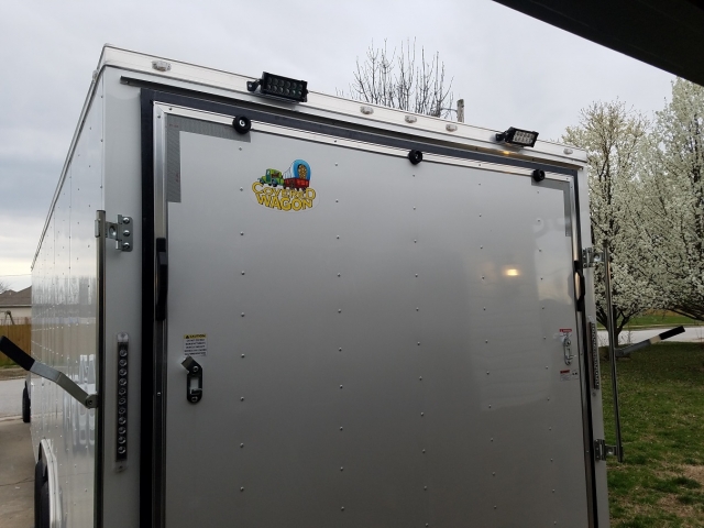

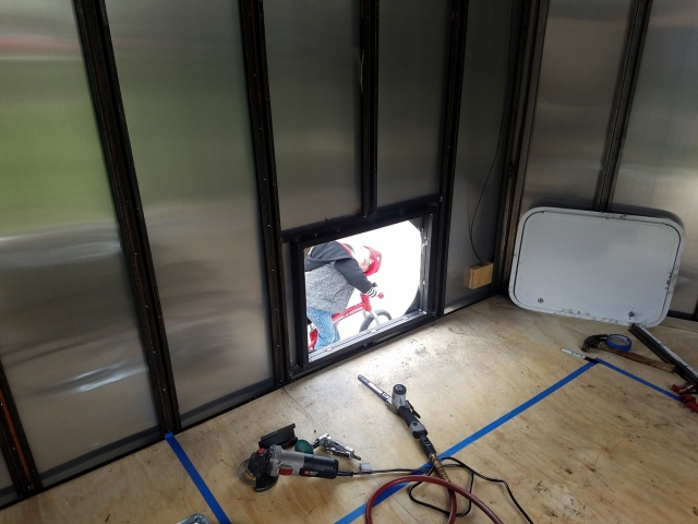

On another note i received some LED interior lights, porch light, and LED flood lights for the rear above the bay door. I ordered the rooftop AC unit (dometic 13,500 BTU). I also ordered a 24"x18" lockable door as I plan to add a fuel canister storage compartment in the left front corner of the trailer... I plan to remove some of the wood flooring in the compartment area and replace with expanded metal.. build the walls and roof of the compartment skinned in sheet metal and sealed to not allow fumes into the trailer but to allow it to vent through the expanded metal floor.. that's my plan anyways.
McDave wrote:Nice metal work there VW. Does that VW pull a trailer pretty good? They are pretty strong runners.
So, I have similar ramp lights and have them wired for back up lights as well. Helps a lot. I just used a relay triggered by reverse lights on truck, but powered by house battery, and a switch just inside ramp. Relay prevents backfeeding and such if trailer is left plugged in. Those lights are very bright, and I have mine angled a little to shine down and out so I can aim the trailer into driveways or parking spots with mirrors.
You are off to a great start, enjoy!
