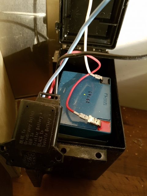

Postby CoventryKid » Wed Apr 11, 2018 7:28 pm
Just hook them up to your house batteries.
Billbob412/Salsadog:
Here's what I found when I opened the breakaway battery box:
Obviously, I don't need the battery charger (black thing).
So, do I just wire the blue brake wire to my house batteries and ground the white wire? Makes sense to me, but I just want to be sure I do this right.
Thanks in advance!
