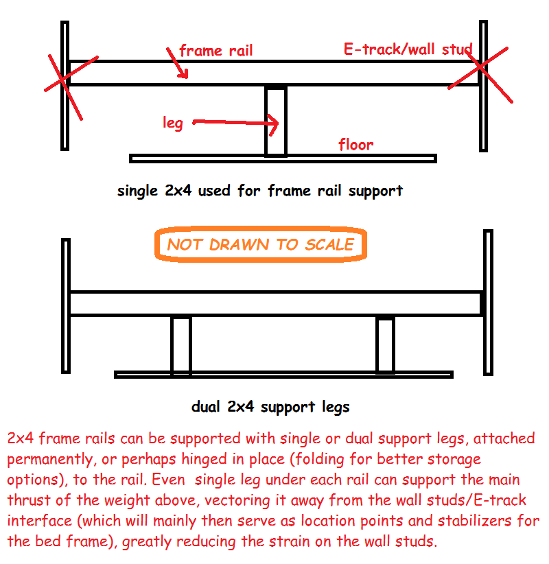

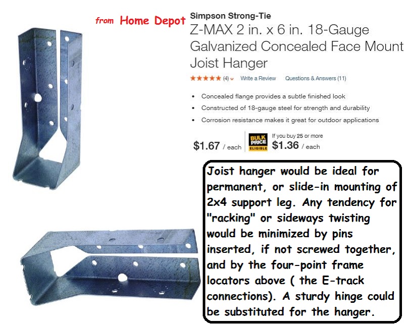

mlowry7 wrote:Just purchased an 8x16 lark. It has the Z style wall studs. I want to run queen bunks in the back. Are the Z-studs strong enough the hold the beds with 2 average size adults on bottom and 1 or 2 children on top? I'd be running e-track for the 2x4 support hangers. Also, is there any reason to run a full length of track, or can i use the single e-tracks just where I need the 2x4 runners? Thanks!
  • I've used a small (2 ft.) horizontal E-track for strapping items inside my TTT, and larger ones inside semi-trailers to secure much heavier loads from movement, and have used them to stack lighter loads on top of horizontal load bars, too. In my trailer, the E-track & straps only need to keep the items (2 Aquatainers and a large cooler) from shifting or sliding around, as the straps/load bars/E-track keep loads from shifting/sliding inside a semi-trailer. In both cases, the majority of the weight/load is borne by the trailer floor, which the load is sitting on, not by the wall attachment points. My TTT's E-track is simply glued/screwed to 3/4" plywood, and in the semi-trailers, they are screwed to the thin plywood inner walls, and to metal studs, like in your trailer. Those trailers are designed for this method, and those stacked loads use many horizontal load bars under them, to spread the load out, lessening the strain on studs and walls.
  • I don't know how strong your vertical E-tracks-to-Z-studs will be, and whether or not your trailer walls/ inner structure could support the weight of your bed, when occupied, but I would put vertical support leg(s) underneath the frame rails, for added strength. The support(s) underneath, 2x4's, will easily hold the weight, and the E-track/wall stud will not bear the full weight, but mainly serve to keep the bed level and steady, and eliminate sideplay. You could use a bracket to make a slide-in (under?) mount for the leg, or permanent with the same bracket (joist hanger), or with a sturdy hinge.

Postby mlowry7 » Fri Apr 13, 2018 10:45 pm
Thanks! great idea on the support legs. What would you suggest for top bunk?

Postby working on it » Sat Apr 14, 2018 12:46 am
mlowry7 wrote:Thanks! great idea on the support legs. What would you suggest for top bunk?
  • Same leg support system, stacking one level atop the other, but with a different material used. Assuming that the bottom bunk support leg(s) are assembled first, then a simple 1" diameter oak dowel (with simple wooden dowel pins glued into each end) could be easily inserted into shallow holes drilled into the top of the bottom rail, and on the bottom side of the top bunk rail (preferably directly over the floor support leg).
  • 1" diameter oak dowels are extremely strong, will easily hold nearly as much weight as the softer 2x4 material support legs, are round (so that incidental contact by the lower bunk's occupants will not be as abrasive), and will not need permanent attachment to the rails. The oak dowel supports could rest inside slightly countersunk inlets on the topside of the lower bunk bed framerail, if only for added stability, and to keep skin or bedding from getting caught if there is much flex during the night. Of course, being a bolt-together type of redneck engineer, I would use lynch pins, or actual bolts, to ensure more rigidity...but then, that's just my way.

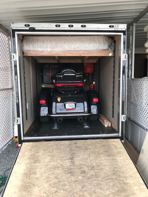

Postby phoenixbound » Sun Apr 15, 2018 5:14 am
I didn't go with bunk beds, but I did use eTracks. I have to haul my Tri-Glide, so I need almost the full width when hauling. The plan is bed raised and locked with Tri-Glide under when traveling, at campsite unload Tri-Glide and lower bed to needed height, when we get ready to leave raise bed and load Tri-Glide. I have setup some pulleys and ropes so that one man could do the lift or lower. Honestly, it will be easier with two men. But, that is not always possible. I used 2 eTracks on each side with beam holders. I plan to give it a test going to Sturgis this year. The bed is a 10" memory foam that I happened onto, very soft.
