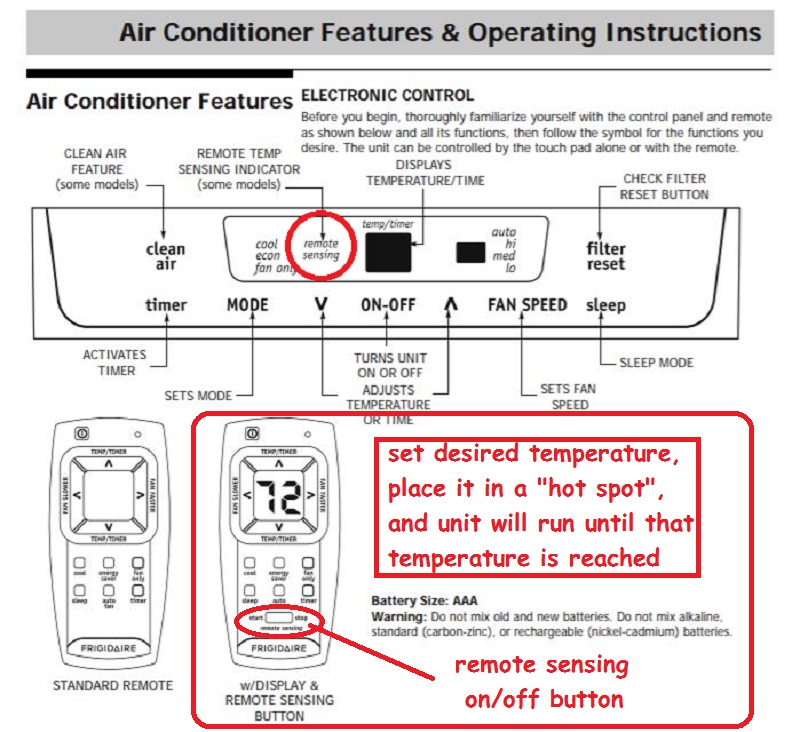

  • If you want a 6k btu air conditioner, and want a remote control for i, then why not get this other version of the suggested Frigidaire unit: https://www.amazon.com/Frigidaire-FFRE0633S1-Window-Mounted-Mini-Compact-Full-Function/dp/B01B4XUPYC I've used three 10k btu versions of it, and two 15.1k btu units, all with the remote temperature sensing remote, and loved the way it/they worked. By placing the remote controller in a "hot spot" will serve to make sure that the entire room/cargo conversion reaches your desired temperature; without remote sensing, the A/C will read the temperature of the return air, being drawn into the filter area, which will be cooler since it is closest to the unit's output. In my old house, I could really feel the difference when using the remote sensor.
    FFRE0633S1 controller.JPG (190.11 KiB) Viewed 5319 times
  • Be aware that all Frigidaire A/C window units produce a lot of water condensation (at least my 5 units did), that constantly drips from the backside. Make sure that you allow for this in your placement of the unit, especially when you slide it into storage position. On the other hand, I've used both a 5k btu LG in my trailer, and an 8k btu LG unit to cool my wife's office (in the now-demolished old house), and neither unit dripped water at all, but used it all up cooling their internal parts. Both units cooled very well, though neither had a remote temperature sensing controller (the 8k model did have a regular remote; the 5k model is manual controls only).
