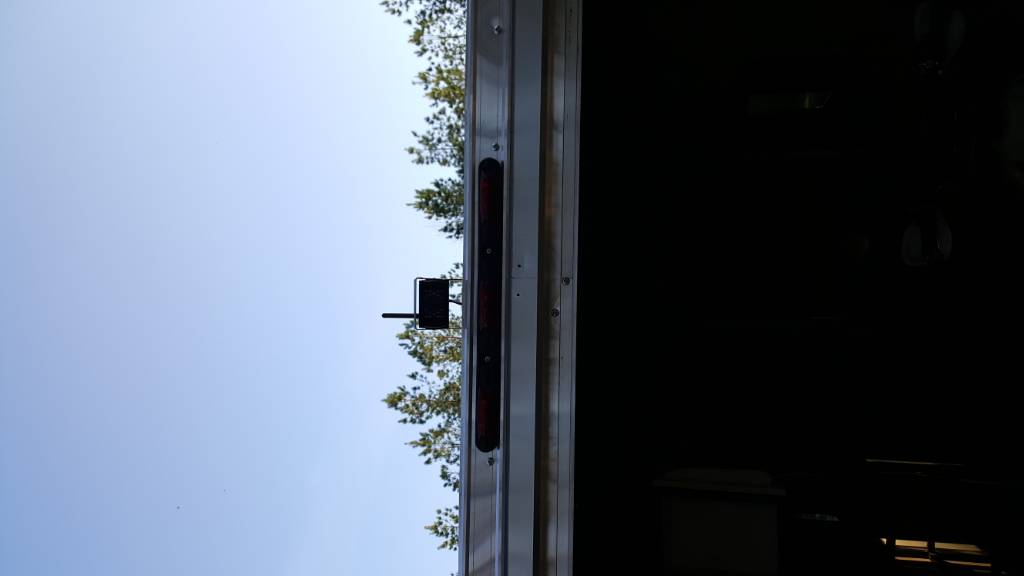

I made a tempalate for the kitchennette. As stated earlier, this will be a mostly dry camper and as simplistic as possible, while providing what I aim to get out of it. A majority of the time, we will be in a campground where water, maybe sewer is available. I was going to go the cassette toilet route, but decided on a marine toilet instead. I bought the largest that I could get to hopefully last us through a long weekend. The only waste that this trailer will have is grey water. If I cannot get away with just letting it flow to the ground (whats the diff between showering outside vs inside in regards to grey water). If need be though I figure that I can use a portable grey water container if any campground nazi's are patrolling.
Cabinets will house the water heater, electrical converter and battery. I will do upper and lower cabinets, along with a few extra cabinets spread around the trailer to create as much storage space as possible. I initially planned on doing an RV stove/oven and a fridge, but revised to an outdoor camp oven/stove combo (nobody wants me stinking up the camper cooking fish, etc, so cooking will mostly be outside) and a 150qt cooler to maximize food/frosty adult beverage storage space. The cooler will have a bench top on it to provide room for additional seating.
I was anticipating taking it on a preliminary maiden voyage to do a weekend dual-sport, but blew my back out picking up a generator the weekend before. It was sad cause I was all packed up and ready to go. In preperation I added a strapless wheel chock and also added a rear facing camera so I can keep an eye things.. oh well, unload and keep working..ImageImageImage

Postby Alice » Wed May 09, 2018 12:00 am
Nice work there!
A question about your camera, looks wireless and monitor looks great. What kind is it?
Thanks! -Alice

Postby domoarigato » Wed May 09, 2018 12:57 am
Alice wrote:Nice work there!
Thanks! -Alice
Hi Alice,
Yep, it's a wired/wireless camera. I set it up real quick like to get it ready for a ride and used the wireless medium for comms between camera and monitor. There is some static, but not unbearable as I can still see the buggers behind me pretty well. That said, it does come with an exterior magnet mount antenna for the monitor which I have not used yet. I imagine that will clear up the intermittent static as there will be a true line of sight between antennas and no metal to try and get around.
Here is the link for the camera. The majority are cheap and from China (trying to read/comprehend the install instructions make it obvious), so I went with one that disn't break the bank and had a decent set of reviews.
https://www.amazon.com/gp/product/B0754 ... UTF8&psc=1
