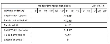

Postby phoenixbound » Fri May 11, 2018 3:02 pm
If I buy a 12' x 8' RV Awning is the total length required to mount it more than 12'? I have about 12' and maybe an inch total length to work with. Thinking I may have to get a 10' x 8'. Also does it come with the awning rail or did you buy it and cut to size. I am very close to ordering and trying to get it right. Thanks.

Re: Another Awning Question
Postby ris » Fri May 11, 2018 5:31 pm
I bought a 9' awning and the guy told me it would be about 9'6". It is supposed to come in Tuesday. Hope to have it on by Friday and then I can answer the length question for sure. They also said I would need the long arms. Because of the length from top to bottom. On my trailer that top to bottom is about 82". I was told it will come with all the hardware to install and use the awning.
Postby Padilen » Fri May 11, 2018 8:08 pm
From doing mine, it's the size of fabric. And then you add at least 6" for the tube ends and side brackets. But each manufacturer maybe different.
Postby McDave » Fri May 11, 2018 10:01 pm
Just measured,
10' x 8' = 120" total retracted. Fabric looks to be 9'6". Aleko

Postby phoenixbound » Tue May 22, 2018 9:53 am
I went to the Aleko website and asked for a copy of the install instructions for a RV Awning. They sent me a doc with the instructions. It also had a table that shows the required available length for each awning. Very helpful. I will be getting a 10' x 8' awning for my 6' x 12' CTC. I had 12' and about an inch of length and they need at 3" extra. Now I know.
