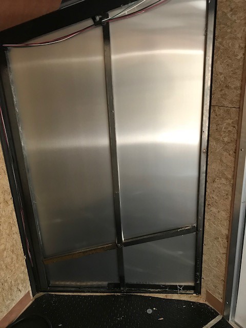

I am thinking that if I put it in the I wouldn't have to cut any cross members. This is a picture of the nose from when I putting insulation in. I am pretty sure that several of those vents would fir without needing to remove any cross members. I have to to frame out and build the front anyway. Shouldn't be hard to build a support piece out of wood. I don't weld (yet).

If this is going low down and inside the Air envelope of the TV, you could just mount this to the outside (it is a flush mount) and then cut whatever piece you want out behind it and divide up intake and exhaust. Many ways for that to work. Just put a drip edge on top made out of 1/2 aluminum angle stock.
You could really put it anywhere and then take some vinyl cloth and make a cover to put over it with Velcro all the way around to hold it when traveling so water is not forced in by wind. Simply pull the cover off when ready to use the AC. I think this will accomplish what you want and can get the grille at Home Depot for $32.00. In fact.. the cover will keep the bees from doing their thing like they do here in Florida.

Yea, the idea is really growing on me. I am thinking internal mount like I have seen on other trailers with a vent like that on the outside. How much space around the AC should there be? How does the separation of incoming/outgoing air work?
