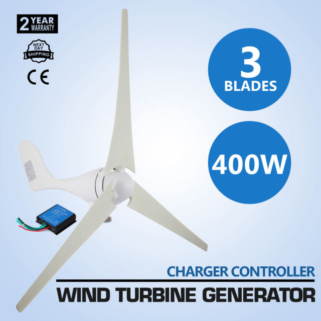

Anybody have any experience with these 400W wind turbines? I was going to build my own from a car alternator/generator and cut blades from a 4" PVC pipe, but these seem inexpensive enough. I know there are others of better quality and I would pay more. I am just wanting to know if these type of wind turbines would be a good idea for when I go out west into the desert. My understanding is that the winds blows all night sometimes and even during the day, so this would allow a charge at night and of course I'd have solar in the day. In solar and with the winds blowing, I could run my AC while charging the batteries slightly. Thoughts? I'd mount to the antenna mount I already installed and it would have a separate controller to the battery bank.
Also,5 blades or 3? 5 Blades would probably work better in lower wind speeds for starting and etc.? I do not see great reviews for these anywhere... probably a good reason for that... a lot seem to be about the start speed (advertised at ~7mph) and the need for at least 20mph wind to get a decent output. What is the wind speed out in the desert at night? I have been out there before and it seemed to be more than just a good breeze...
I see these on sailboats around here all the time and I have seen them on a few RV's that are parked. Obviously I'd slip it off the mount for travel. Maybe should forget about it and supplement with the Honda 2000 as needed? :lol:
https://www.ebay.com/p/400w-Max-Power-3 ... 0005.m1851

Absolutely silly to consider using on a moving land vehicle. Learn some basic physics.
Carrying around and setting up the large strong tower required for stationary use strikes me as extremely inconvenient.
And other than in the desert, I would not want a reason to search out the windiest spot to camp, best to avoid them IMO.

For sure... why would someone attach to a moving vehicle... besides McDave's jet engine comment, what gave you the idea that I'd install this on a moving vehicle? I know the physics. These little wind generators are not that big (~3ft to 3.5ft diameter of blade rotation)... only 400W output best case at rated wind speed to supplement a solar setup.. Not seeking windy places for sure... but it is a reality in some places as you travel around the country and can supplement solar at night or cloudy days. Simple as that.
In fact it may not be worth it... that is why I am asking if someone has actually used them and what they think "first hand". . I have seen them on RV's and etc. attached to 1.5" to 2" pipes much less than 8' just a spinning away . May not be that inconvenient if staying in one place for weeks at a time. Certainly would not waste my time for overnight trips or even just a day or two. That is what the Honda is for if needed.

Postby John61CT » Sat Jun 09, 2018 4:07 pm
On cheaprvliving a guy rigged a towed break-down tower, said abandoned the idea after three uses, solar all the way.
Fewer and fewer boats bother with wind.
Usually noisy and lots of vibration.

Thanks Iconfabul8 and John61CT... that was the kind of information I was looking for. I knew full power was 29MPH, but 100W at 15mph... Looks like it might not be worth the trouble... especially if I need to take off the blade to stow each time and carry all the piping. :thinking:
