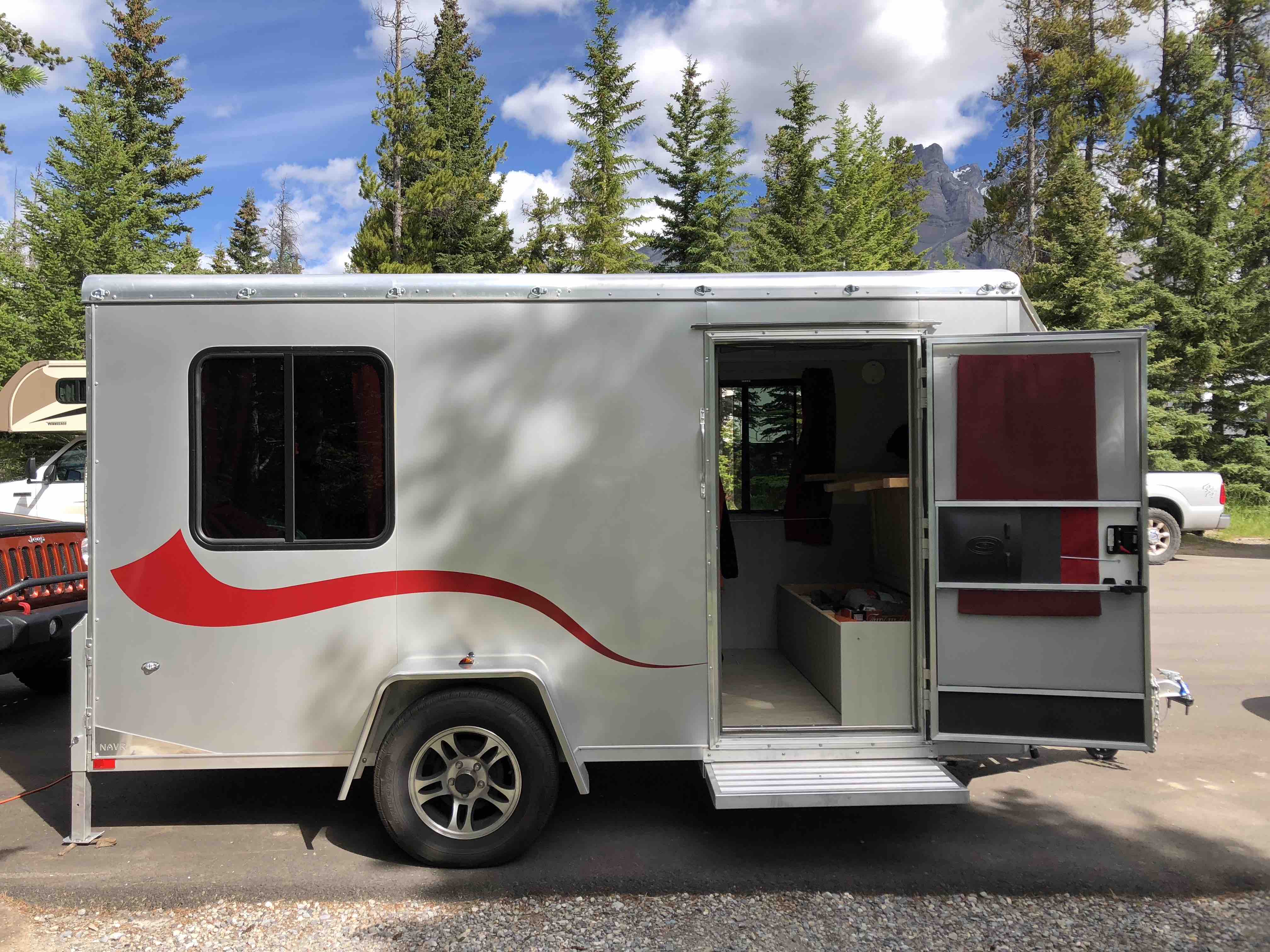

Hi Guys
Have been told I need an awning rail for my cargo. where does that connect. Above or below my drip rail..Then does the awning unit slide in to that drip rail and is that what holds the unit in place. Have a 12ft side, should I get a 12ft or smaller that the full side.
Has anyone installed one yet. What did you buy and are you happy with it..Looking at Carefree, none electric and eventually adding an add-a-room
Cheers
Al

yycwrangler, Howdy;
WoW that's alotta photo to wander around in! Great scenery.
My question to your query is how is that section of your trailer built. In other
words where is the top rail that secures the ribs (verticals), to the roof?
That's where the strength would be (imo), and I'd also look for the joints
between the ribs and the horizontal frame for the weight bearing attachments.
Only a suggestion as to how I'd go about it. Or, do like some others have and
build an attaching system that works for you .
By the way, ... what are those "D" rings along the wall/roof interface used for?
hank

Postby yycwrangler » Mon Jul 16, 2018 2:20 pm
hi guys
many thanks for your feedback. That height above my door has worries me..I've been using a easy up gazebo and as such have been able to open the door without any problems but that didn't have a slope on the roof section..
That Keder rail mount look like a great idea, I'll certainly have a good look at it
Domo you mention other installs..Is there a section within the TNTTT that would show me other options on cargo trailers.
Hank I have a family substantial aluminum framed trailer. My plan was to actually run some large bolts through to the inside and use several pieces of iron that I could put on the inside, after the ribs allowing several ribs to take the weight for each bolt used to secure the rail.
McDave...I think at 10ft is going to be the best plan. What model did you get and does it clear the door without an problems
Again guys thanks for your help and info
Cheers
Al

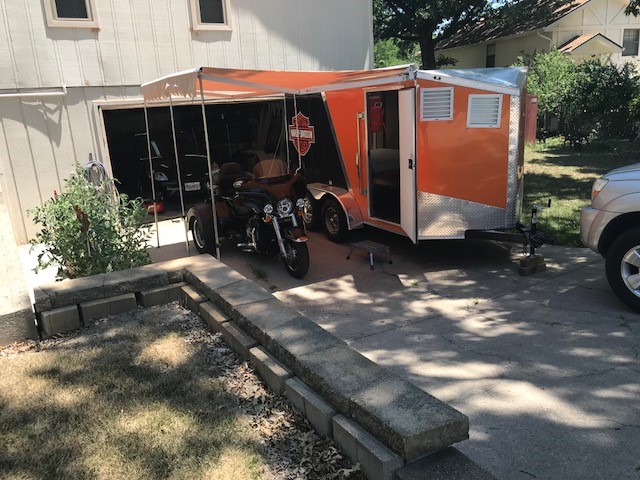

Will the the awning be big enough if you install a width from the back just up to the door where the door is not covered? I did a bag awning like that and it worked great. If you have 6" clearance it may work if you put the awning rail at the highest possible point. Here is an example for running the awning short and not over the door. I had no room over the door with my first CTC.
149232

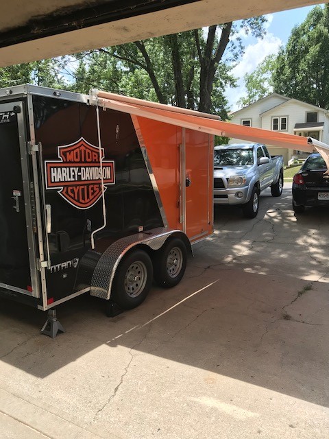

Postby phoenixbound » Fri Jul 20, 2018 3:23 am
I just finished putting an Aleko Patio Awning on my CTC. I have a 6 x 12 trailer and I bought a 8 x 10 awning. I was able to mount it in the space above the door. Although it works I did have a couple of issues. With it deployed the door hits the awning bracket and it was pointed out to me by McDave that the far end could pose issues with whacking your head when you walk around in the campground even for a short guy like me. So, I went to Cabella's and bought some adjustable tent poles to prop up the far end. That works and it really doesn't add much to the setup time. I can raise it to clear the door, but honestly I don't need it that high all the time. I will probably end up opening the door, latching it open, deploy the awning and then raising the far end enough to prevent head-whacking. The first picture is the awning deployed without the tent poles on the far end and the second one is with tent poles propping the far end enough to allow the door under it. Good luck.
