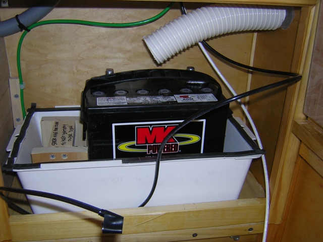

I am using an Ebay group 27 100 ah. Have been using for over a year. So far so good. Never been below 12v.ImageImage
Sent from my SM-G930V using Tapatalk

friz wrote:I am using an Ebay group 27 100 ah. Have been using for over a year. So far so good. Never been below 12v.ImageImage
Impressive battery install.
Re: Time for a new battery...what's "hot" these days?
Postby featherliteCT1 » Mon Jul 16, 2018 6:19 pm
Ditto on the battery box! :thumbsup:
