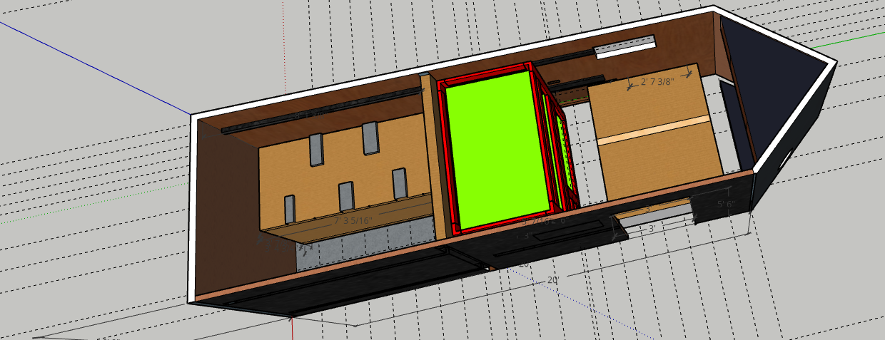

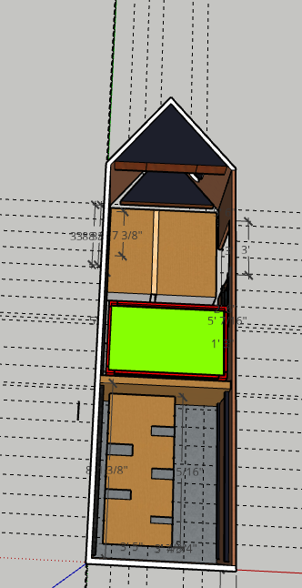

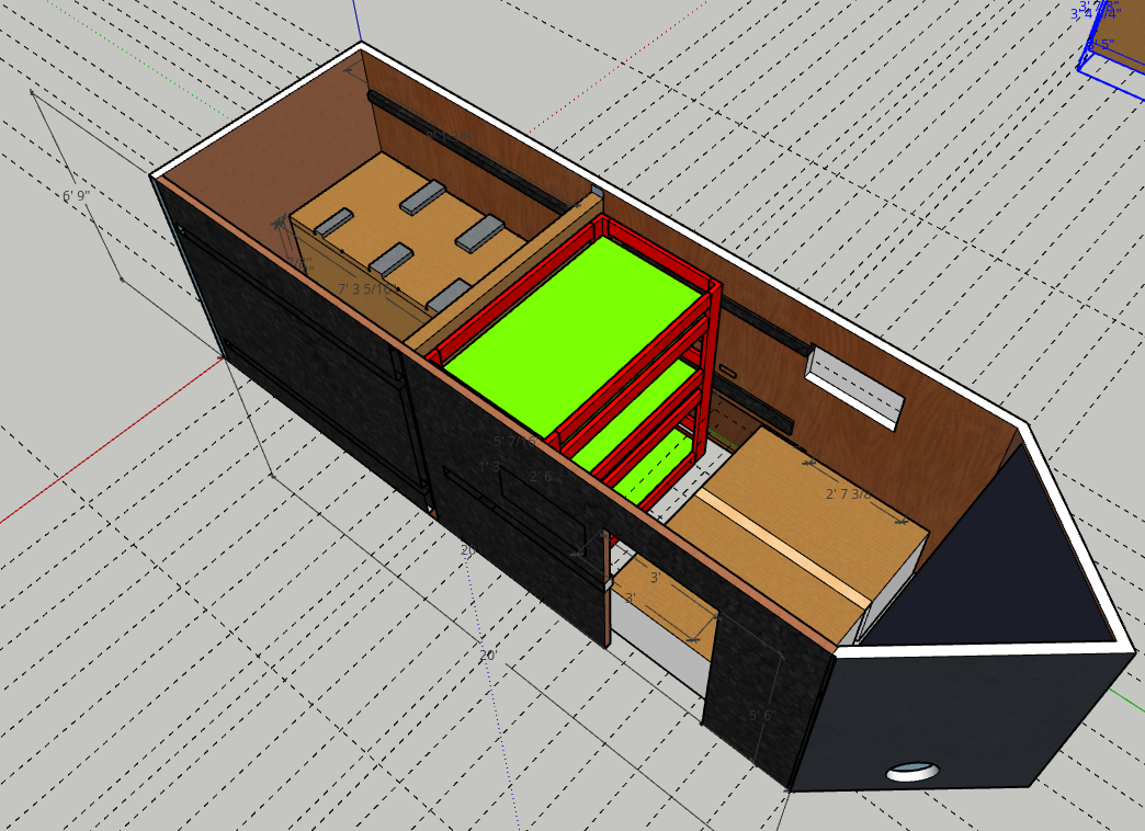

Postby Mtnadventure14 » Tue Aug 07, 2018 1:10 pm
I am a total beginner at sketchup and slowly learning the software. These are some very basic designs specs and ideas so far - definitely open to suggestions.
1)Garage space in the back with vertical bike mount on off-road casters which is the rectangle in the picture. Then a partition wall intentionally with no door. This way the front of the trailer can be closed off and a/c used there and not in garage. Garage will convert into space for riders to warm up etc for races on rollers or trainers.
2) Triple bunk bed setup with a combination of e track bunk tracks on each wall vertically (not in the diagram) and attached to partition/framed wall as well. Three levels here flush to the wall and attached to e track on each side.
3) Just forward of that is a full/queen couch to bed combo for seating.
4) Plan is for the v nose to house the kitchen area and my 6 panel electrical will be mounted on the lower right side of the v nose section.
5) Roof mounted outdoor ABS 6" piping pressurized shower setup running half length of the trailer. This will be a DIY build most likely. Anyone with experience here with a simple bracket roof rack mount for their trailer? I have found a few options so far.
6) Searching battery options now (likely want 2 batteries) and small beginner solar setup.

Postby Cymen » Wed Aug 08, 2018 9:46 am
How far does the front V extend? About 3 feet? And if you don't mind sharing, where did you order your trailer? I'm looking for roughly the same size and debating my options (I'm in Michigan).
I've subscribed to follow along on your build.

Postby Mtnadventure14 » Thu Aug 16, 2018 11:11 am
thanks for the questions.....
I believe the v nose extends roughly 2 ft or so.
I researched many many trailer companies. Ultimately decided on a company out of Md called Ultra after speaking with the owner extensively and asking about 100 questions over the course of a month to make sure I was comfortable with the purchase. A big part of my decision was that they will deliver the trailer to my driveway.
Mtnadventure14
