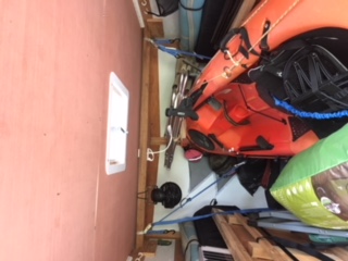

might be difficult to see in the pic but this is how i support the weight the kayak. cam buckle straps to spreader bar supported by the interior plywood wall. works great!
