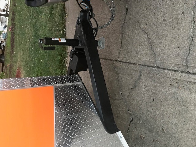

Just got back from my first camping use of the CTC. Things went really good. Wife and I are happy with how it all turned out. We did start thinking about how we could make things better. I currently have the trailer spare mounted on an e-Track rack inside. I need to move it to the tongue if possible. Any thoughts on this? At this time welding is not an option as part of the solution. I am attaching a picture of the current tongue. I have a few ideas in mind, but wanted to hear from the group first. Pictures would be greatly appreciated.

You can buy a bolt on tire carrier that will go on the tongue. Not very sexy, but functional.

There's a lot of mounts you can use but the short trailer tongue limits space. I had the same issue and used one of these mounts, which I bolted onto the outside wall above the curb side fender and through the wall struts.

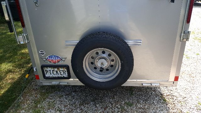

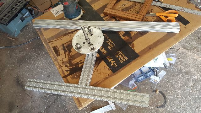

I recently had to figure out what I was going to do with the spare and the only place that made sense was a back door mount. I used some 80/20 aluminum extrusion I had here, turned a plate on the lathe for the rim backer and spaced it off the correct distance with two short 80/20 sections. Image.
In order to make sure bumps would not jar the assembly loose, one long bolt in the middle captures all of the components and serves as a lock point. Image
I mounted it with 4 bolts on the top rail and two on the bottom. The top rail bolts go thru the door into T-Nuts, just beyond the doors aluminum studs because they are only 1" x 1", and drilling thru them could weaken the ramp.
My first 12 hour drive left it in the exact shape it was when I mounted it, giving me confidence that it will forever stay put. Now all I need to do is get a tire cover.

Wow, very nice. I like it.

That does look like a good job on the ramp mounted spare. I went a different route and welded plate steel to the ramp frame members and welded the studs to the plate. This way the weight is spread out between 3 vertical and the bottom horizontal frame members. Placement was critical as you don't want spare to bind or contact the ground before ramp is fully lowered. Couple road trips, 1200-1500 miles no problems so far. I need to cover the tire as well. On the list...

Fitting a spare tire on a teardrop is one of my pet peeves. So almost no decent place for one! I like your solution. A rear-mounted spare tire seems to be the best design as long as your door can handle the strain. Yours looks beefy, so I have no doubt the tire will stay where it's told :)

Has anyone tried to mount one under the tongue of the trailer? My trailer sits pretty high considering, it would be rather easy to junk yard find a GM cable hoist for the tire to roll up and down on.
