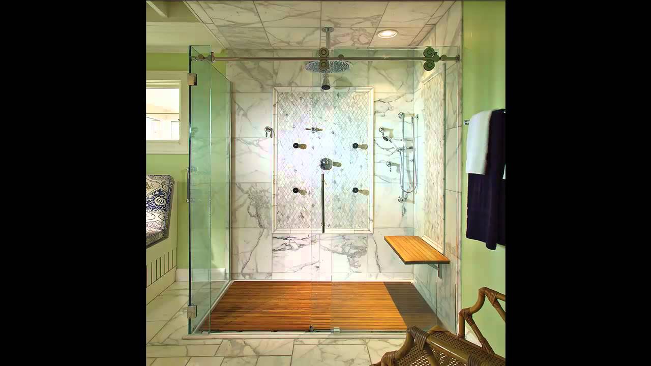

Has anyone done this or given it any thought? No bathroom walls, just a curtain.. Mount the valve and shower head in a cabinet if you don't like the look.
It might be labor intensive, but the rewards of not having a shower curb and the extra floor space might be worth it..
I can bend up and solder a 1" deep sheet metal pan, either raise the rest of the floor, or drop the floor joists in the shower pan area and then build some sort of a grate (teak maybe) the depth of the pan to make the shower floor level with the trailer floor.. Drop the front of the trailer a little to create fall for the water to find its way to the drain soldered in the very front, piped to a hepvO drain p-trap. I could cover the plywood with kerdi and then linoleum I have laying around.
Could it be done? Any potential drawbacks other than my GF making me leave when she showers? :(

Your idea for the shower pan itself is stylish -- teak floored shower. One could extend the teak minus the pan to a larger area.
Assuming the floor joists can tolerate the reduction in size -- as you are standing on them, you should be OK. Lots of TD only have 1" floors over a steel frame. Removing the flooring does reduce the structural integrity.
Assuming you have clearance for the drain pipes, etc. You might want to go to a box store and dry fit the pipes and measure. I was surprised at how much the space/length fitting take up. I was surprised when attempting to modify a shower drain on standard 10" joists.
I am not sure if a shower with no lip/threshold will work. I am not sure why the threshold is a problem eg multi-purpose that section of floor.
One, you cannot depend on the trailer being slanted or if you slant it enough, it might uncomfortable for everything else. One could add bubble levels and adjust stabilizers, etc. One could expect to setup incorrectly and have water every where. Some sites might slant, but in the wrong direction.
Two, containing the flow of water needs an enclosure. A door eg glass door closes to the top of the threshold; a curtain should go below the threshold. The above example for the Sprinter has a 2-4" threshold. The noodle approach most likely is too low/short to be effective. A curtain to the floor with no threshold is just a flood waiting to happen.
Three, you will most likely need to waterproof the inside of the trailer, at least the floor. Linoleum is good in the middle of the floor. However the edges will be an issue. Even running the linoleum up the wall might leave one or more spots which are potential leaks. Maybe you can fuse pieces together to make an inside or outside corners. Other materials might be better at creating a sealed edge eg ceramic tile and grout. Maybe caulk could be used on the edges. The new vinyl floor planks are surprisingly liquid resistant.

A curb or threshold takes up super valuable floor space. With no walls you would be tripping on them. The absents of, or not having a curb is not a problem if the shower pan is larger, or extends maybe 8" further than a low hung curtain. I'm not talking about a little 32x32 pan here. I'm talking about something two or three times that size. Maybe 5'x4'.
The pitch issue is more of a concern and the only way to truly provide it would be to pitch the pan and grate. Doable. But front to back leveling is usually easy. It's side to side which is more difficult, or just time consuming for some but I carry a jack and jack stands etc for this purpose. Lifting the grate and using a squeegee to push left over water to the drain after your shower wouldn't be difficult either..
Water proofing the wooden floor where it meets the pan wouldn't be needed since the low curtain would drain water 8" away. Then use solid surface shower walls overlapping the pan. Or some other waterproof wall system. Solder a short sweep 1 1/2" elbow off the pan to a hepvO and no need for a p trap. But also no room for any gray tank worth mentioning.
