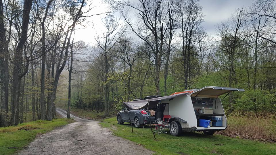

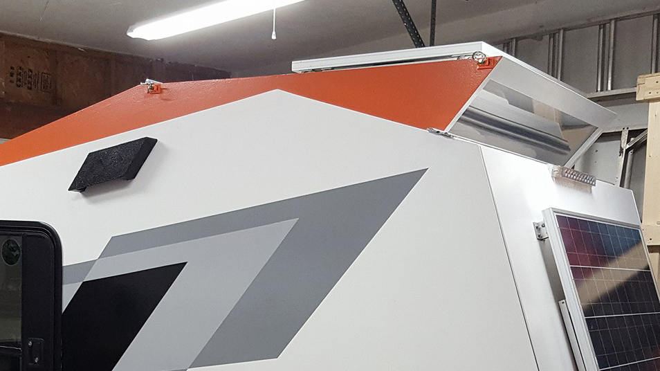

I can see a number of potential problems including the parking parallel mentioned. Having them suspended will mean you have one BIG rain catcher, and you are limited to using it when the other person is there. Separate tarps supported by poles, in our case painter poles and tied down, lots of flexibility in how it can be erected. In our case I used Kedar rail on three sides of the tear and have four tarps. When bad weather crops up drop ends...
