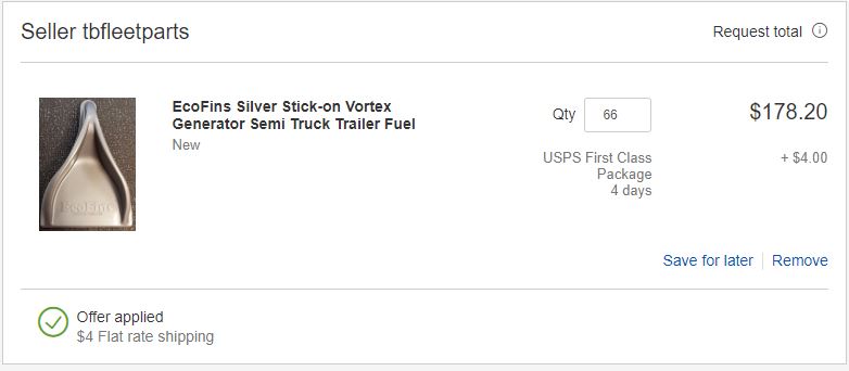

Postby flboy » Tue Sep 18, 2018 7:12 pm
I decided to quit talking/thinking about it and just do it. I bought these tonight and will have them on next week. I will be able to report the difference on my trip to South Carolina for Thanksgiving. I have good records on gas mileage and will know if these make a difference that is noticeable. Also, will be on the interstate, so will test the handling with trucks sucking the trailer over. Pics to come next week. Will update on my build thread as I am painting the roof white after cleaning and inspecting the Dicor lap seals along the edges and the holes I cut for AC, Antenna, and etc.. Never done with the build!
