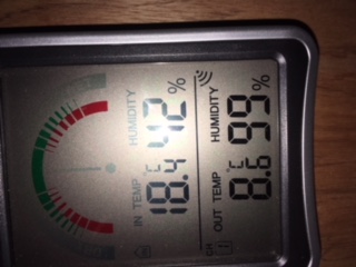

that was the temp in the morning in my insulated 5x8 vnose with only body heat and residual heat from the previous hot day.
