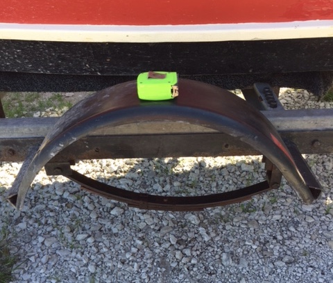

if replacing w/ leaf springs i'd look at the way boat trailer spring assemblies are made for being able to move the assembly fore n aft for proper balance
QUITE SIMPLE
you can see in this pic of the port side(fwd to the left) the black angle iron brackets that the spring perches are welded to is bolted to the galvanized frame and the leaf springs are hung from them
i made this assembly in 1991 and other than repacing the axle last year w/ an EZ-LUBE(lubes the bearings thru the spindle) unit it is still going strong
did the same thing(replaced torsion w/ leaf) on an old Starcraft tent camper to gain ground clearance for back country camping
first order of inspection of proposed trailer would be to crawl under it to see if the spindles are bolted thru or welded into the trailing arm
here's a pic of what i am thinking you might find

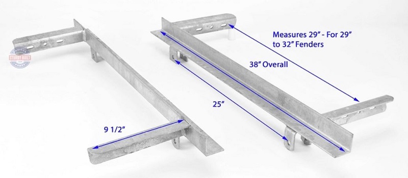

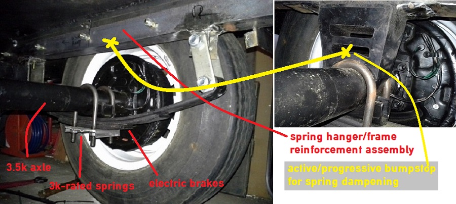

If you want a fast way to convert to a leaf spring suspension, using std. length 25 1/4" spacing leaf springs (available at just about anywhere that trailer suspension parts are sold), and a heavy-duty axle, then you could remove your torsion assembly, and just bolt-on a set of these, found at https://www.sturdybuiltonline.com/Boat-Trailer-Leaf-Spring-Slider-Single-Axle-PAIR-For-25-14-Double-Eye-Springs_p_1415.html
bolt-on spring hanger assemblies (sturdybuiltonline.com).JPG (61.1 KiB) Viewed 6227 times
these pre-welded hanger assemblies would've been ideal for my application
I made my own assemblies from 1/4" angle + 3/16" flat bar stock, and welded/bolted them on to my existing frame. http://www.tnttt.com/viewtopic.php?f=21&t=58985 I chose a 3500 lb axle, and used 3000 lb springs (per pair), anticipating a trailer weight above 2k lbs. These springs worked out just right for me, combined with my spring-dampening bumpstops, and in conjunction with larger LT tires that I bought later. But, the beauty of using a standard-sized leaf spring is that I could replace the current set with lighter or heavier rated springs for around $60-70 (at Northern Tool or E-trailer, for instance) in a hurry, if needed.
Though I spent considerably more time and money (buying 2 welders and working many hours in fabricating--it was my first from-scratch welding project) than if I had bought these, it was worth it just to make it myself. But, I was also strengthening my frame at the same time...if your frame is strong/intact, then the bolt-on assembly would be perfect for you to use, IMHO.
completed 3500 lb Dexter axle assembly.jpg (165.88 KiB) Viewed 6227 times

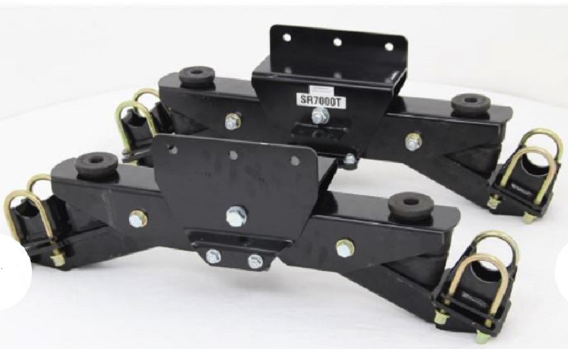

  • That Sturdybuiltonline.com website also has a kit for tandem axle bolt-on hangers, but it probably wouldn't be truly off-road rated. But, if you have the money to do so, and really want to take a tandem axle trailer off-road, then perhaps a Timbren Silent Ride tandem https://www.etrailer.com/Trailer-Suspension/Timbren/TSR7000T04.html
    Timbren silent ride tandem.JPG (73.45 KiB) Viewed 6141 times
    will be what you need? More expensive to do than a leaf spring set-up, and replacement parts wouldn't be as readily-available as leaf spring parts are, but like other Timbren pieces, would be tough enough for off-road. Especially since you could utilize complete axles (like my 3500 lb Dexter, w/brakes) matched to the Timbren bolt-on "walking-beam" tandem hanger set.
