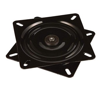

For "hinges", I saw a Youtube murphy bed video boat that used boat seat swivels as the pivot mechanisms. This seems like an ideal approach: https://www.amazon.com/attwood-17720-Boat-Seat-Swivel/dp/B001O0D6SI.

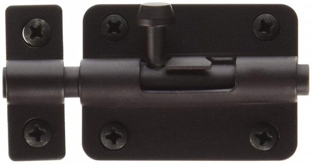

As far as latches, I think the KISS approach would be to use barrel bolts: https://www.amazon.com/Deltana-3BBU10B-Solid-3-Inch-Barrel/dp/B004KDC39Y/ref=sr_1_4?s=hardware&ie=UTF8&qid=1545144235&sr=1-4&refinements=p_n_feature_keywords_browse-bin%3A4878486011

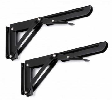

For legs, you could use folding shelf brackets, and attach the appropriate size "bed post" where the shelf would go: https://www.amazon.com/Sumnacon-Sturdy-Folding-Shelf-Brackets/dp/B07BT44C1D/ref=asc_df_B07BT44C1D/?tag=hyprod-20&linkCode=df0&hvadid=241957922100&hvpos=1o3&hvnetw=g&hvrand=7902621142610529464&hvpone=&hvptwo=&hvqmt=&hvdev=c&hvdvcmdl=&hvlocint=&hvlocphy=9027308&hvtargid=pla-506079357597&psc=1

I like the seat swivel idea. Might be a good starting point.

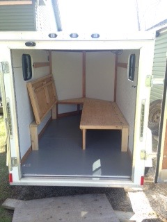

We went the basic route, and it's working great so far. We attached gate hinges to the wall and the rail of the bed. We attached a drop down leg with a piano hinge. When it's in the folded up position, we used a hasp closure we got at the local farm and fleet store.
155255
155258
155259
We're pleased with how it works, and the beds are surprisingly comfortable.
