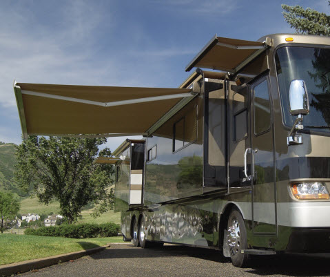

Regarding your awning, it looks like you have a good amount of space to mount it above the door, not sure if the arms of a traditional awning will interfere with the door, but you could always go with a fancy awning that doesn't have arms. The top bolts through your top roof channel that runs the length of the camper.
