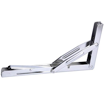

I’m looking at building a fold down counter top in my trailer. I’m trying to look for mounting ideas. I would prefer to buy a premade countertop and folding brackets like pictures. But the wood of the countertop looks like mdf. I need a good way to mount the brackets where the screws don’t go all the way through, but yet strong enough to hold the countertop in the folded down position and withstand travel. Suggestions are appreciated

Postby FlyBye » Thu Feb 28, 2019 1:46 am
atcNick
I saw your bracket post several days ago and felt like it would meet our needs for our kitchen table support. I went ahead and ordered me a pair and am looking forward to putting them to the test. I don't think I'll need the 550 lbs rating for our Chili-Cheese Dogs or the early morning tomato gravy and biscuits, but you never know! :)
I did get the long release instead of the short version like you got. The angle of the release wasn't quite as sharp as the short version and I didn't want to bump my knee(s) on the rascal. Thanks again for posting the brackets... you sold me!

Postby atcNick » Thu Feb 28, 2019 5:02 am
FlyBye wrote:atcNick
Can you post the link of the ones you got. I couldn’t find any like you described
-Nick
atcNick
Posts: 50
Joined: Sat Aug 17, 2013 11:16 am
Re: Fold down counter top
Postby FlyBye » Thu Feb 28, 2019 11:01 am
atcNick wrote:Can you post the link of the ones you got. I couldn’t find any like you described
I ordered two of them.
https://www.amazon.com/Amarine-made-Rel ... B00LGBZC4G
