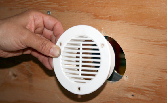

greygoos wrote:something as simple as this will help. About 10 dollars or so. You can go up from there as far as models and vents .
I put two of these in my cargo trailer one up high and one down low at opposite corners. When I travel on dirt roads I put duct tape over them to keep the dust out. I've never had dust come in when stopped. But as mentioned above a piece of hvac filter over would help of you're worried about it. I purchased mine on Amazon for $5.99 ea.
Exterior:
Interior:

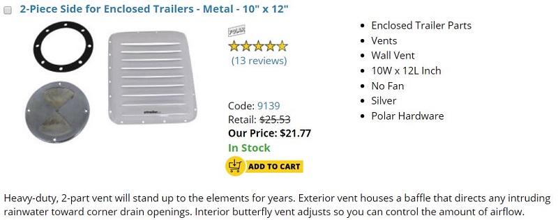

Postby working on it » Wed Feb 20, 2019 10:27 am
Go to https://www.etrailer.com/dept-pg-Enclosed_Trailer_Parts-sf-Vents.aspx to find Pop-up, or "Salem" vents in steel or aluminum, for $35-45.
I had considered getting those as my side vents, but opted for another type, that I had seen on semi-trailers, when I ran a receiving department. They never showed signs of leaking, so I got them instead.
my side vents from e-trailer.JPG (74.94 KiB) Viewed 4567 times
I put screen material inside the butterfly opening, and modified one, used to cover my A/C exhaust ducting. They work great, no leaks.
Also, I put reversible computer case fans on hinges to be able to swing in front of each of the two main cabin vents, in order to pull air in, or to direct air out (keeps dust out!). They can run forever on 12vdc battery power, since they draw miniscule amperage.
