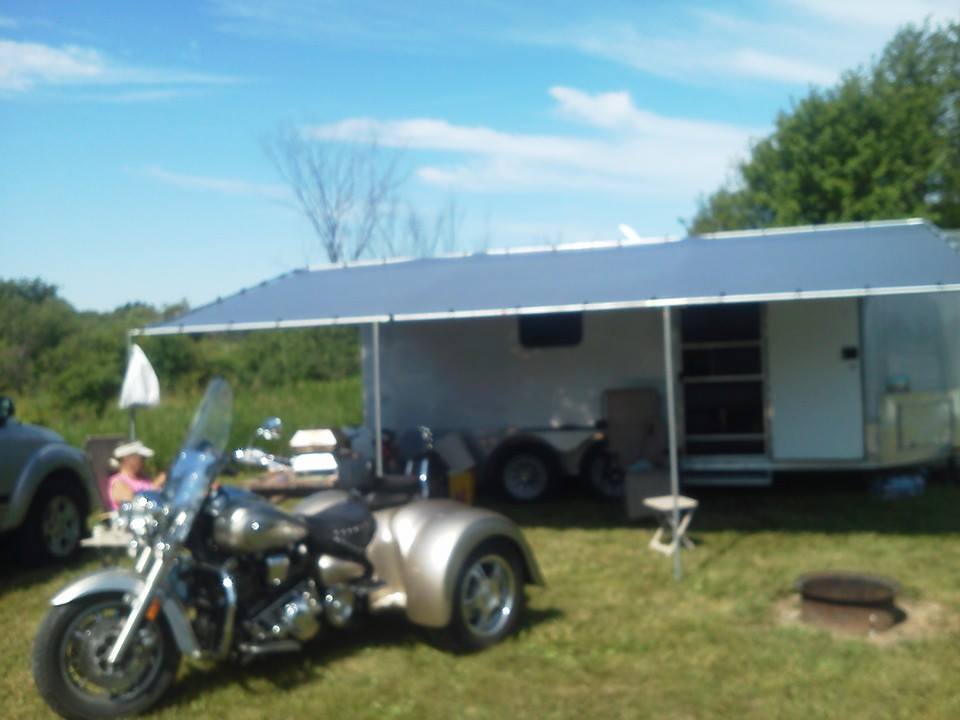

The awning I have is called a fold up but it is on a roller with a gear case. There are 2 spring loaded arms that extend and keep the fabric taught. It is basically a cassette awning without the motor and the outer case. You just use a crank handle to wind it in or out. I used a section of vinyl rain gutter for a case. I had to fab some mounts because the trailer has the radius corners from the roof to the wall, so there is nothing flat to mount to over the door. Also, I wanted to be able to fully extend the awning 8ft and have the low edge over 6' 6" so I wouldn't walk into it, repeatedly. And it would still have the correct angle for drainage etc. It sits about an inch and a half higher than the radius, but it is about the same as the roof height before the radius starts. It does not affect the roof drainage at all. But any water that hits the awning is drained 8 ft away. The side door clears the awning with plenty of room to spare and you don't have to put legs under it so you won't walk into those either. I mounted into the wall studs and it travels real nice, and the best part.. It cannot, I repeat, cannot deploy accidently! My Dad had one deploy at speed on his Peirce Arrow class A RV and it basically totalled the RV. The entire side was shredded, windows and doors and cargo doors. He said he didn't even notice it was hanging out there and it hit an abutment as he was crossing a bridge. So all those long pieces of metal were grinding it out between the RV and the guard rail on the bridge. It was a mess.
I used the 10' on my 12' and just centered it so the door is covered and there is about a foot of wall fore and aft that is not covered. A 12' awning would hang over because of the rounded wall corners and the studs would be further from the end of the awning than I would like. It only weighs about 40 pounds. Customer service was amazing. There was some shipping damage, nothing major but they were so nice about it I almost have enough parts to build another one! Really, the best service I've ever had by far. It is also made by Aleko. Here are some pics. Deployed at Sturgis, and in the driveway, and one of the vinyl gutter. It completely encases the awning when retracted.
150374
148591
148590
149720
