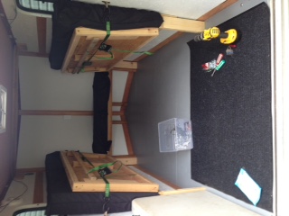

Haha, saw the post on FB! A bunch of hard heads over there for sure. It's not a blueprint, just a concept that will need a few details worked out. I sketched it up for another discussion on here, I personally went with the design below. Whatever you build, be sure to post some pics. Looking forward to what you come up with.
Bed Build Page
Pushed in for futon couch.
Extended for bed.
