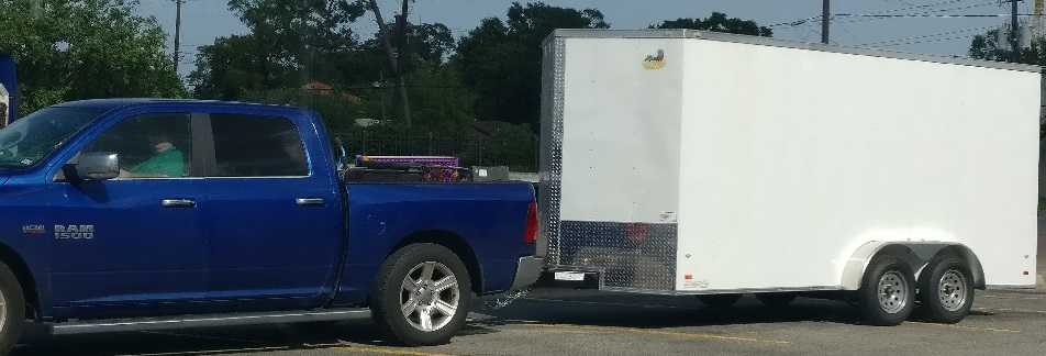

We just picked up our trailer! Covered Wagon 7'x16'x7'h with 2ft v-nose. Now the work begins. The main purpose of the trailer will be mobile office and build shop for my husband's electrical engineering business. The layout will be minimal so that we can easily swap to camping or moving heavy gear.
Only utility is 30Amp circuit for electrical equipment. There will always be shore power so batteries will be limited to enough to provide UPS function for the gear. There will be a triple shelf across v-nose for supplies or kids with addition of mattresses. The parents will have a full size futon. AC will initially be provided by portable ac unit (already owned) then upgrade to window or mini-split as need.

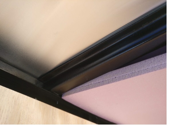

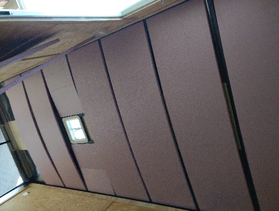

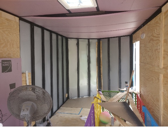

Postby Margali » Tue Jul 09, 2019 8:11 pm
Hubby will need the shelves when trailer is in work mode for his tools. We decided to make them full length and just a tad narrower to avoid the door, 6'8" x ~24".
Foam in pocket.jpg (60.13 KiB) Viewed 7472 times
Roof Foam.jpg (108.76 KiB) Viewed 7472 times
Pictures of end of day 2. All the ceiling foam is cut and in position except last bay. Mis-cut so it won't self support in the nice pocket where roof and wall meet. Once we get 1" actual furring strips ripped the foam will be pressed into bays and cracks Great Stuffed. I got the "Windows and Doors" type I think that is the lower expansion and won't bow roof.
