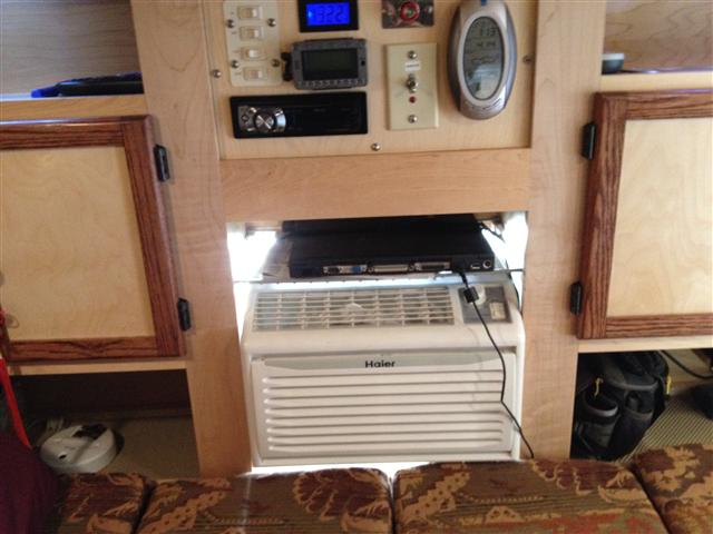

Here's how we did ours. It's a small, 5,000 BTU window unit. We take it along when we think we'll need it. It cools the camper with no problems. So far, this setup has worked out great for us!
155131
155132
154695
154433
We got it here: https://www.teardroptrailerparts.com/pricing.html It's called a baggage door on their site.
When we added the awning earlier this summer we were relieved to see that the AC hatch door did not interfere.

Postby onehoser » Mon Sep 02, 2019 3:41 pm
bdosborn, in the bottom picture, is the a/c in the retracted position with the hatch closed? any issues with the hatch leaking when it's raining? btw, nice work...
I am the wisest man alive, for i know one thing, and that is that i know nothing. (socrates)
onehoser
Posts: 372
Joined: Sun May 15, 2016 10:41 am
Location: selkirk ontario
Re: Portable AC Window Hatch in Cargo pictures needed!
Postby bdosborn » Mon Sep 02, 2019 6:40 pm
Yeah, that's with the AC inside and the hatch closed. I haven't had any leaks so far and it doesn't really get wet with the AC out as the hatch keeps most of the rain out. It would take a driving rain to get inside.
