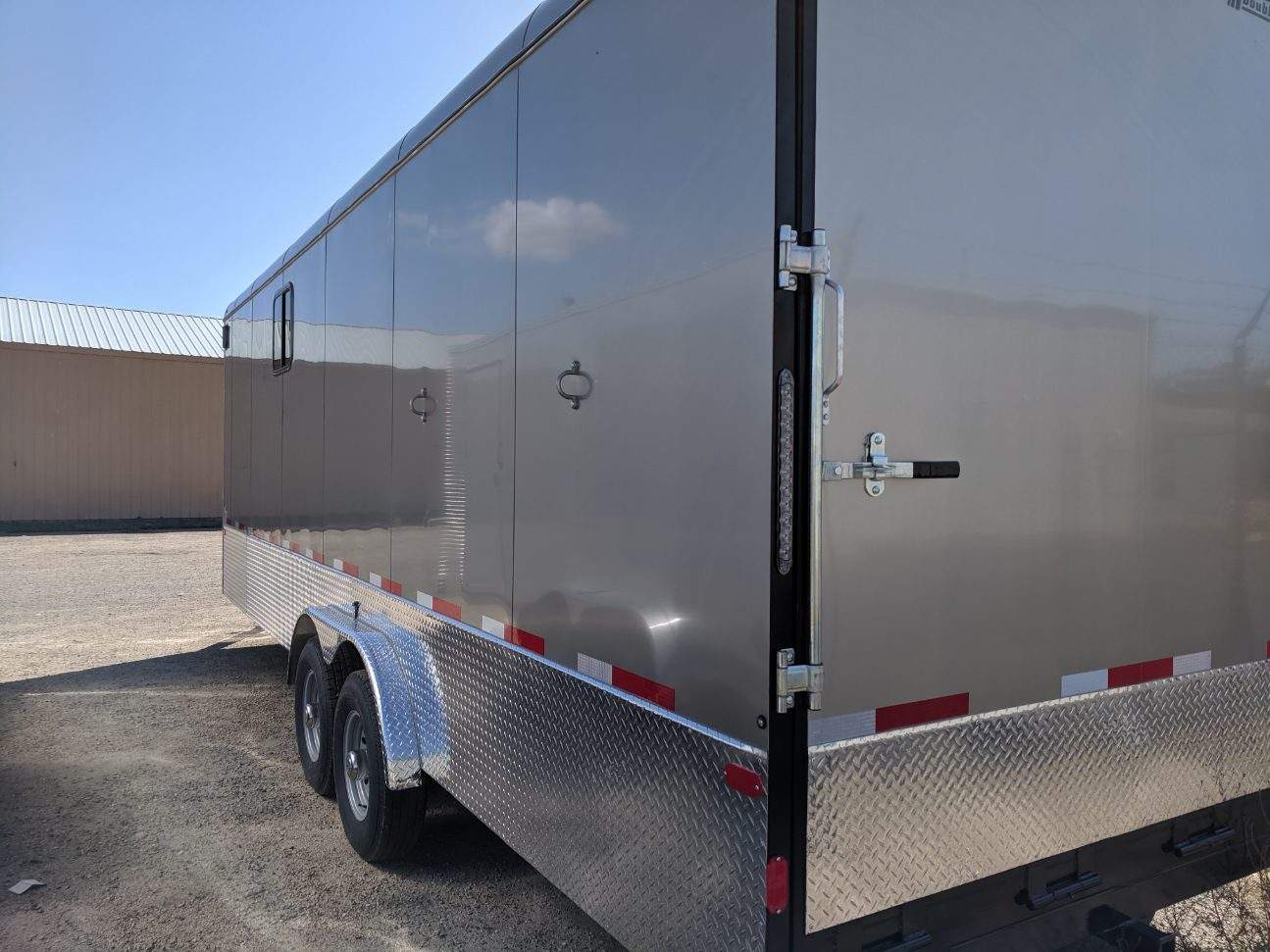

About six weeks ago, I ordered a custom build cargo trailer. <It took me 2 years to decide on the size and manufacturer-haha.> I ended up going with a company called Double R out of Nampa Idaho and it is their "All-Sport" model. My intentions for the trailer are to use it for both business and pleasure. I will potentially be working up to 5 or 6 weeks at a time across the country- multiple times a year; and also hope to use it at the beach or on mountain vacations.
I should take delivery of it in about a week and hopefully that is when the fun begins! :twisted:
The Trailer specs are as follows:
o 24'L x 7.5'W x 7.5'T flat nose plus 5' tongue
(it is a standard width axle, but I made the body more narrow by 8" in order to give some maneuverability and better viewing range- hopefully….)
o Rear ramp door
o 36" side door with screen with double hasp on bar lock
o 24" diamond plate on sides and rear; with 36" on nose
o Requested to only install half of the interior wall fasteners and bag the rest, requested no silicone on interior walls and no seam strips of plywood
o (2) 24"x20" slider windows with screen and requested the following " Install a square piece of 1/4" plywood in the window area that is 2" larger on each side than the window so customer can install his own wall liner without removing our window clamp ring." I really did not want to be installing my own windows- haha
o No "D" rings. In lieu of these; I had (4) Aluminum bolted in horse trailer tie rings installed on the outer walls ((2) on each side), to tie clotheslines and such

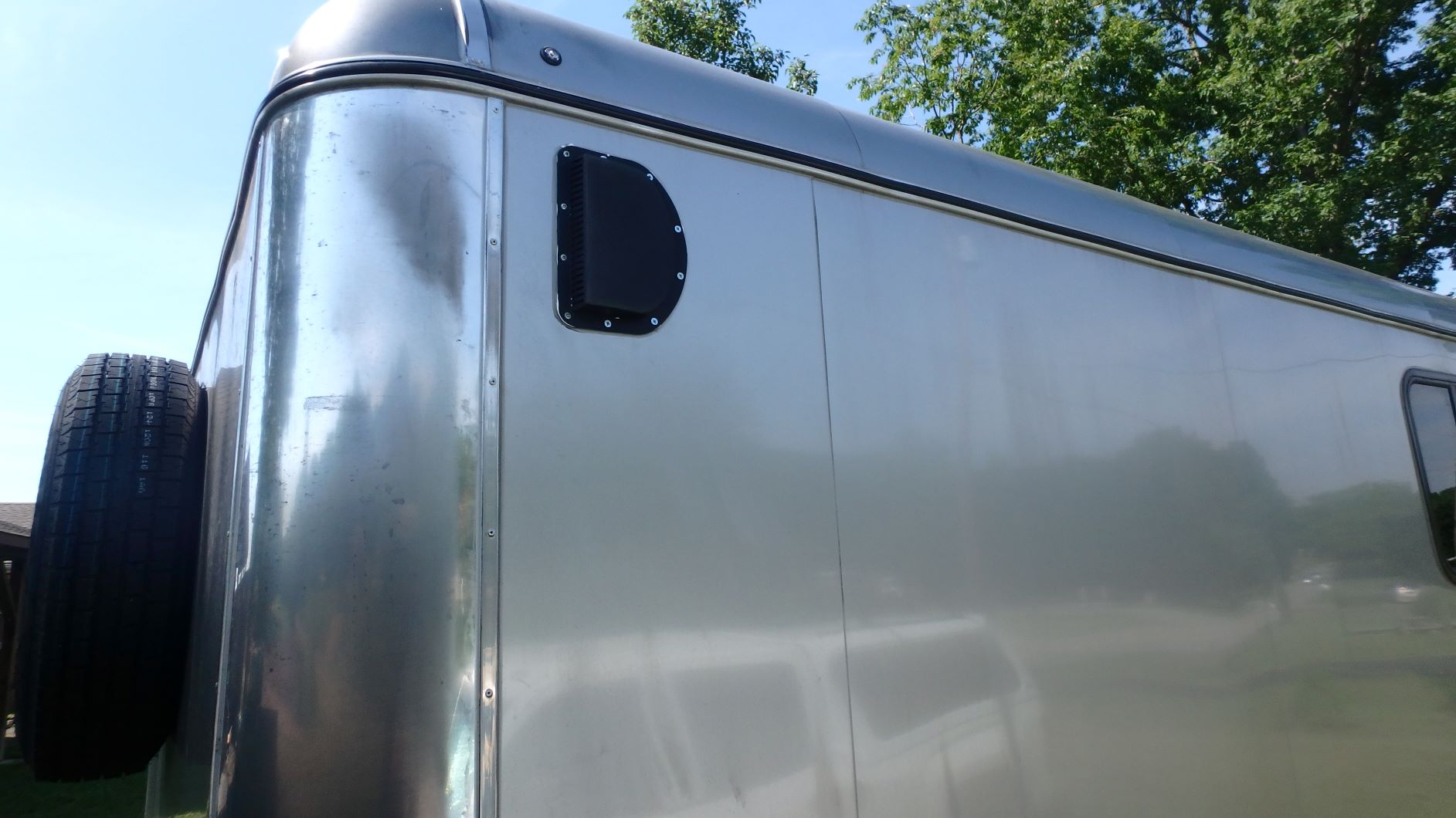

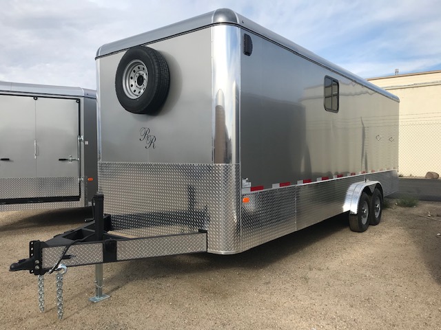

o No roof vents. No holes in roof at all! In lieu of these I had 1 set of air flow vents installed. These were supposed to be both at the rear of the trailer- on either side- where my 3' "cargo/garage" area is to be; but I see by a picture sent to me by the manufacturer that one was installed incorrectly at the front of the trailer…. Oh well. :(
o Spare tire package. Installed on the nose- up high (giving clearance for where the HVAC unit will go)
o 10ply tire- 16"- 8 lug wheels (the cheap Chinese tires will be gone- as soon as I have money to replace with LT tires- after my build)
o 7k# straight axles on leaf springs
o Rear roller guards
o Automotive undercoating
o 2" receiver hitch on rear bumper

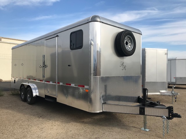

See pic sent to me from dealer.

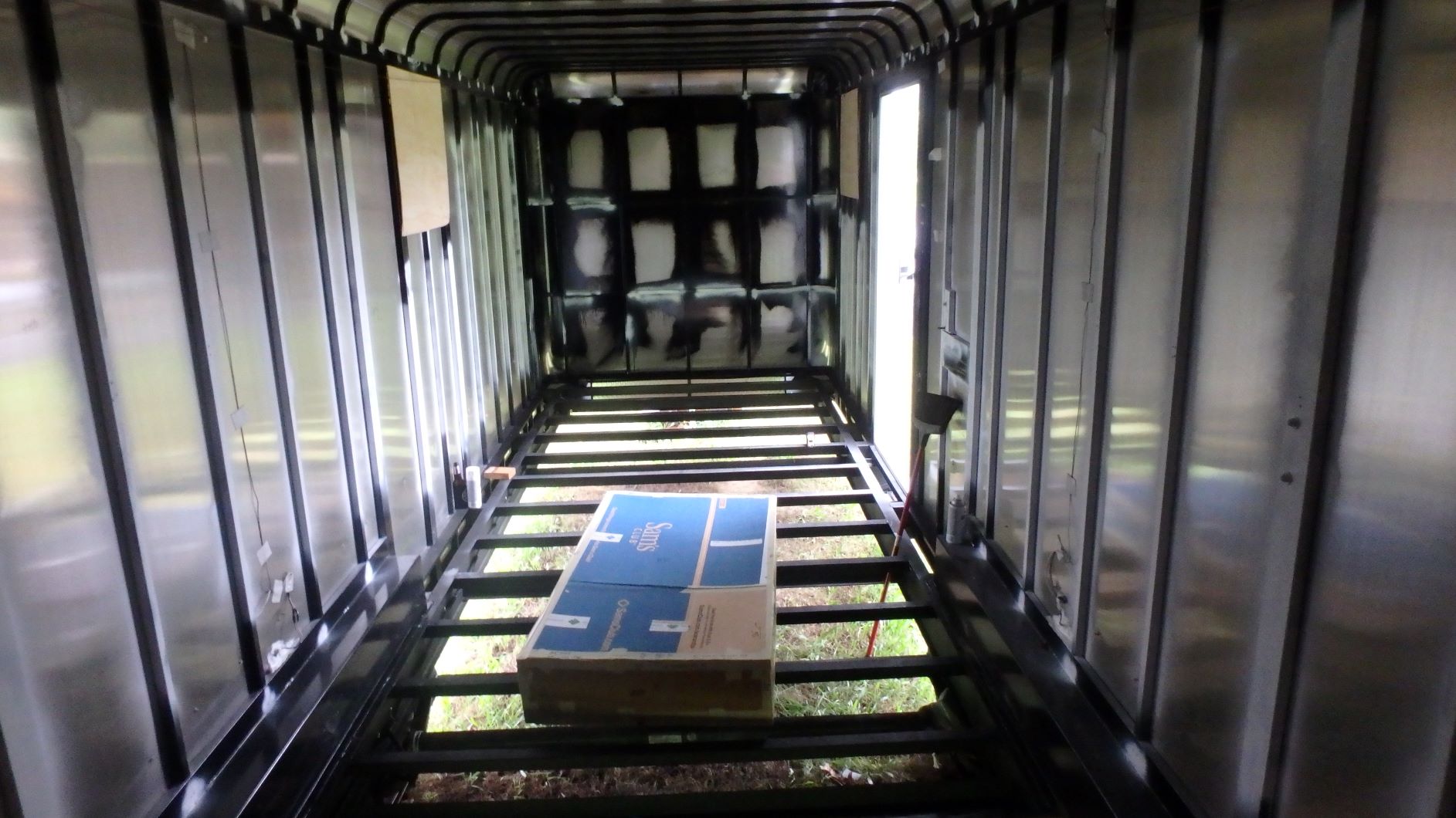

when i returned; i stripped out the 3/4" flooring and lauan wall covering. (i didnt get pics of this process)

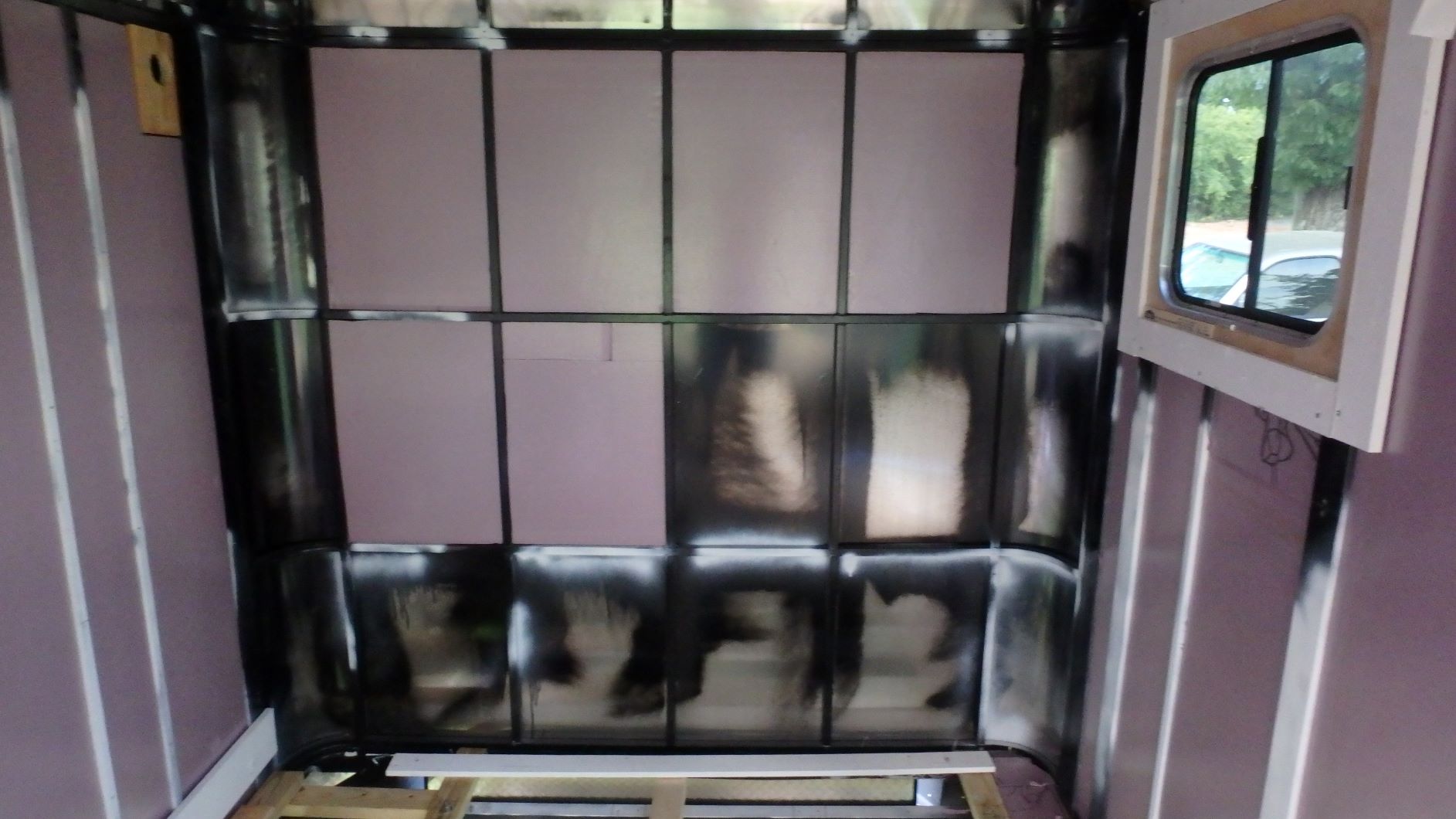

i found the overall quality of construction on this trailer to be what i had hoped for. there were a few details which were shortcuts made by the factory but overall i am pleased. one being that the spray paint did not cover under the wall lauan; even though i paid extra for weather protection. :thumbdown: so i sprayed all the wall ribs. and sanded down areas on the frame joists where some rust was forming and sprayed those also.

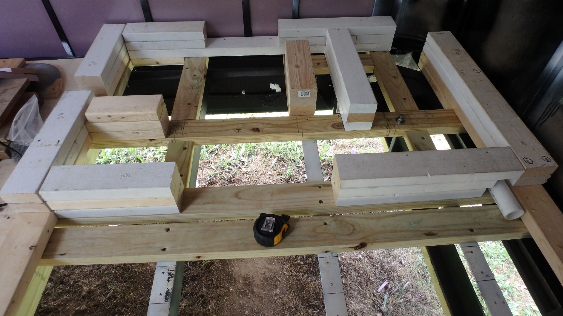

i had planned on having NO tanks, however; after much debate i decided to add a black tank and a fresh water tank. i made a "mock up" of the tank first.
Carolina_coast99

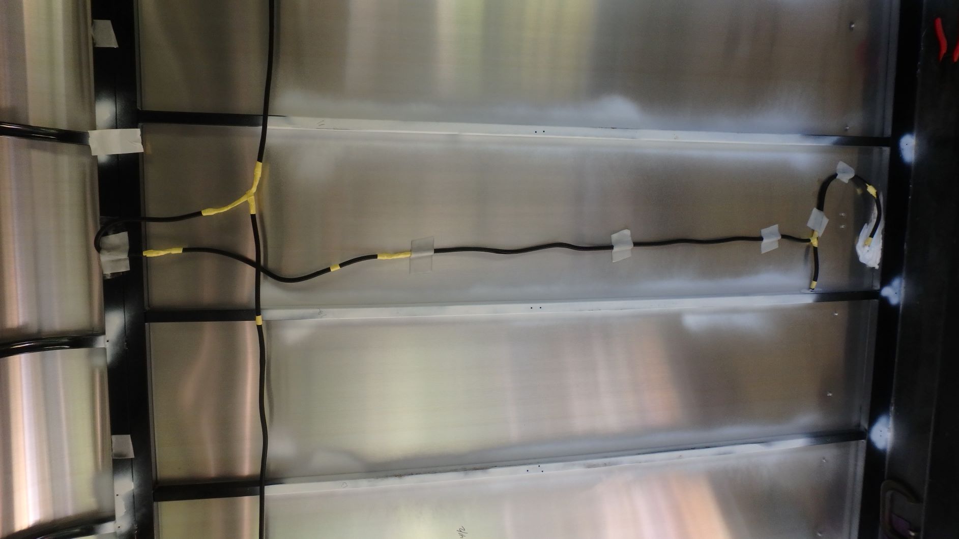

001

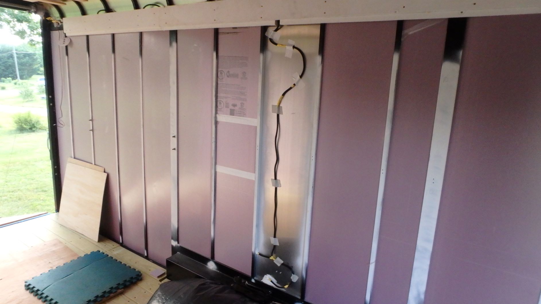

then i took out for sizing in the trailer

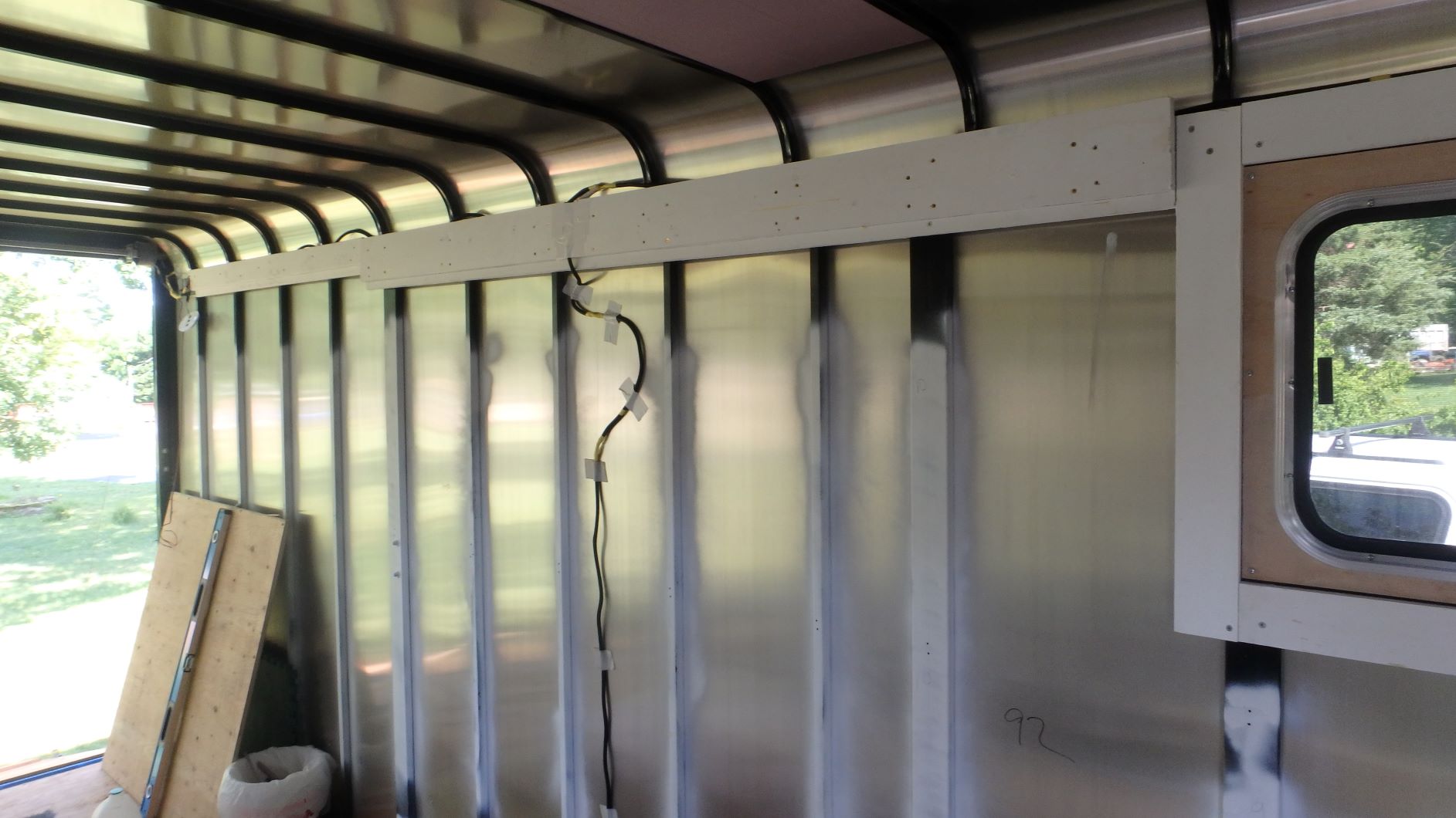

added wire loom and relocated/ soldered and extended some of the LED marker light wiring
began to fur out

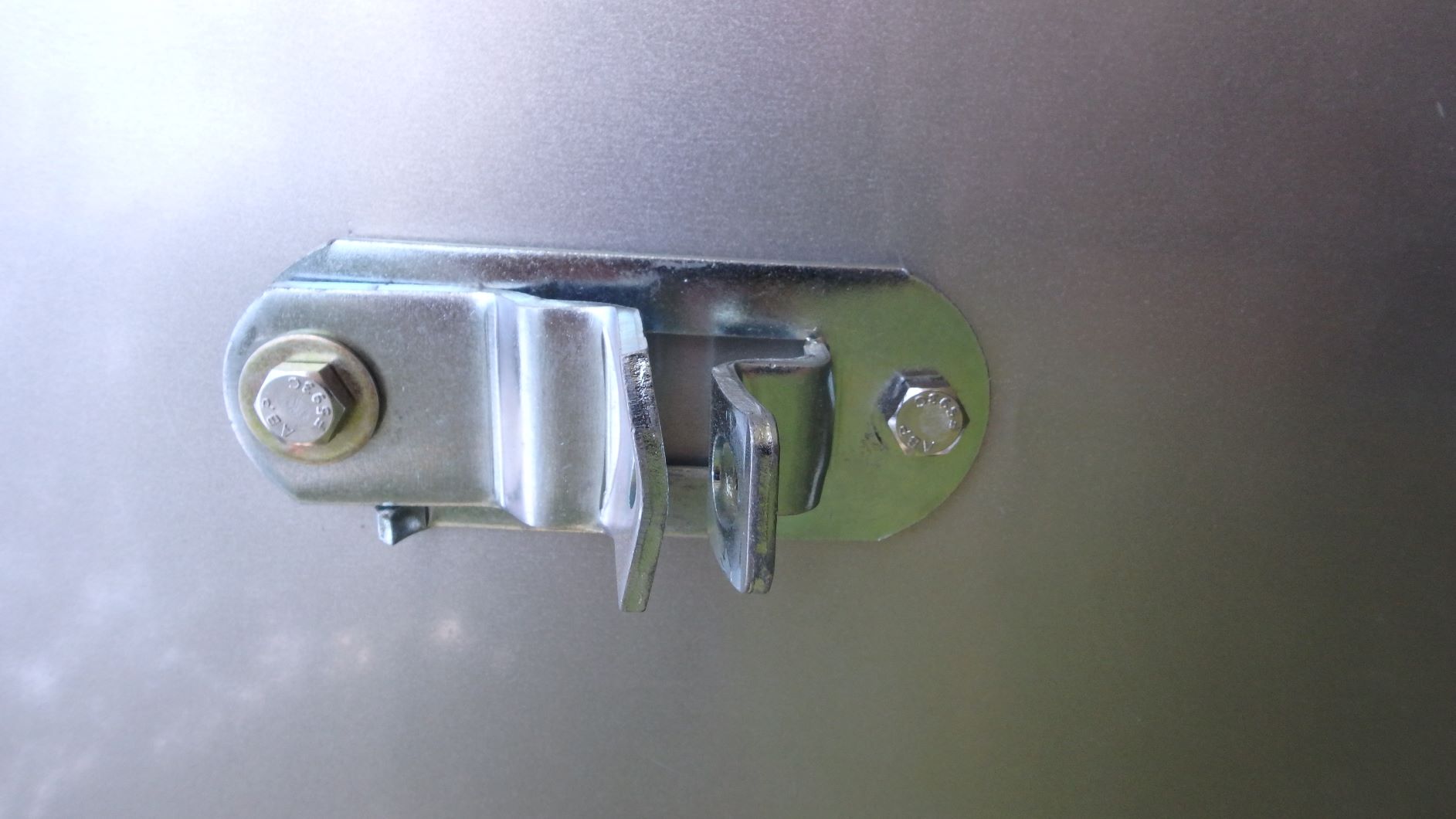

replaced original door and latch fasteners with Stainless Steel

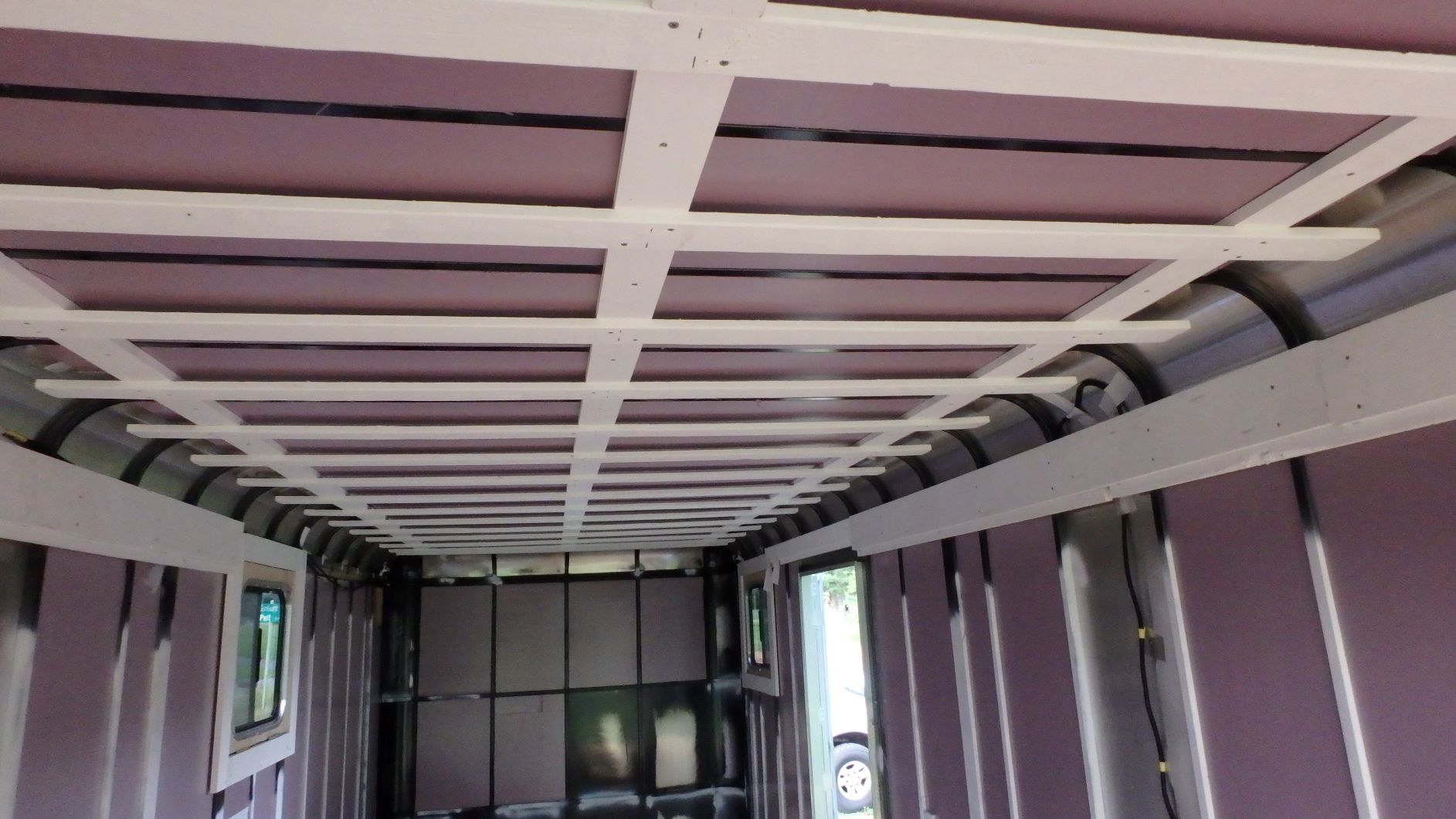

i am doing a two layer approach for insulation. 1/2" foamboard on the walls and 1" foamboard on the ceiling. then closed cell spray foam insulation < 1.5" on walls and ceiling and 2.5" underneath the trailer floor.> side note- they are here spray foaming today- which is why i have the time to finally post updates...haha :D
i read a lot on ways to cut to fit the foam board, there were a lot of good ideas. i had nice luck with a kitchen knife - used just to score a line using a drywall t square and then actually cutting the board with a utility knife. ( i bought a pack of 100 blades thinking the board would eat through the blades, but i did the whole job with just 2...)

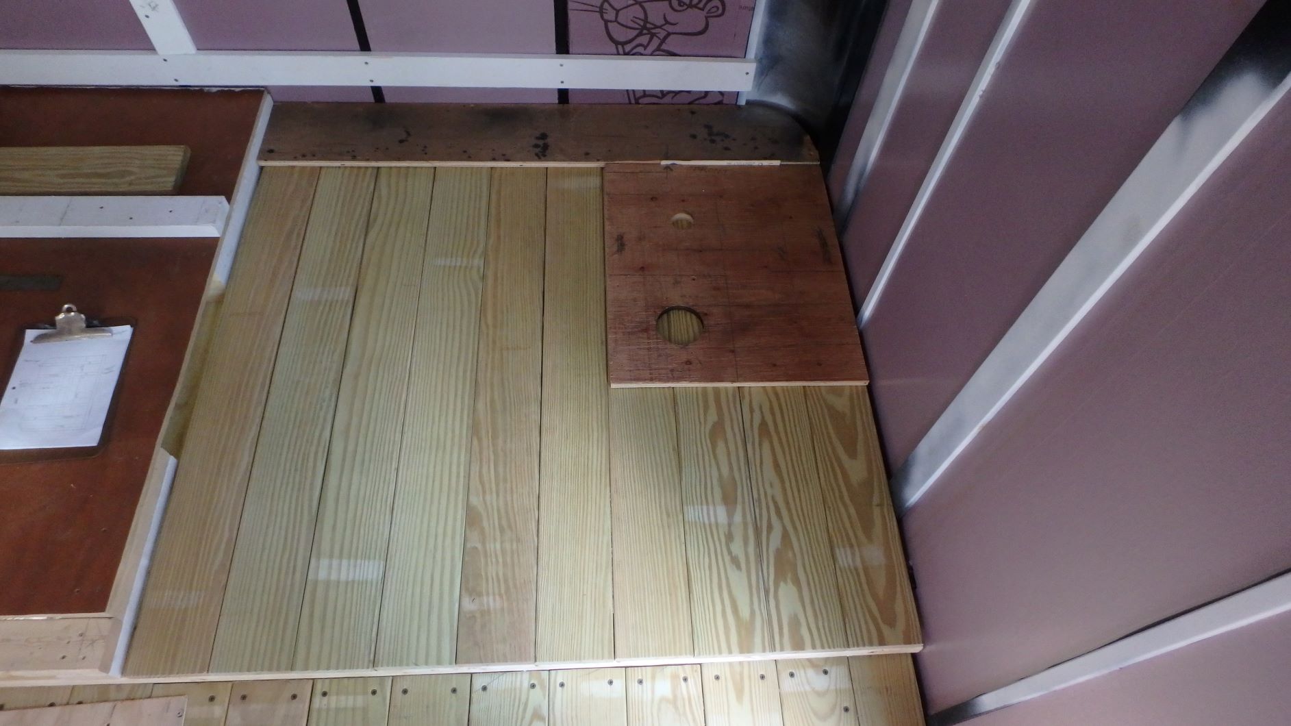

003
P6090077 - Copy.JPG (218.24 KiB) Viewed 3155 times
i had to elevate the bathroom floor to accommodate the threaded rod (1/2") i am using to suspend the black tank, i added additional elevation to the shower to give me room for constructing the p trap underneath.
bathroom area with floor boards temporarily down and my "jig" i made of where the pipes will go

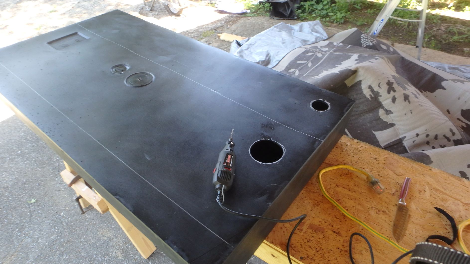

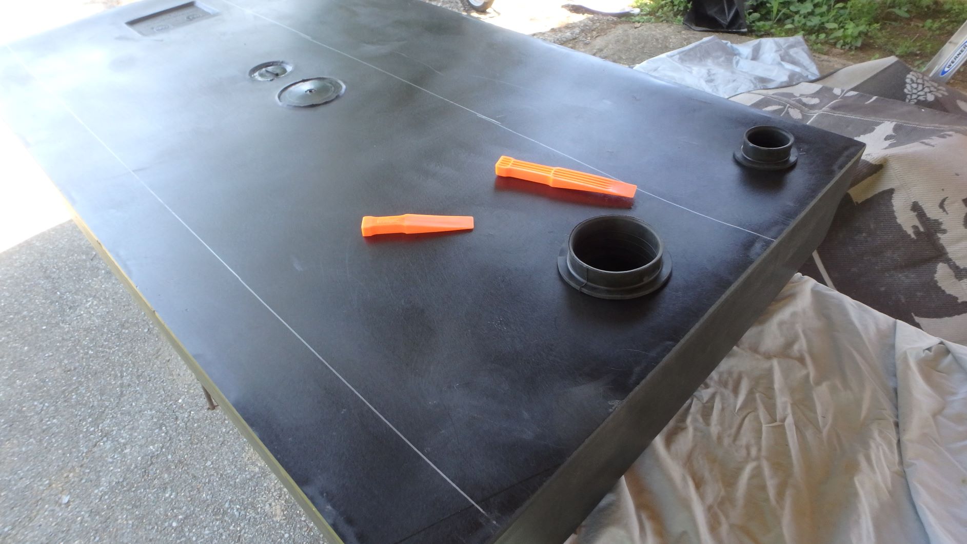

Postby Carolina_coast99 » Thu Jul 09, 2020 8:30 am

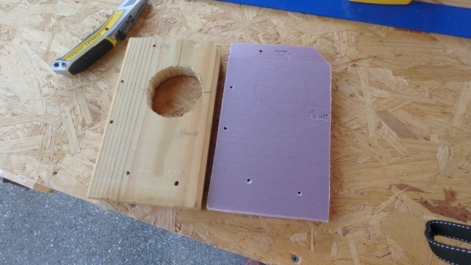

004

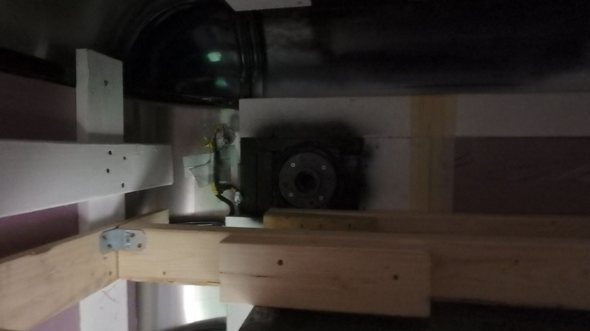

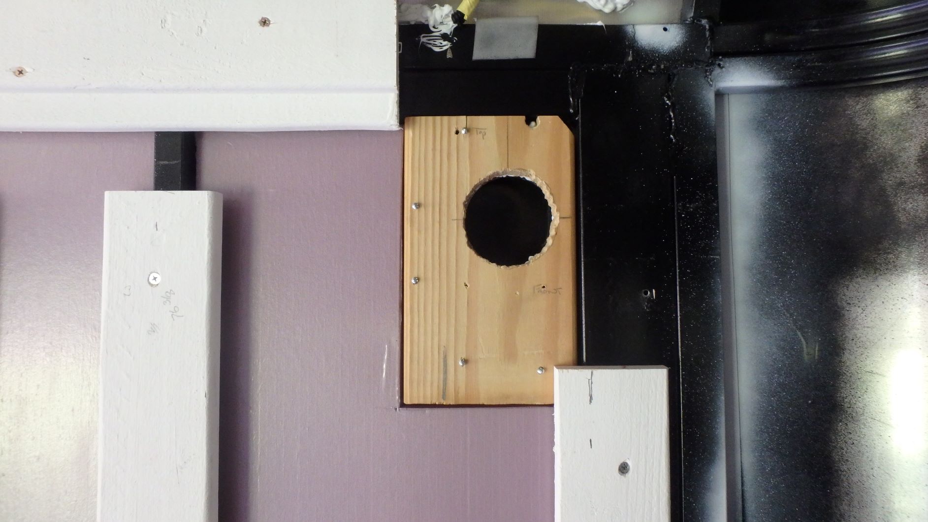

a Dremel tool worked GREAT for cutting out the inlet pipe and vent on black tank :thumbsup:
some trim tools for a vehicle interior worked nicely for the grommet installs
if you recall- i had originally ordered the second vent to be on the rear of the trailer with the first vent- both were to be in the "garage area", but the factory placed it at the front of the CTC. so i decided to use this as my black tank vent. i had to make some modifications

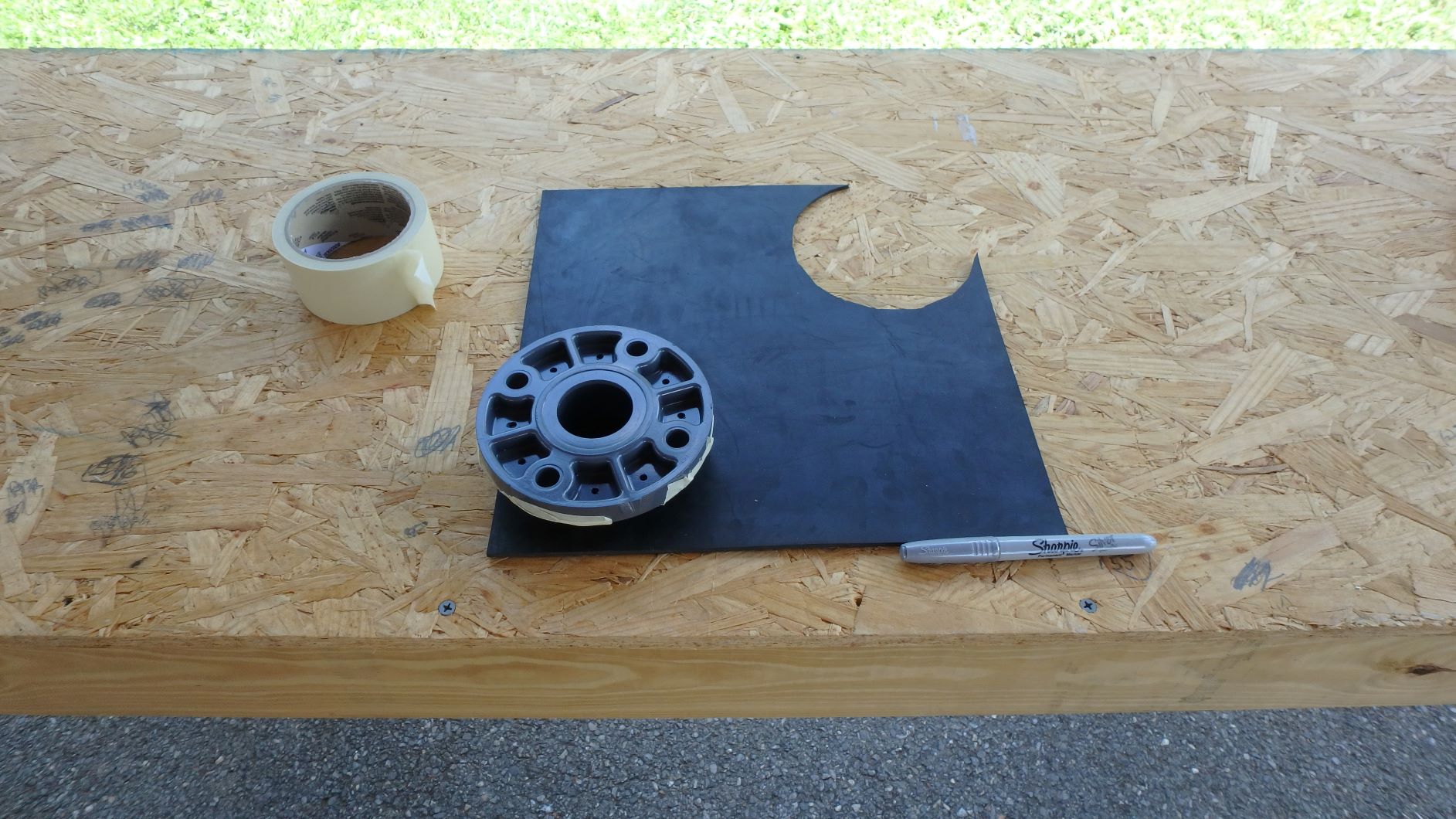

Postby Carolina_coast99 » Thu Jul 09, 2020 8:35 am
005
gasket material and 1.5" pvc flange for black tank vent
vent installed
