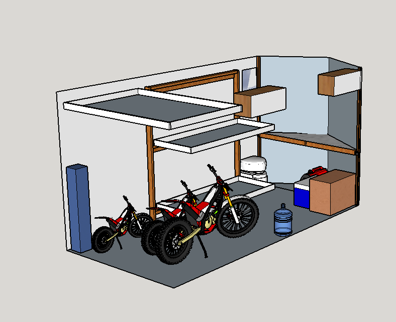

I think a well thought out but minimal cargo conversion could be the ticket, but where to start? I've spent a few hours in Sketchup figuring out what I could do with the given space. There are a few things I know I don't want:

Here's my model so far. It's a work in progress, but helping me wrap my brain around using the space.
Beds down 3-4.png (100.68 KiB) Viewed 1546 times

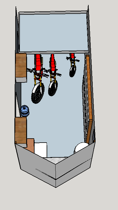

Beds up birdseye.png (50.33 KiB) Viewed 1546 times

If your going to have a trailer custom built, get the rear swing doors and have them also put in the rear roll up bar in the back. You can use it to lift and lower your bed by running cable or preferably nylon straps both straight down and forward to the front edge of the bed. Take the spring off the roll up bar and power it with a gear motor to make it go up and down electrically. Don't waste space with rails on the wall, just let the bed settle fully on supports in all four corners or a single horizontal rail on each wall.
Finally, it would seem that you will have a challenge fitting what you have described in a 7' x 14'. Having camped in a 7 x 14 Step van for many years and visualizing your goals, I dont think I could floor plan that in a 7 x 14, So, I'd immediately opt for a 16' long trailer with V-nose. An 8 wide adds a lot of dimension inside... but it can make driving a little bit more burdensome with a plain old pickup width tow vehicle. You can do a 7' wide and sleep crossways just fine.
6' 6" height might be a bit tight if you need to leave the bikes in AND sleep above them, but that is something you need to address in CAD or good drawings BEFORE you commit to a trailer. Have fun though...
