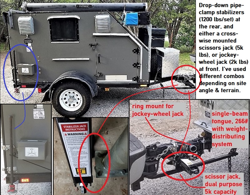

* I hardly ever use my stabilizers (self-built pipe-clamp stabilizers), since:
  • 1) I don't even unhook my truck 90% of the time (because my Weight Distribution spring bar has so much pre-load on it, that it's a bear to get off and back on), and the truck/trailer is so level as towed, then why should I bother?,
  • 2) When I do unhook, I have a scissor jack AND removable tongue jack both mounted in front, so I'll simply lower the front end, drop my two self-regulating pipe-clamp stabilizers to the ground, then lift the tongue until it's level (actually with a 5 degree rearward tilt, for better water run-off),
  • 3) The pads where I camp (state parks) are so level, no adjustment are needed at all.
* Of course, since I camp solo, and don't care if the trailer has a marked tilt to it, leveling isn't a necessary set-up item. I made the pipe-clamp units for near-effortless use. They'll support 1200 lbs easily, so combined with the 2400 lb scissor jack under the tongue (+1000 lbs more, if the detachable tongue jack with jockey wheel was also used), I could lift the whole thing off the ground, if leveling became difficult.

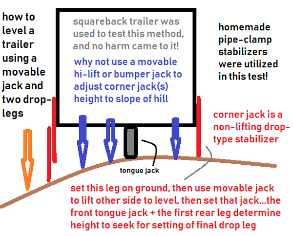

* I've only set-up on uneven ground once, on a day-trip, so I tried using my old Chevelle bumper jack, in conjunction with the aforementioned items, to level it, just to see how difficult it would be. I pulled the trailer onto a hummock, with the scissor jack and the right trailer wheel about level. After releasing the the right side stabilizer to touch solid ground, I adjusted the scissor jack so I got my favored 5 degree tilt; then, using my bumper jack (I could also have used my Hi-Lift), I raised the left rear to just above level, and released it, too. When the bumper jack was removed, the trailer sat level, all around. Personally, I don''t think that it was worth the minimal effort.
