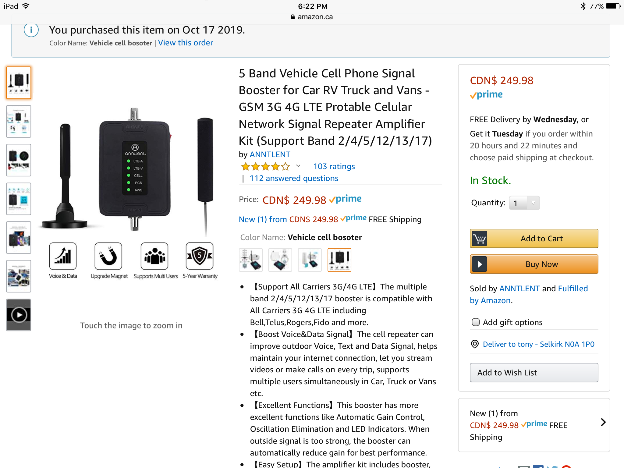

Postby onehoser » Sun Nov 17, 2019 5:47 pm
i just bought one a month ago, it's my third one because the first two were the wrong frequency for my carrier, so i got a five band booster which covers most carriers. i've tested it in my trailer and it worked fine but i live in an area with a strong signal, but i did loan it to my ex who lives in a weak signal area and she said it worked great. this is my first cell booster so i know very little about them otherwise.
