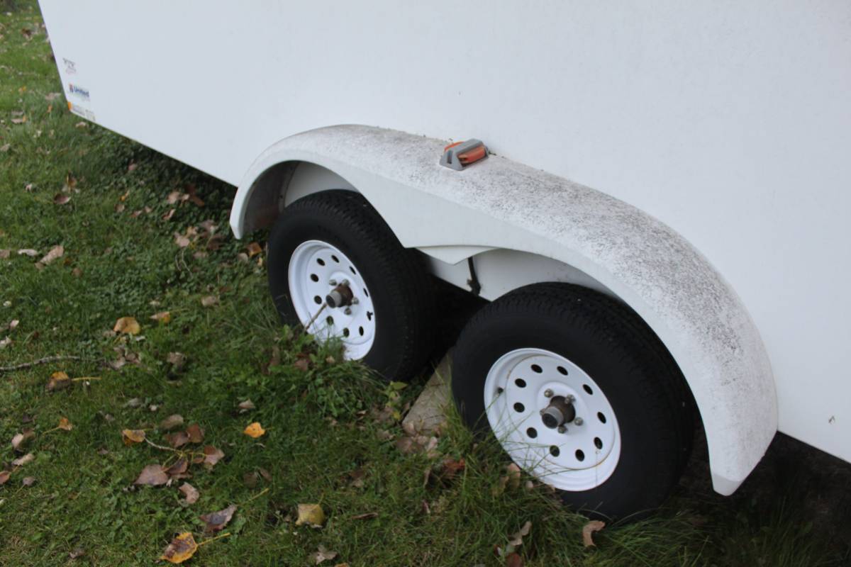

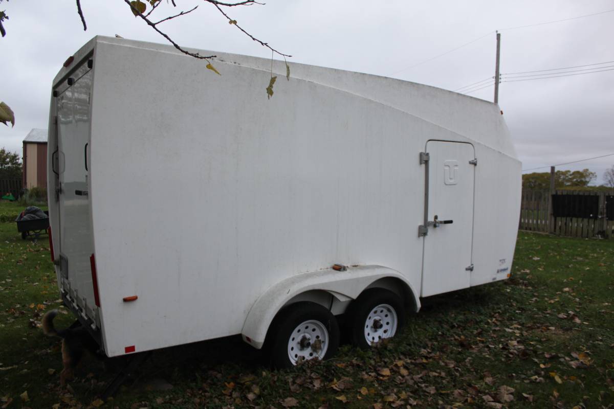

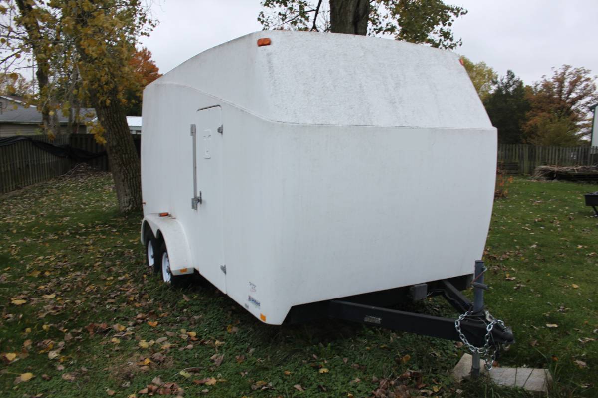

Hello everyone.
Even though I'm still looking for a narrow track 7x16, this fiberglass United trailer caught my eye..
Has anyone ever seen one up close? I like how it would be resistant to leaking, but I remember when I borrowed a scamp once and took it off road. It had allot of stress cracks in the gel coat after we returned and I would punish this trailer even more.
This trailer was rarely used and sat in owners back yard its entire life..
Thanks!

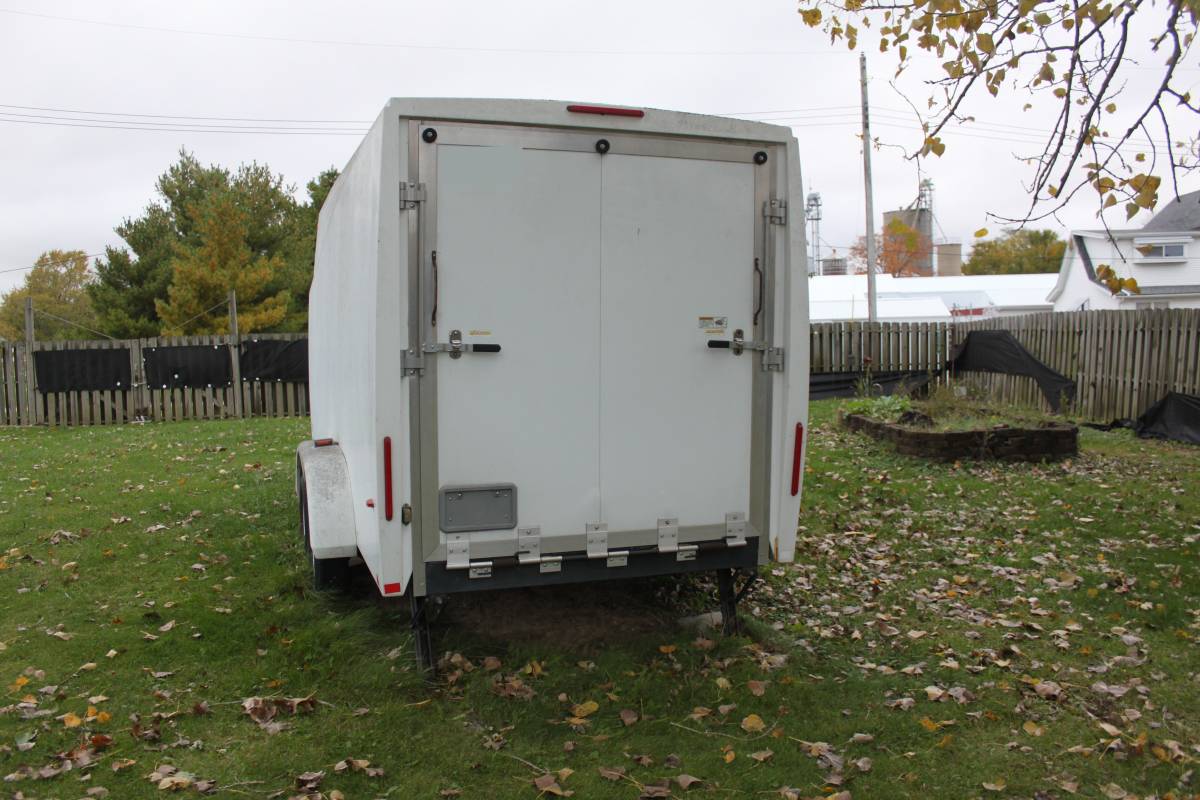

More

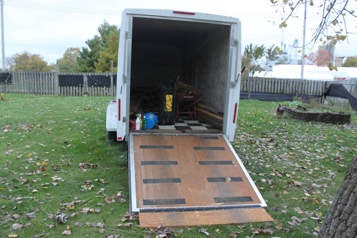

Good questions but unfortunately it's three hours away and the owner hasn't been very forthcoming. Five lugs means 3500# though.. And the wiring is exposed because it looks like there is no wall cavity?
I'm considering converting this trailer into a narrow track with 8 lug hubs/axles on leafs. And new wheel wells..
