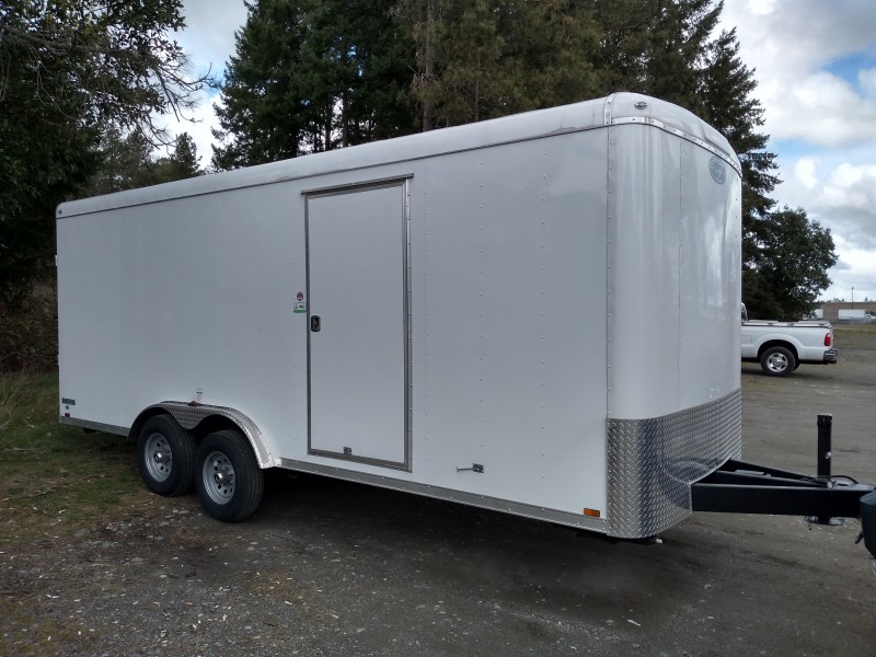

Just received my trailer!!! Very excited. Trailer is 7x20 from Trailer Showroom. (Forest River / Continental Cargo)
Options: 6" extra height, Narrow track 5k straight axles. 16" floors, bogie wheels, 5k front jack,
medium duty ramp door, 2 pairs of 5k scissor jacks (one pair left off, needs to be added. I had them shift the door left.
Build goals: Hope to be able to live full time. KISS principle. Stealth mode, no holes in roof.

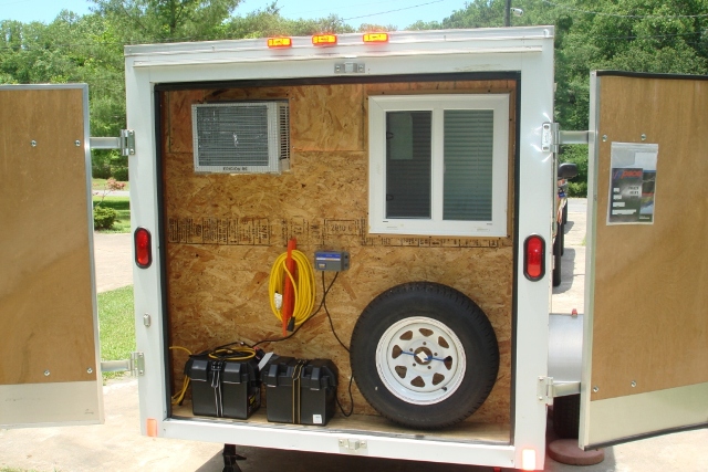

We usually use our 8.6' x 18' cargo trailer about 7 to 8 months on each trip. Windows for us was "must have". With a 2 ft utility room in the back, you can have an a/c in the back wall and put a window and and exhaust fan in the back door. That way you have air flow when sleeping and you have an a/c that is not visible from the outside. Check out our build "ris 8.5x 18 new trailer build 11/1/17". Think a lot about what you want before you start building. Have fun.

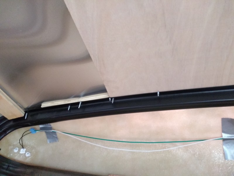

Postby Cookietough » Sat Apr 18, 2020 10:28 am
Back in action, removed most of the wall panels.
Disappointed to see alot of random screws, boards, staples, sticking up.
I think I'll cut pieces to fit, use spray foam where I can't.
The wall frame is the U shaped connections with edges, so I have to squeeze in the foam boards in between.
I'm wondering if it makes sense to spray anything in the central tube. Limited value since the whole U is metal but maybe stop some air movement?

Main questions: What do to do with that gap?
What to do with all the wires? Preserve access? Not looking to rewire?
Planning on doing a 2nd layer of insulation, running 2x4 horizontal on walls, lengthwise roof.
Not quite sure about the floor. Wondering if I can raise it on 2x4s or easier to throw on top of current floor and add another floor.
One is easier and saves time, but costs more - material/weight and loss of inches.

Postby Modstock » Sat Apr 18, 2020 11:09 am
Put the wire's in some plastic conduit and tape them to the nearest support.
On my taillights wires I got rid of the scotch lock connectors and replaced em with butt connectors.
Sent from my H1611 using Tapatalk

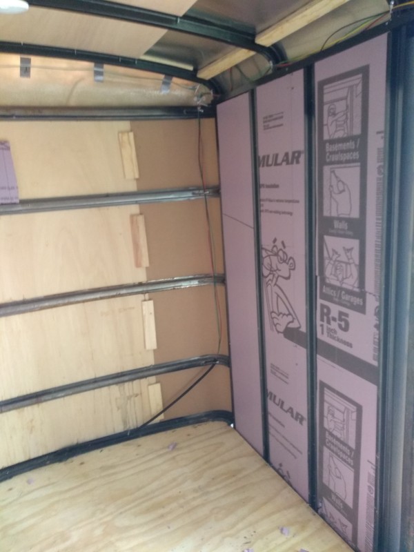

Postby Cookietough » Tue Apr 21, 2020 1:46 pm

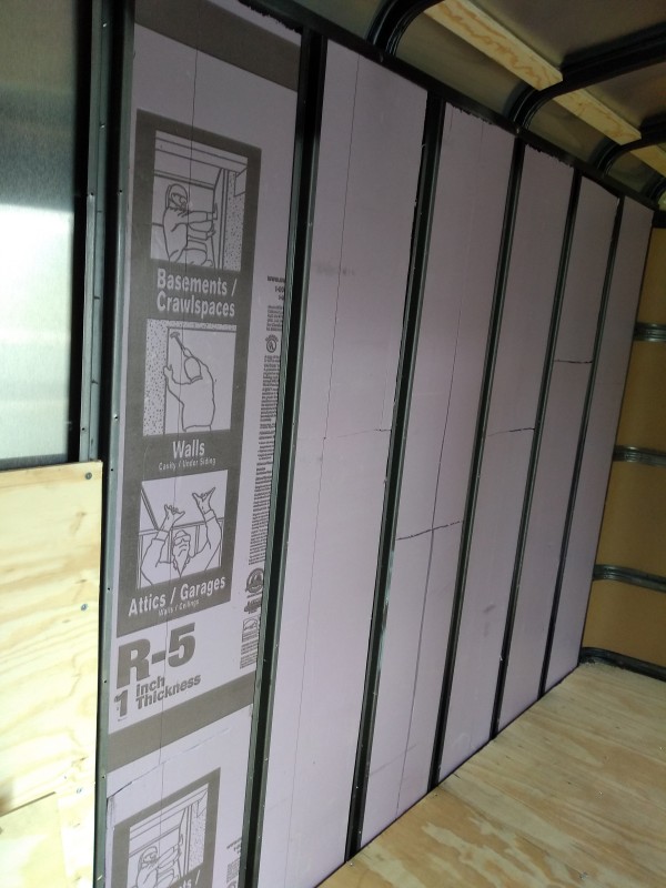

Thanks, everyone. Started insulating walls with 1" pink. Very, very annoying to squeeze them
in between the brackets. Note to self - make sure next trailer is all tube all over.
There are also annoying screws penetrating from the outside that I have to work around,
primarily at the top and bottom. I also have to break the pieces in half to get them in.
I think this is better than cutting narrower pieces which will need more foam.
Finally found a relatively efficient way to cut - using the big L tool, using it as a guide.
Cutting a few feet with razor and repeat with thin putty knife (need to sharpen it)
then slide down a few feet and repeat. Using a piece of scrap as a knee support.
Later I will go back and insert foam & apply tape.

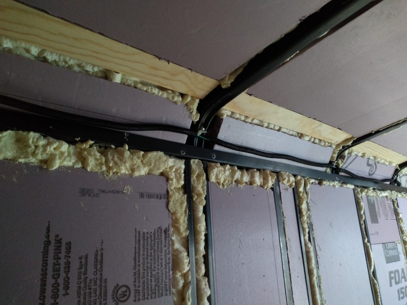

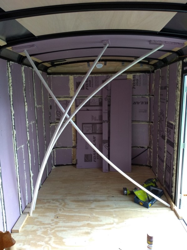

Postby Cookietough » Thu Apr 30, 2020 10:09 pm
Just about done with spraying all the gaps and edges on the walls with "Great Stuff" foam in a can.
I've used about 15 cans so far. If I were doing it over I think I would try this stuff: https://www.lowes.com/pd/DAP-DRAFTSTOP- ... /999986126
Once I saw down the foam pieces that are sticking up, the walls are ready for the next layer.
I want to put 1" on the ceiling next, but I haven't figured out how to remove the 2 LED lights. :(

Postby Cookietough » Fri May 01, 2020 7:18 pm
Removed the LED light. In better light (no pun intended) after the top pops off they just unscrew.
Very easy. Now for the ceiling:

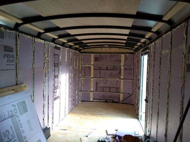

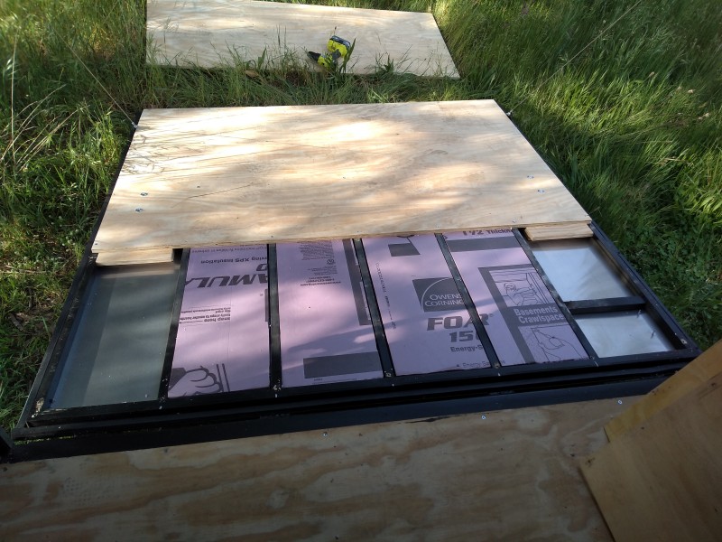

Postby Cookietough » Sun May 10, 2020 10:23 pm
Finished the roof panels and worked on the ramp door.
I was able to slide in 4 long panels all the way, but didn't remove the large bolts to access the rest.
They fit very tightly (1.5" thick), I hope that won't create an issue.
I'm thinking of another layer on top. I recall seeing a build here with with chains to support the ramp as a deck.
Anyone recall which one?

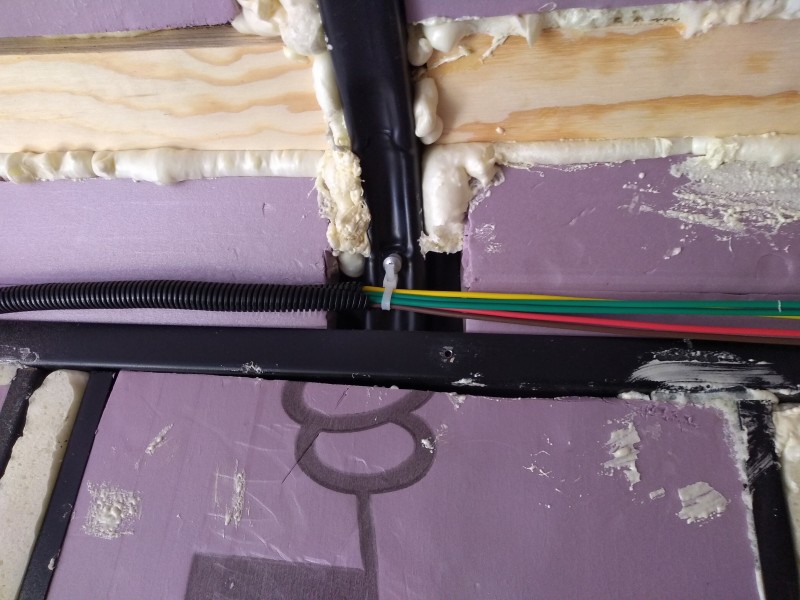

Postby Cookietough » Tue Jun 23, 2020 9:56 am
After several very wet weekends, back to it.
Put pieces of insulation in the corner where wall and ceiling meet. Covered the trailer wires with flex tubing.
