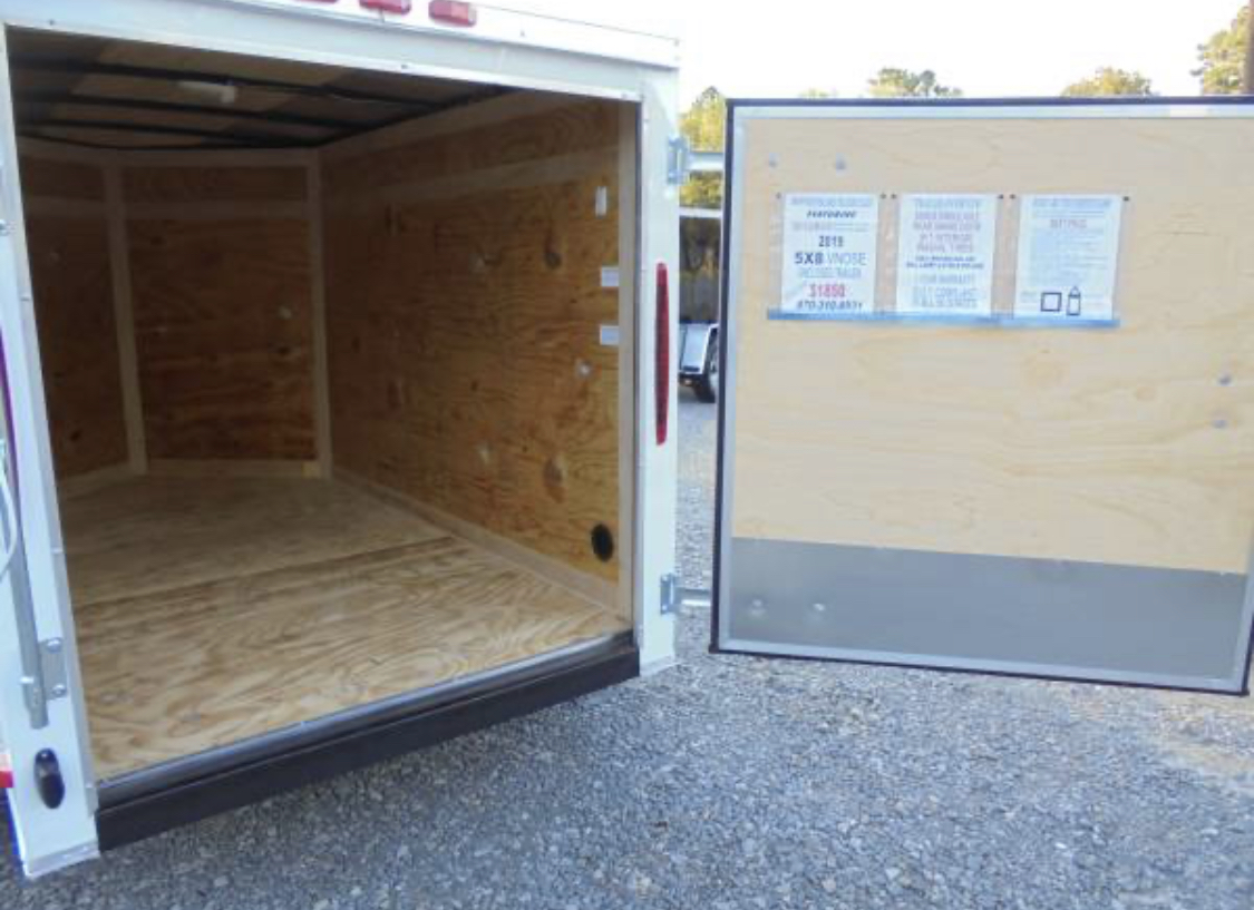

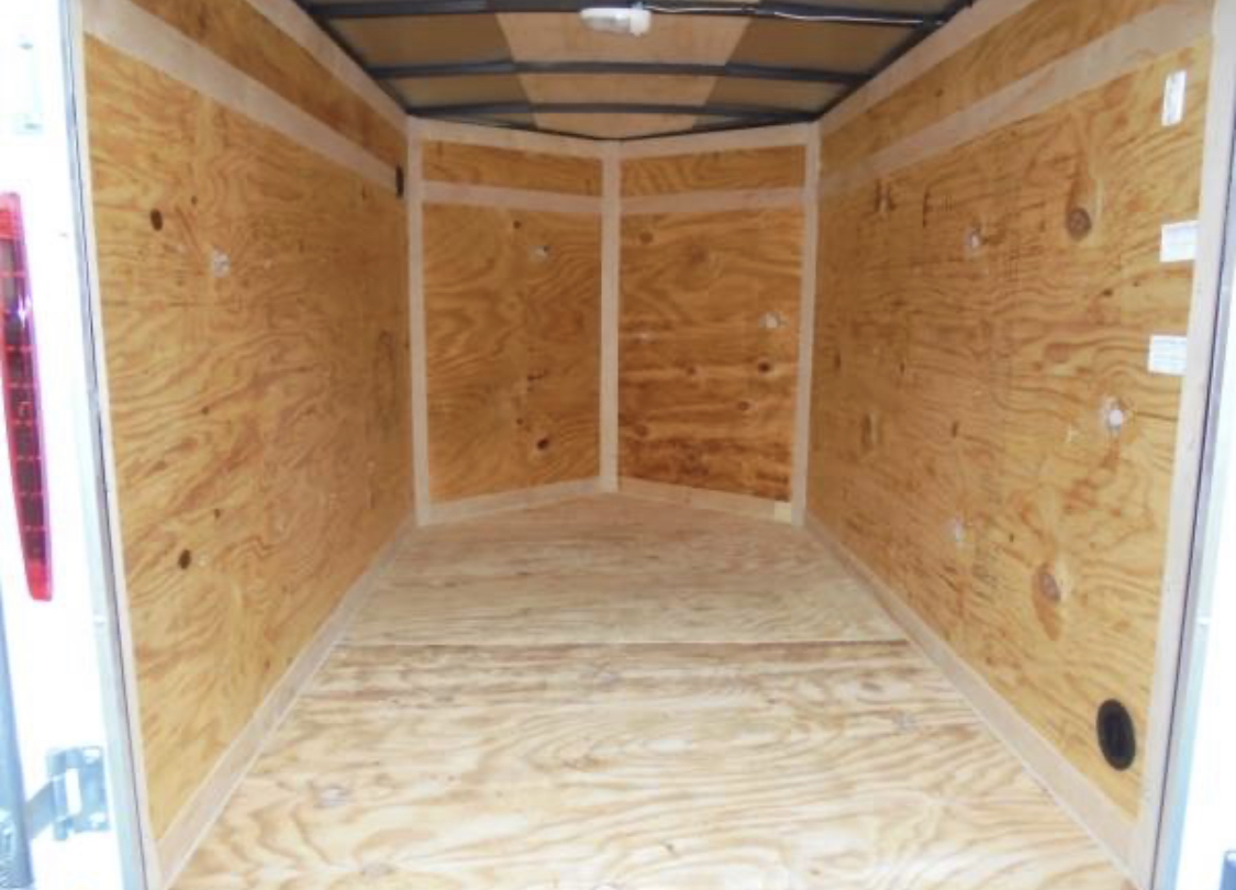

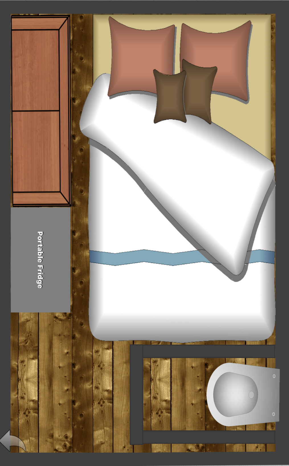

I’m in the process of buying a 5x8 cargo trailer. The walls are plywood not chip board. I’m going to stain/varnish them. I’m going to lay a 5x8 carpet over the floor. I’m getting a futon (sofa 73x34/bed 73x43). I’m getting a “buffet” with sliding doors to go in front of it. 40x13x24”tall. I’m thinking of enclosing a porta potty between the door and the bed. I’m also looking at getting a portable fridge/freezer...the ones that look like coolers. I will be adding a dual hose portable AC in the front V nose vented through the floor. I’ll be building cabinets and shelves around the AC.

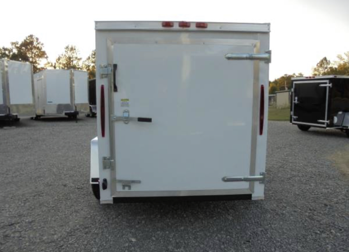

It has a single barn door. I’m looking for ideas how to lock it from inside.
I’m also looking for any other recommendations!
Floor plan/bed open

Back door

Before you pull the trigger. Draw out your plan on your garage floor to get an actual idea of how things will fit to the inside width of the trailer.
I was gonna build a 5x10 but went with a 6x10.
Looks like a great floorplan though.
Its better to have them install the RV latch and looks professional.

Would the RV latch go inside or would it replace the latch on the outside of the door? They come preinstalled with the handle in this picture.
I have layed out the futon and cabinets to make sure they will fit properly.

i would recommend having the manufacturer to install and rv latch. my cargo door trim was glued on, to risky damaging it taking the door apart to install latch and to insulate

this is the screen door type latch i installed, available at any hardware storeImage

That is awesome! Thank you! That’s exactly what I’m going to do!
