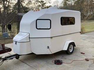

Just about finished with the interior of the conversation.
1994 Chariot 14’ fiberglass duel motorcycle trailer.

Wow! That is a pretty sweet trailer. The only Chariot I had seed before was the single low profile bike hauler. Looks like you have done a great job converting to a camper. If you get a chance, post a pic or two of the outside. What bike do you ride? Lets see pics of that, too.

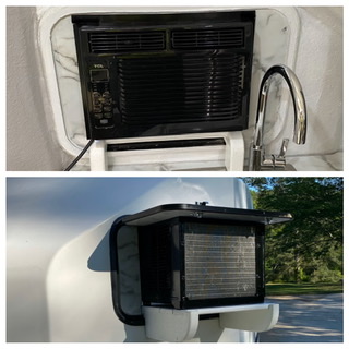

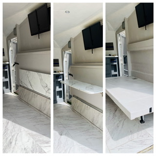

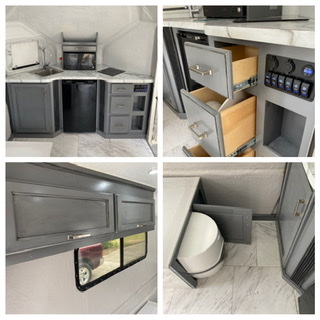

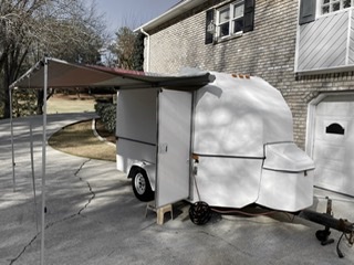

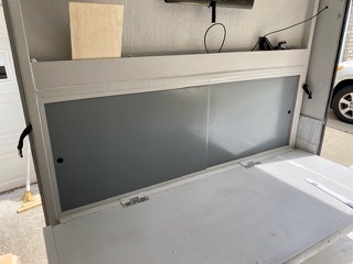

I sold my Gold Wing several,years ago. Got to dangerous to ride, too many people texting. I bought this for two reasons one is because the poor quality of typical travel trailers, my last one was totaled from hitting several potholes on a trip through Jackson MS., and my wife does not like to travel, unless it’s by air. So her brother and I road trip every year. We wanted basic living quarters while on the road. This still allows me to get around 17 mpg in my 2017 Hemi Ram Crew Cab.
Went all electric, induction cook top, 4 gallon water heater, and heat ( I do have a buddy heater if needed) 5K AC window unit when needed will be placed in the wall through the cargo door. Under bed storage for the potty, water tank and pump, plus extra storage for gear. Both beds are 30X75 with 6” memory foam, the mattress for the fold down will serve as a backrest on the stationary bed during the day. Shore power or Honda 2000i generator will provide power along with 120 amp hr deep cycle battery. Adding shelves behind sliding doors on the passenger side wall now. Future plans will be temporary shower using a diverter valve and hose from the kitchen faucet.
I hope to get the upholstery done next week or so. Going to drop the frame to clean and paint it. Install new aluminum five star wheels and tires. Then buff and wax the exterior.
10’ A&E Awning

Your trailer looks awesome! Is the floor actually a marble tile? Looks very high end. :thumbsup: :thumbsup:

flboy wrote:Your trailer looks awesome! Is the floor actually a marble tile? Looks very high end. :thumbsup: :thumbsup:
Thanks, it’s actually peal and stick 18X18 vinyl tiles.
