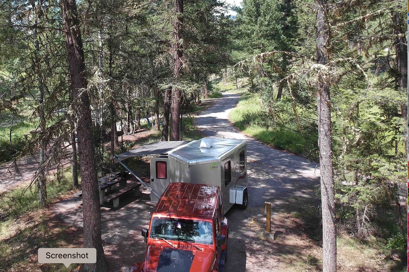

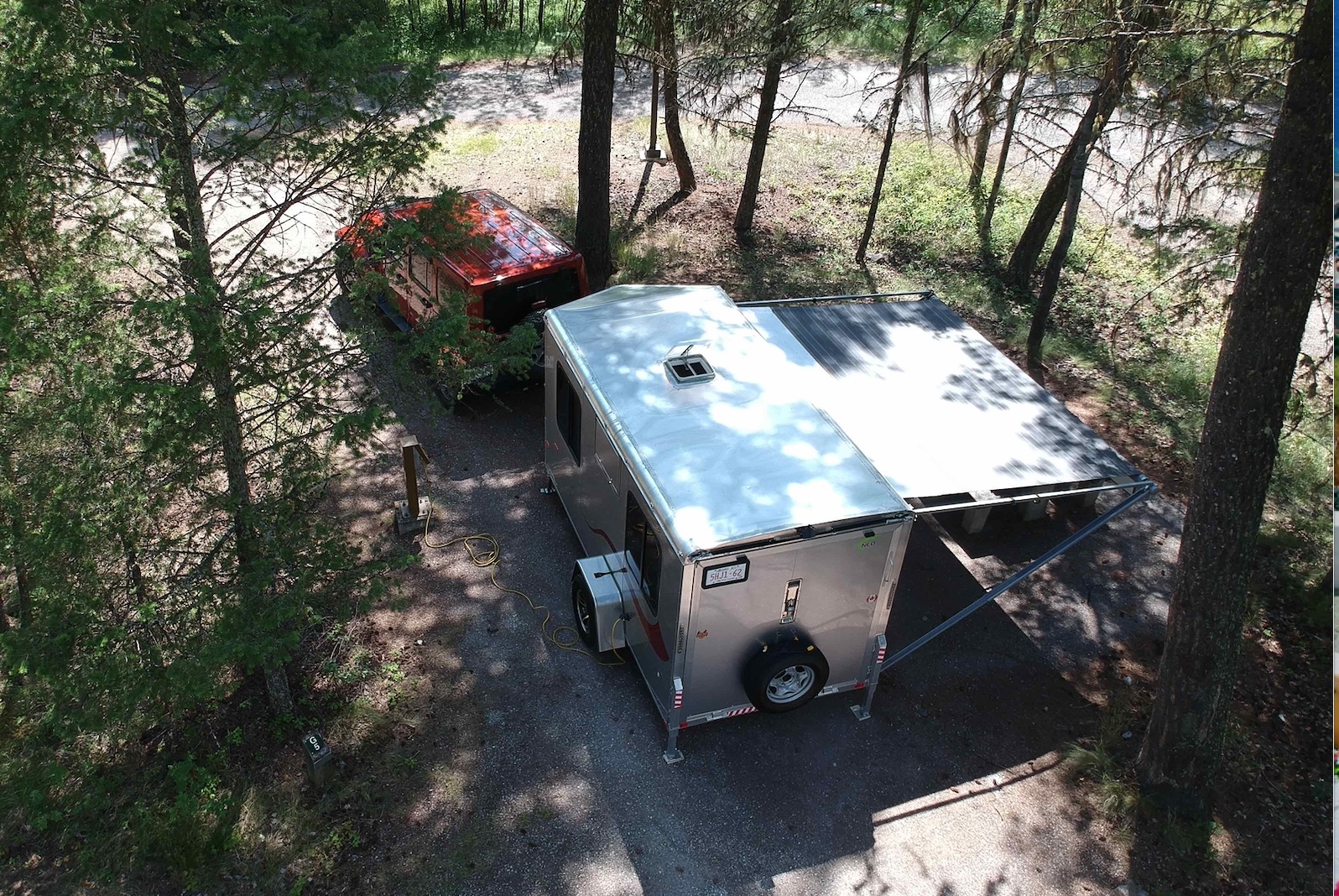

Postby yycwrangler » Wed May 13, 2020 4:35 pm
Screen Shot 2020-05-13 at 16.20.11 copy.jpg (865.59 KiB) Viewed 2887 times
Screen Shot 2020-05-13 at 16.18.38 copy.jpg (789.59 KiB) Viewed 2887 times
Had a 2014 JKU and towed my 6x12 v nose about 30000 total over 4 years. this included Calgary to San Fran, 3 times to Moab and 1 tip to Colorado. I must confess my trailer was an all aluminum weighing in at around 2000lbs when setup. If you do decided, make sure you put airbags on the rear..Makes a huge difference
Cheers
Al
