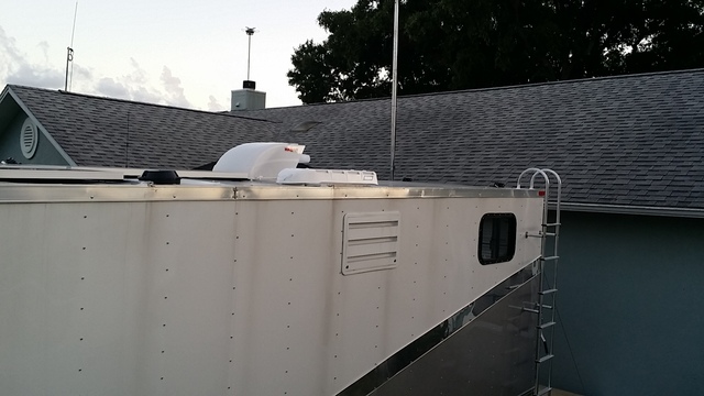

Postby flboy » Fri Jun 26, 2020 12:57 pm
Here's is how I did it.. just another way:
The exhaust is isolated from the intake.
Drain Hose will drain down through the floor. Already draining water tonight.
The sides are sealed up so the air to cool the compressor and condenser is drawn through the vent in the roof.
All in. Just needs to be taped up with foil tape and then paneled when I do the paneling.
The Outside View of the side and roof vents. I used the LP Gas RV Refrigerator Vents which are readily available. T

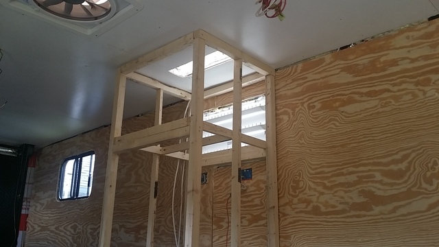

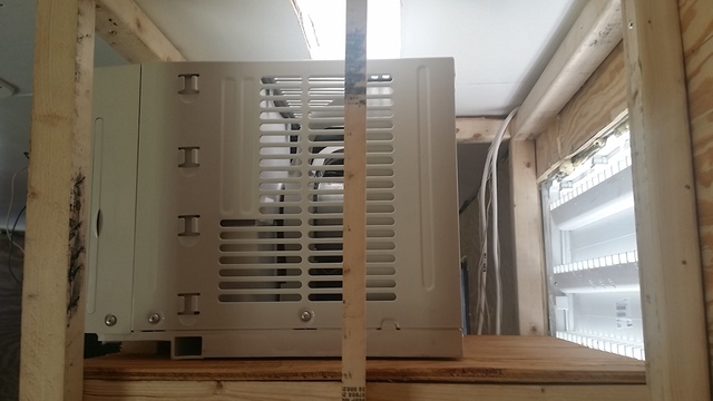

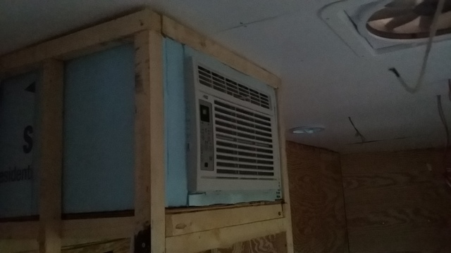

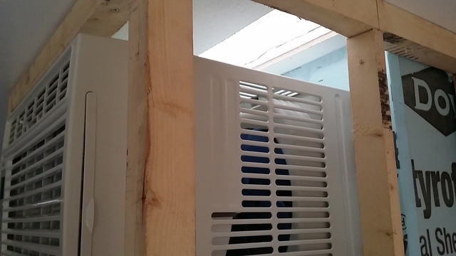

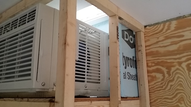

I have completed the construction of the AC test and ran the initial 6 hour test today. Temp in trailer at start was 93 degrees with 48% humidity; west side of trailer in the sun all afternoon. AC is temporarily built into the side door on the east side of trailer which receives sun until early afternoon. Test was from 2 PM to 8 PM. AC used 3.35 KWH, startup was 4.3 amps if I read meter correctly. The interior temperature was 64 degrees 45% humidity at the end of the test. I was impressed with how cold it was in the trailer. I didn't think it would get that cold in such a short time with the trailer in the sun all afternoon.
Don, does this seem like a reasonable test of my venting idea? Grant it, this is only one test. I do plan to run more. I am attaching pictures of my mock set up. It was interesting to build this especially since i was using the side door as my hole in the wall. I have a ramp door so that was out of the question, ha! I can't seem to find the drain hole but there didn't appear to be any water in the floor or under the AC anywhere. The AC is a Frigidaire FFRA0611U1 6000 BTU model. I emailed the factory to ask but haven't heard from them yet.
Harry :D
These first three pictures are my plywood exit/entry door under the AC platform.
162432162434162433
These are the exterior views of the AC in side door. One picture fully enclosed side door and one picture with temporary plywood door removed. The next two pictures are looking inside the intake port hole to the left (fan side) and right (compressor side).
162424162431162430162429
These next four are the frame the AC sits on and the ductwork (upper and lower).
162425162427162426162428

Postby flboy » Wed Jul 08, 2020 6:28 am
Harry, that looks great. I think it is a very reasonable test. I like the way you built up a test case like that. Nice work!

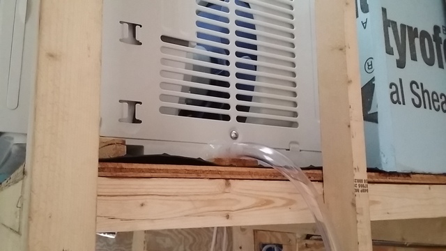

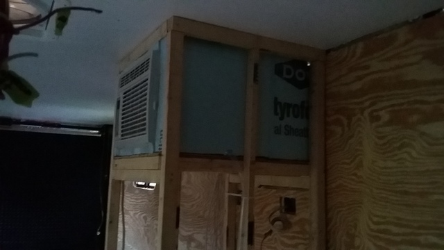

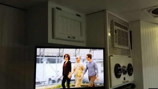

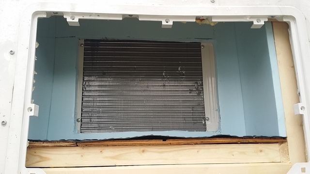

Postby working on it » Wed Jul 08, 2020 10:28 am
flboy wrote:
aggie79 wrote:Regarding the drain hole, there isn’t one. Window units are designed so that the condensate from the evaporator coil collects in a lowered portion of the floor pan just interior to the condenser coil. The condenser fan spins into the pool of condensate and “slings” the condensate onto the condenser coil.
It does this for efficiency, but it can be noisy and there is no control of the water once it gets thrown onto and through the condenser coil.
If you want a drain, you’ll need to drill a hole in the lowered portion of the floor pan. Just be sure to not drill into the coils or refrigerant lines.
Harry, that is the way my AC was also. If you decide to put drain in, be careful as mentioned. I put one in because I did not like the noise and also, being in a high humidity state, the water may not evaporate quick enough to keep up and I do not want leaking in the trailer. Hanging out a window, it would not matter if it overflowed....
* My window A/C unit never drips, which sorta makes me mad because of the effort I put into making a drain pan and outlet for overflow, but I didn't expect it to, anyway. It's an LG 5k unit, and since I already had experience using an 8k btu LG A/C in my wife's old home office, I knew that there would likely be little overflow, if any. But, I did drill a 1/4" drain hole just to be safe, even though my LG 5012J unit didn't require one (as opposed to a similar model LW 5012).
LG model LW5012.JPG (56.92 KiB) Viewed 3528 times
* The way I enclosed the exhaust and routed it out to the right in an insulated duct may explain some of the reason for no excess moisture. The exhaust enclosure retains enough heat to evaporate excess (not being used to cool the coils via the inner fan), but having a high flow inline axial fan in the duct expels the retained heat fast enough to prevent moisture build-up and/or thermal shutdown.http://www.tnttt.com/viewtopic.php?f=21&t=54945&hilit=thermal
* In any case, the A/C system works fine, never drips, and was worth the time invested in it, though the right angle ducting could've been replaced with a box attached to the rear hatch, with exhausting louvers thru it (so it would still function at night with the hatch closed).
  • 103366103367 installed in rear bulkhead
  • 104347 right angle vent boot attached
  • 104348 8" diameter outlet, to be reduced to 6" ducting
  • 104739 drain pan and overflow outlet tube
  • 104740 as completed (at first)
  • 125895 as it is now, years later
173193172890148599
