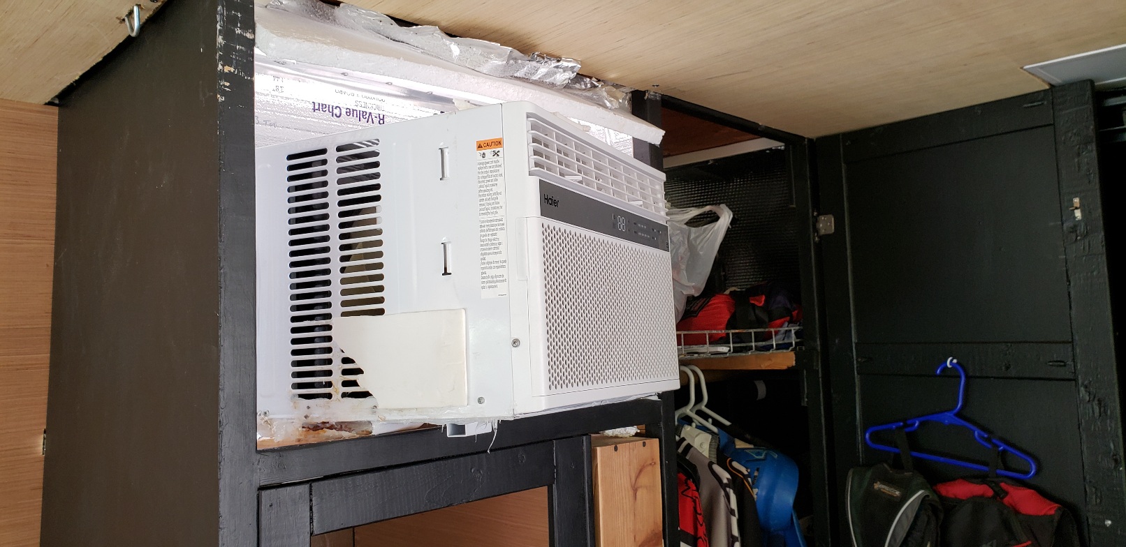

Well this sucks! I spent a ton of time dialing this in so that it was sealed and worked well and hardly got any hours logged before the compressor failed. Now I have to tear it all out and start over. I can't think of a redesign that would make this any easier. Would be great just to slide in and out, but every unit is a different size.

When the compressor would kick on, it would sound restricted then it would shut off. I plugged it Into the garage after I pulled it and it was fine. Put it back in the trailer just to see.....works perfectly. Now I have no idea if I can trust it or not.

Check your wiring to AC... maybe a voltage drop on a bad connection tripping the built in brown out relay (protects compressor from low voltage). AC's on houses will do that often (lights flicker, etc.) when compressor comes on if it is hard starting due to a low voltage (drop on Main breaker or contacts).

Back to the topic: I think Don "hit the nail on the head". Low voltage appears to be the culprit. What gauge wiring did you use to wire the trailer? Are there any other fixtures or appliances running on the same circuit as the A/C unit. How are you providing power to the CT conversion? It is by generator or campground pedestal? If the latter, they are notorious for not providing correct voltage (low voltage).
