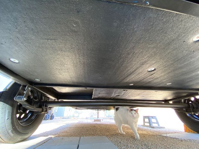

So I've started out by insulating the floor. Built up some panels of 2" foam covered with PMF on the underside and edges and given a good coat of paint. I attached the panels with screws and fender washers. They feel pretty solid, but if they don't work out, then it'll be pretty easy to pull them out and try something else. From the picture below, you can see that I still have one small panel to install over the axel.

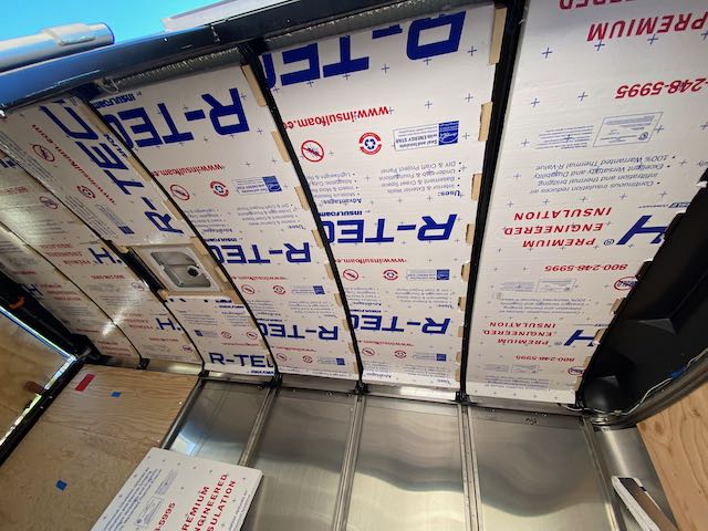

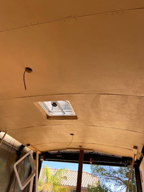

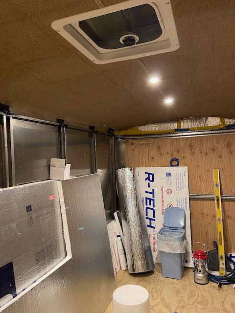

This week I got the ceiling insulated, skinned with luan, then covered with burlap, and the recessed lights installed. The burlap doesn't look too bad, covers the seems of the luan and adds a nice texture to the ceiling. There's a few creases and wrinkles, but, hey.... those are character marks!
1 1/2" foam with a layer of Reflectix slid between the roof skin and the rafters.
Painted luan installed.
The lights are on!

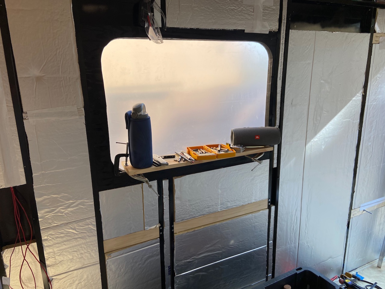

Still working on "foundation" stuff, insulation (and more insulation...), rough wiring, cabinet supports, cutting holes for windows and correcting manufacturer's issues. I'll post a few pics.
The first is a wide shot from the rear ramp. The jacks are holding up the ceiling in the back where there's no roof beams to attach to. Eventually I'll have a couple of cabinets on either side of the trailer supporting the ceiling along with a box built around the rear ramp spring. You may also notice the sagging ceiling treatment (burlap). I tried using spray adhesive, but the glue just doesn't hold in our 'Vegas heat. A friend (who is very competent in this kind of stuff) recommended that I pull the burlap down, roll PVA white glue (like Elmers) on the ceiling, reapply the burlap and then roll the burlap into the glue with a dry roller. I'll let you know how that works. Any suggestions?

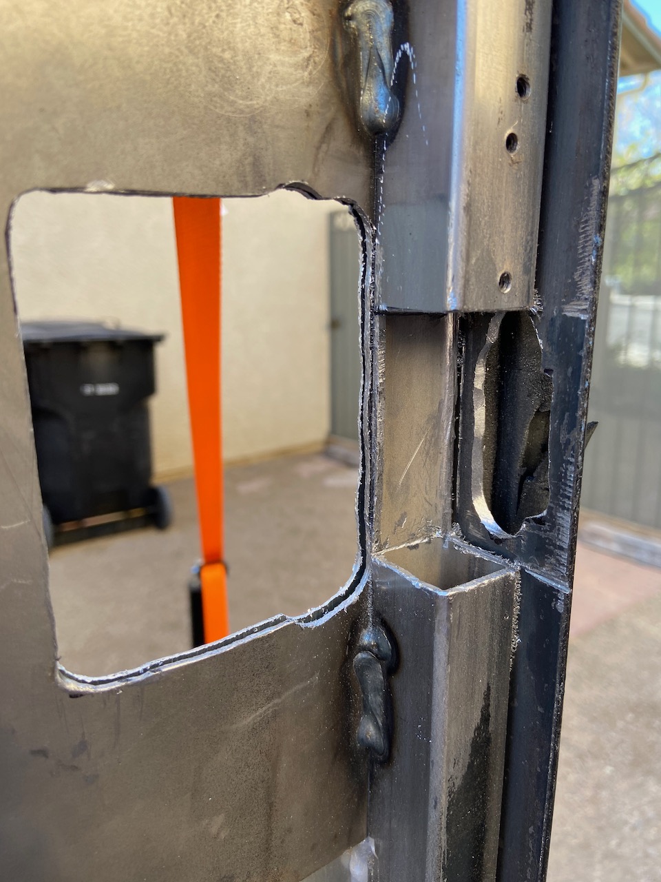

It's interesting to see evidence of the manufacturing process. Like in a couple of places they didn't drill holes for wire passages. Looks like the welder just burned a hole through the steel, then they put a gob of silicone around the wire for protection. So I drilled the holes clean and installed rubber grommets. I closed a few gaps in various places that you don't see until the plywood is removed. Also, they used long metal screws to attach the running lights on the fenders. I guess that's ok until you forget about them and cut your hand on some very sharp screw points while changing a tire. I removed the screws and attached the lights with rivets.
Well, hopefully it won't be too much longer when I can start on the fun stuff. But I think it's going to be a pretty tight cargo conversion when it's all done.

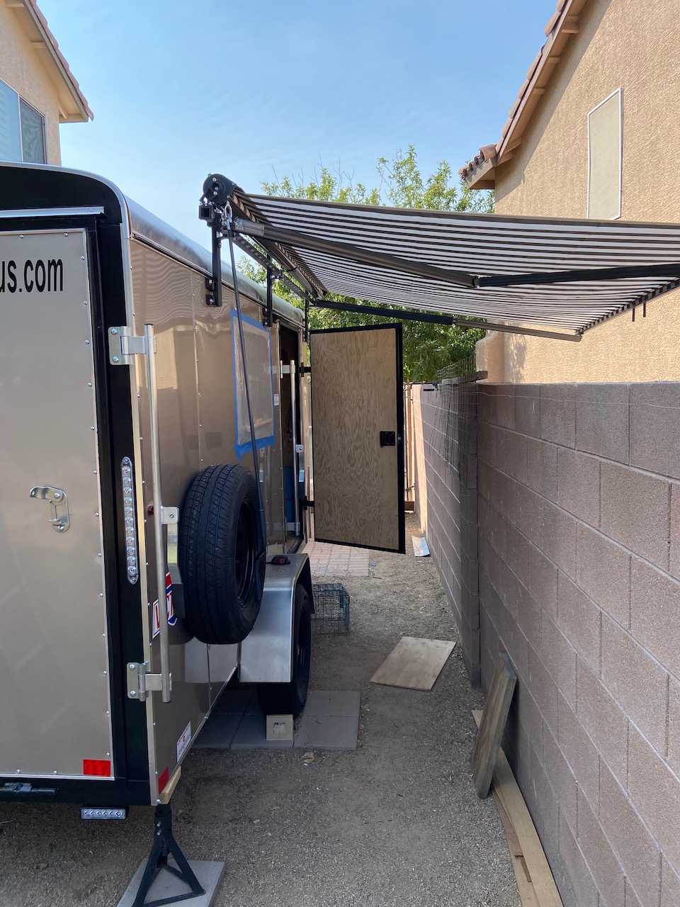

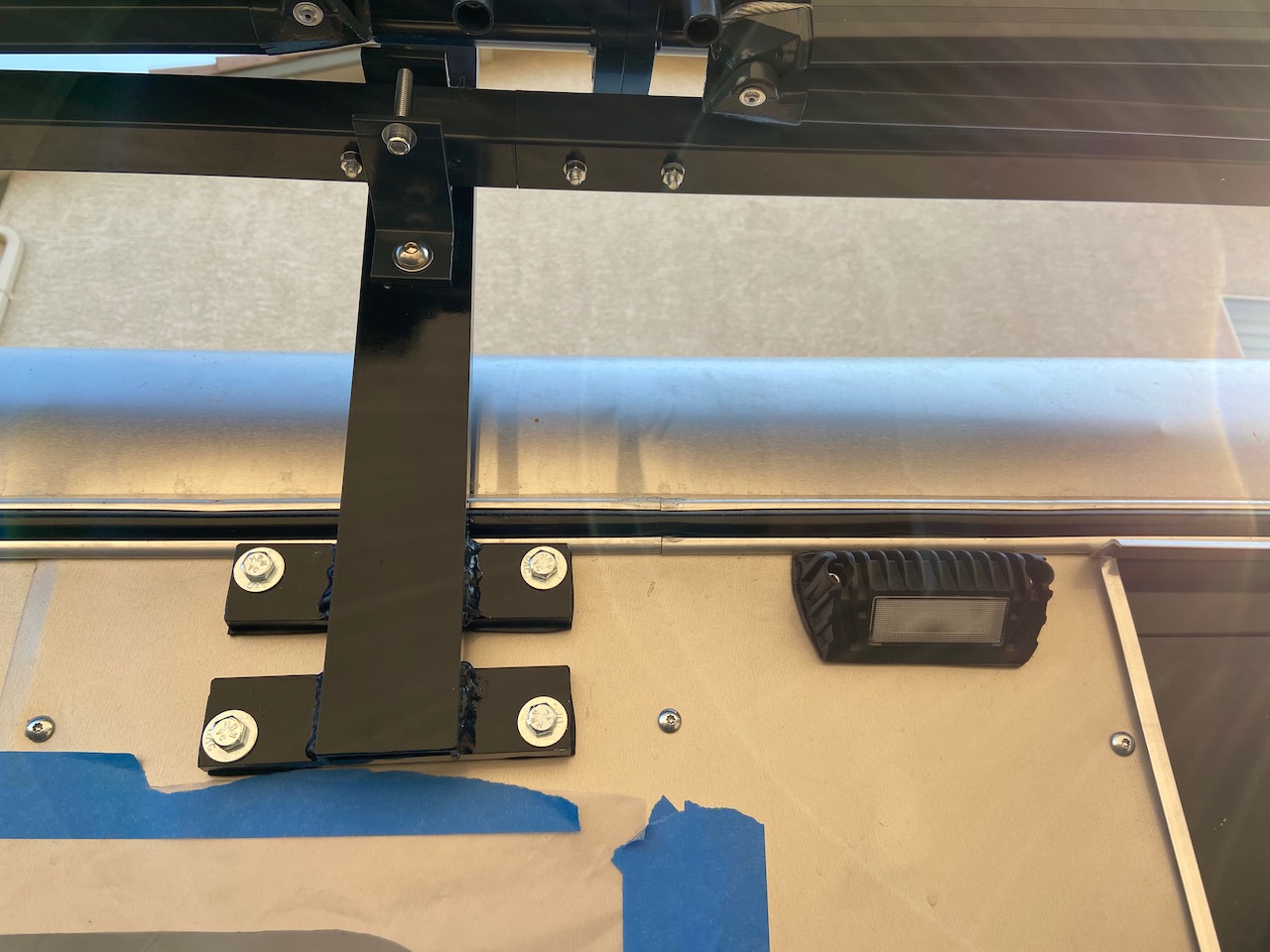

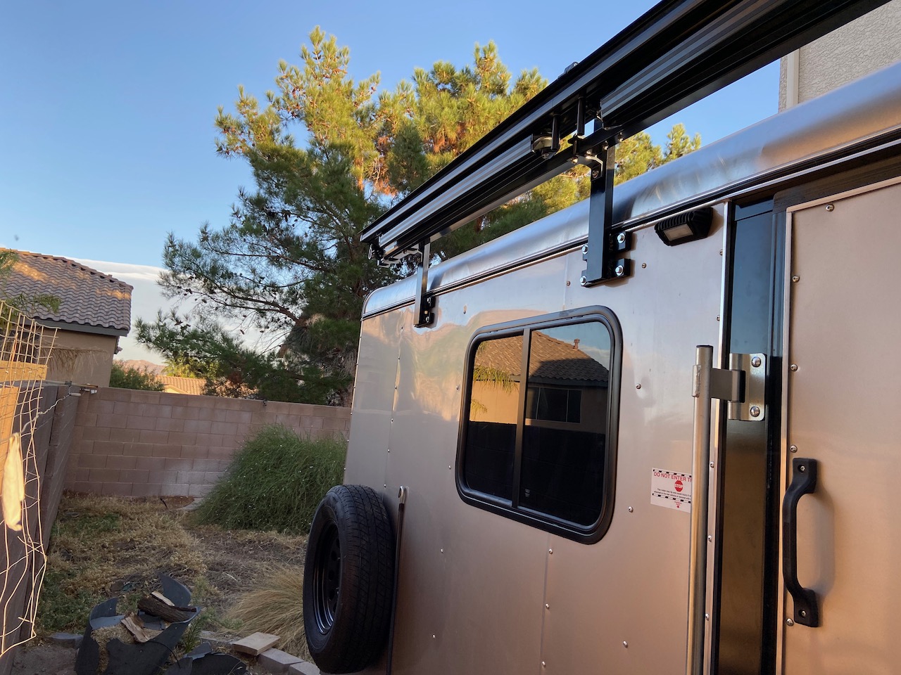

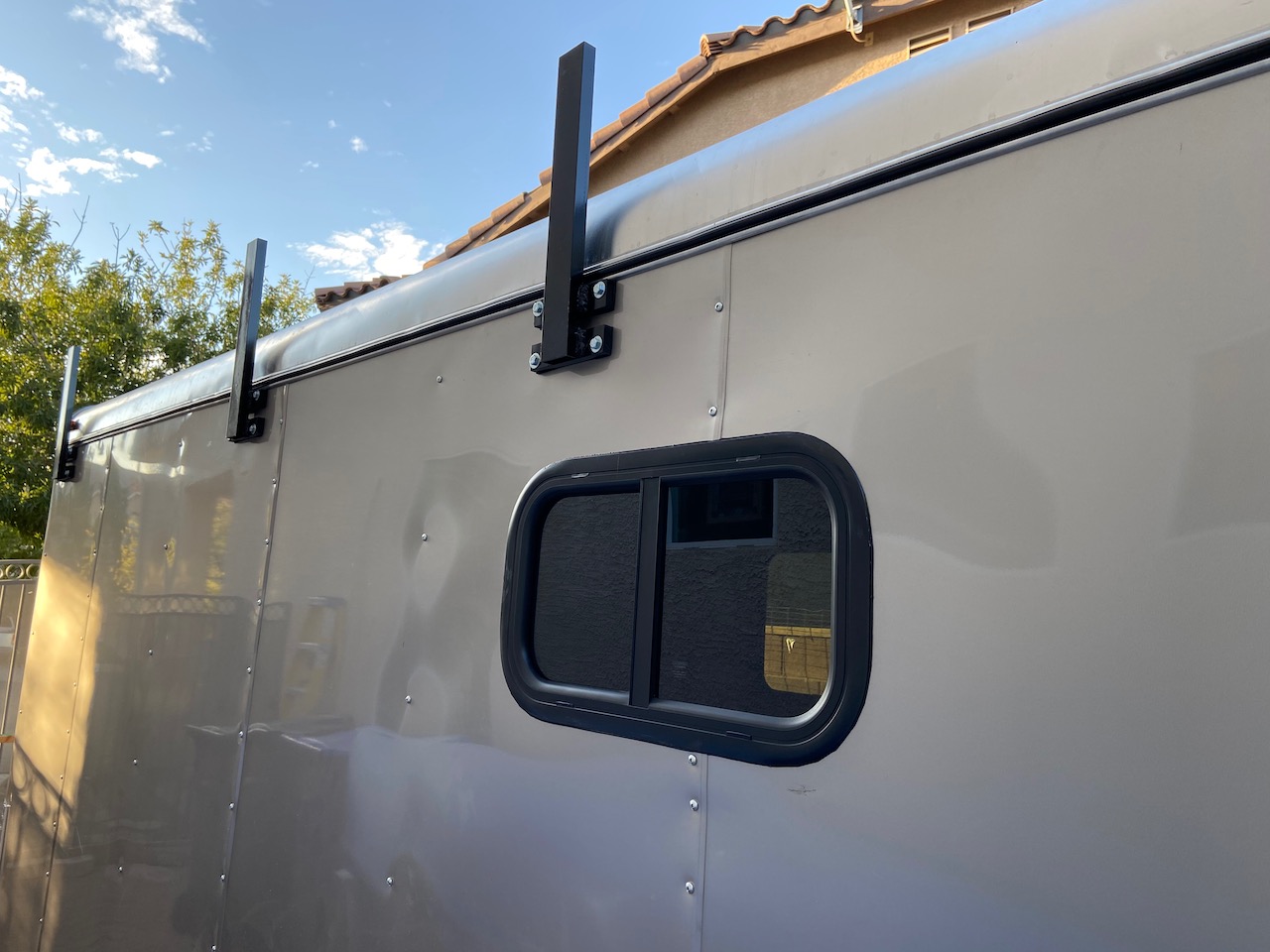

An Aleko 10' awning, hand-crank style.
A friend with welding skills made up these aluminum brackets to support the awning. There's also a set on the driver's side. A cross piece will connect the two sides to support the awning and to, eventually, serve as mounts for solar panels.
Ready to close up the walls with 1/4" pre-finished birch plywood.

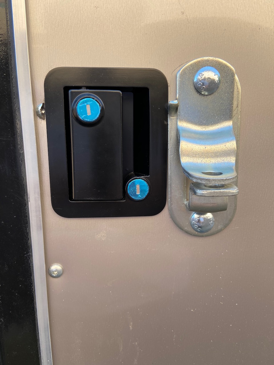

Here's a couple of pics of the added door latch. Super easy.... NOT! Like taking candy from a bulldog, LOL.

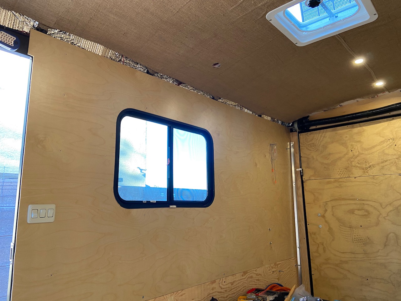

Things are finally rockin'! It's been a month of slow (but steady) progress, now it's getting fun.
The walls are closed up; the windows are installed, and some of the electrical is finished.
Next is some detail work on the inside and building a couple more cabinets.
Be Safe, Be Well.
Fred
I'm liking the pre-finished birch, makes the going a little easier.
The galley window
The big window (well... sorta big.)

The door latch looks like it was quite the project. That is the one thing I ordered "pre-done" on my CTC. I had them install the RV door with Window and latch at the factory. I installed the latch and window in my first CTC and I remember the latch in particular being a pain.
